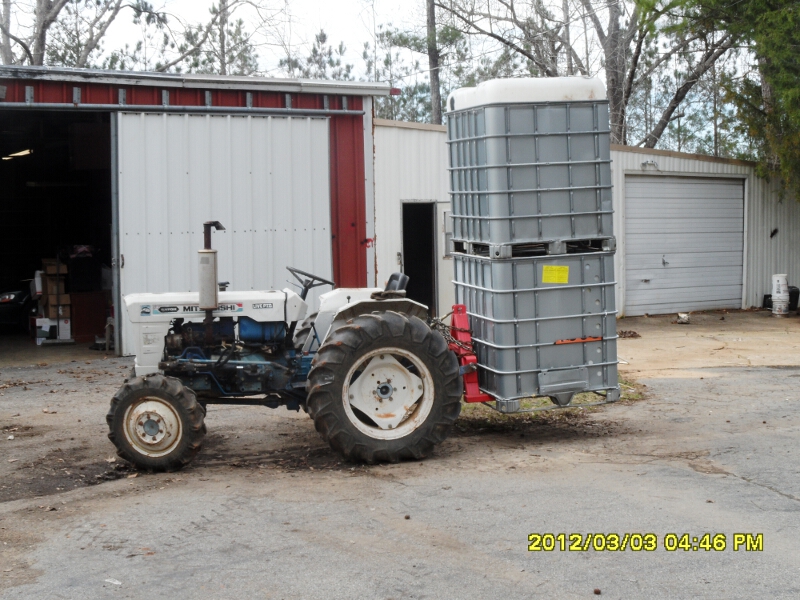

I use pallets with walls on 3 sides or cages from liquid totes to stack and move firewood.

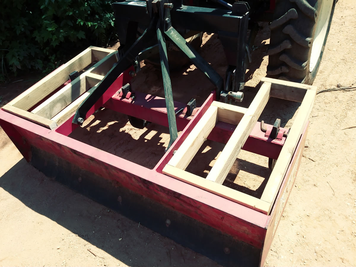

Before I pulled the trigger on either the TSC carry all or a fork attachment, I decided to see what I could do with what I had on hand. Part of this inspiration is because we're in the middle of a house building project, and there's a ton of scrap available to me at the moment. I came up with this carry all deck for my box blade, using nothing more than pallet wood, scrap 2x4 and 2x6 lumber, nails taken from pneumatic strips that house framers seem to discard like cigarette butts (I've probably got 30lbs. of nails picked up from the yard), and half a box of screws. Total cost, after I paint it, should be about $10.
Base is made of 2x4s, fitted to the recesses in the box blade:

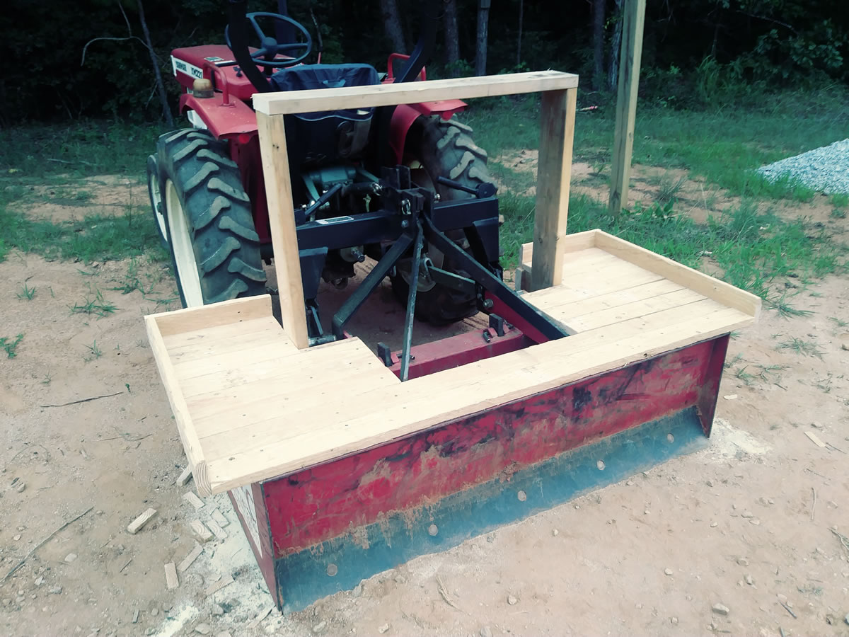

The decking and edge banding are from pallet wood. The fiber cement siding for our new house is delivered on long pallets, about 16 feet long. Lots of long, straight pieces of SYP in those pallets, sturday and very useful once the nails are out. The uprights, which will support a tote box made from pallet wood, are 2x6s.

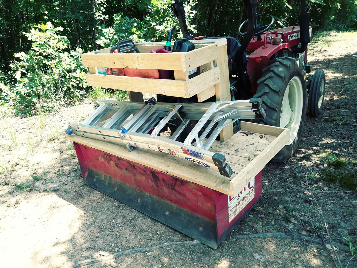

Here's the tote box. It's already loaded up with the tools I used to make the carry all.
And the final product, ready for some limbing work around the homestead.
The carry all is only connected to the box blade by gravity. I ran a few tests to check stability, and found one problem I will have to address: Going downhill, if the tote box is filled with gear, and there is nothing on the deck, the carry all wants to tip forward onto the quick hitch. I'll have to add some type of attachment to prevent that. I also tested it by transporting about 300 lbs. of cut logs. Worked great. Was able to get a satisfying amount of log sections on the platform. They were stable. My steering was a little light with that much weight on the back (5' box blade, platform, logs, tools), so I may add a couple more suitcase weights to my front fender.

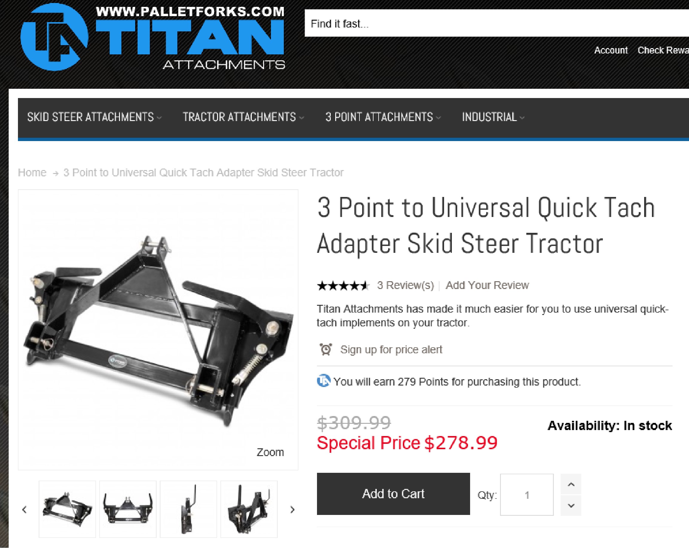

I picked up one of these from Titan and now I can just put my regular quick-attach pallet forks or even a bucket on the back of the tractor. I also have a hydraulic top link which you kinda need to be able to hook things onto this adapter. Note, it didn't fit my cat-1 quick hitch so I modified mine to work.
If you go to the palletforks.com website you can find this quickly by seaching the item number which is 3PTQTA.

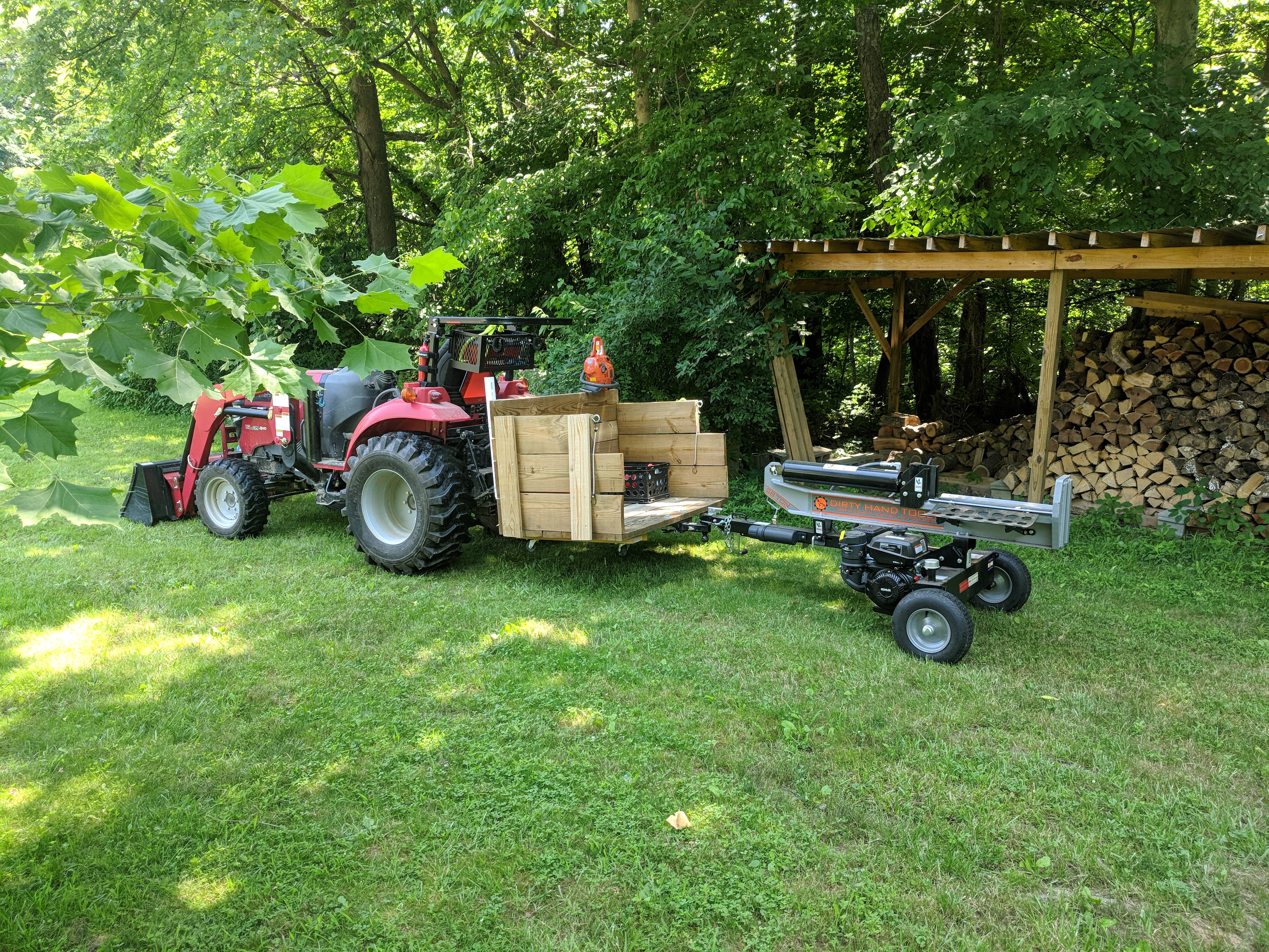

I've shown this pictures on here before but this is what I use when I am deep in my woods. Fill the bucket and carry all with the wood I split. Figure I can carry more after it's split rather than before. IMG_20180616_120523.jpgIMG_20170924_135648 (1).jpgIMG_20170924_135658 (1).jpg
