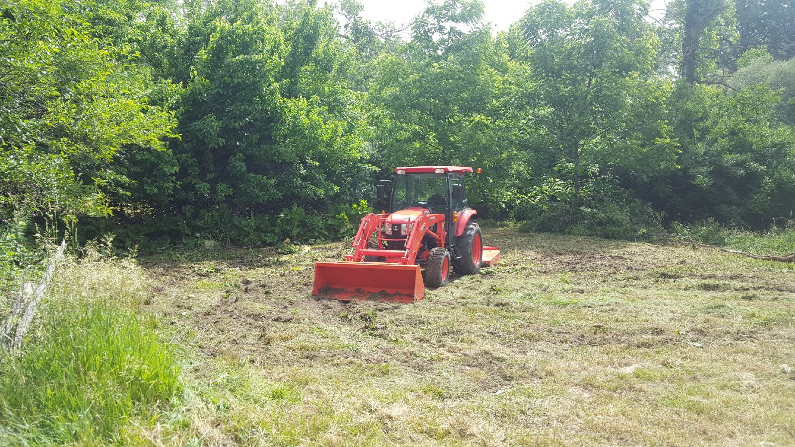

Here are some pictures of the work I have gotten accomplished and today we are heading out to mow, then pull out some trees.
Mowed this area and dug out/pushed over a few small trees

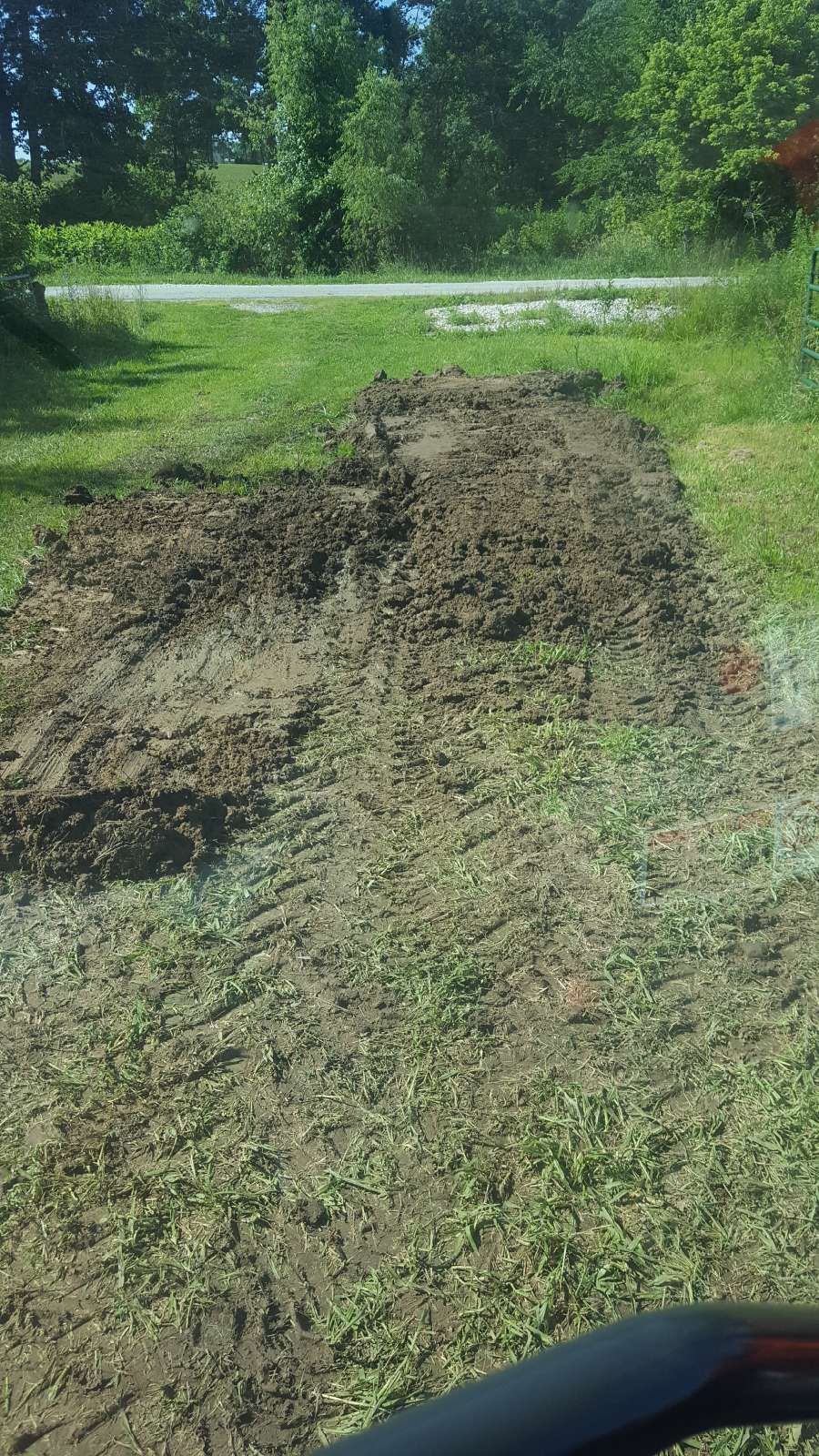

Placed 12 loads of dirt here to fill in a washout that lead to one of the field that gets planted

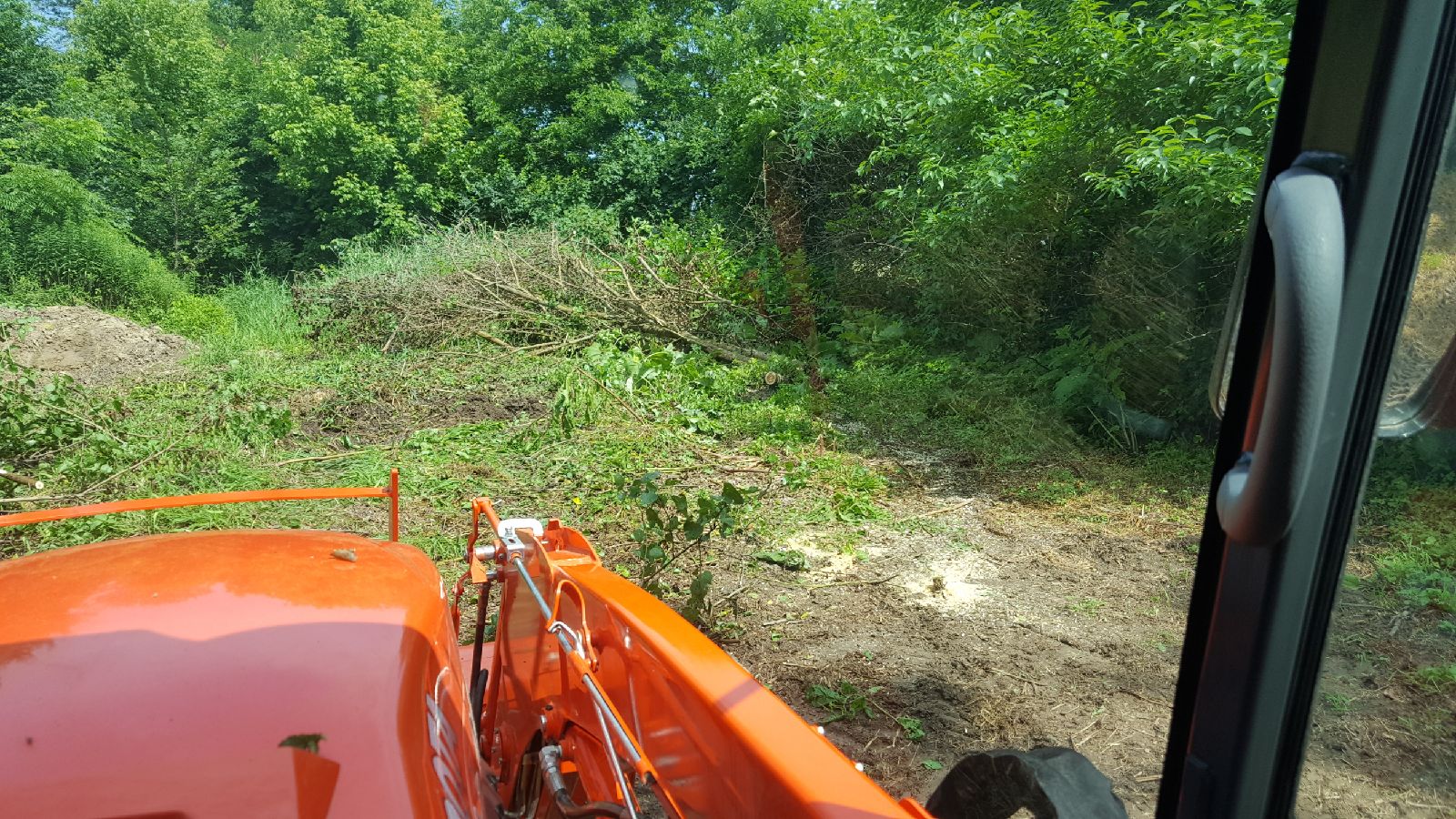

One of the areas clearing, had some small down trees from a storm. Cut two of the larger ones up and pushed these two smaller ones out of the way.
