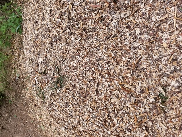

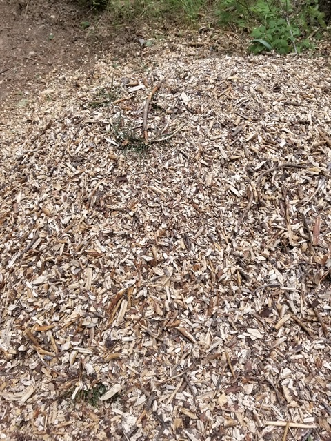

Ya right. I use mine 2-3 days a week for about 4 months. I cause a heck of a lot less air fouling than when I used to burn my piles.
also here in Idaho, they have already closed open burning. But I can chip to my hearts content.
my chipper makes great chips. Only occasional long strands. I line my trails with the chips. Its almost as easy as it was when I burned. Now I can chip right where the wood is located, and don’t have to haul everything out to an open burn area. I can create a large pile of chips in about 1 to 1-1/2 hours. Mind you they are not wood shavings that I can use with the horses, but make great trail beds. Wife uses them in landscape also
the chipper I have now is a Jimna 6 with geared feeder. I sharpened the roller teeth years ago and that has helped. I used to use it on my JD870 which was a 28HP tractor and it worked fine.
i am ordering a Woodmaxx mx88 feeder, but am #275 on the list. Probably won’t see it until December. The Jimna works great, but requires 2 hours and 2 people to,swap out chipper knives and anvil. The Woodmaxx Is a clamshell design for easy knife swapping. I am also looking forward to having adjustable I feed and reverse feed option. I chip up to 6 inch older wood that is past its prime for firewood. Lots of it. And a lot of knarley pine branches. I now have about 20 hours on this new set of knives. Still cutting good. I have a bunch of other knives out being sharpened in Spokane. When I finally get the new chipper, I plan on ordering 4 sets of blades and anvils. Those things arnt cheap, but a sharpen blade sure makes the chore easier.

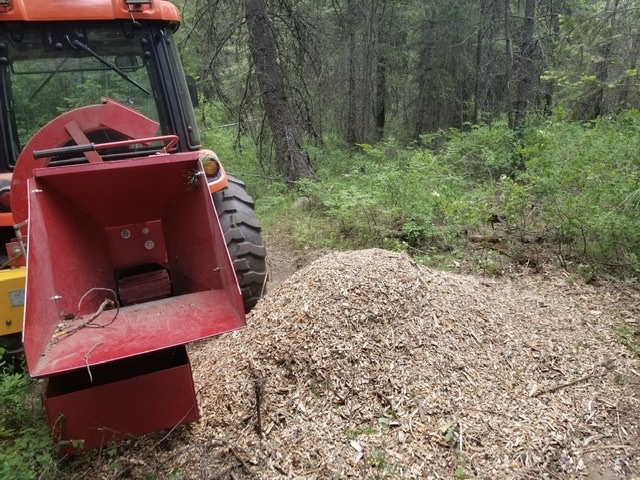

I can buy a mountain of wood chips for the money and time you’ll spend chipping. Even then wood chippers make long stringy chips that aren’t good for much.
No they don’t make long chips, at least mine doesn’t. Only when the blades are dull or the gap between blades and anvil is too large. I don’t use my chips in the stalls, but make great trail bed.

I think that I will be able to use a chipper regularly on the property to keep things under contol. Great results grsthegreat, thanks for sharing the photos
   / Researching best qualitry wood chipper for a Kubota BX23S, suggestions please #49
It’s probably the difference in a wimpy chipper and a big one. The utility company chippers I’ve seen are spitting out 6” long pieces.
   / Researching best qualitry wood chipper for a Kubota BX23S, suggestions please #50
The power company sends around a hired crew every three or four years. They have a really big, self contained chipper. It DOES put out much larger chips than my Wallenstein. Thing is - smaller chipper or larger chipper - it will only handle as big a tree/limb as the workers can manhandle. I've never seen a chipper with a power winch around here.
Cut a regular sized playing card - cut it into eight equal pieces. That's the biggest chip mine will put out.
