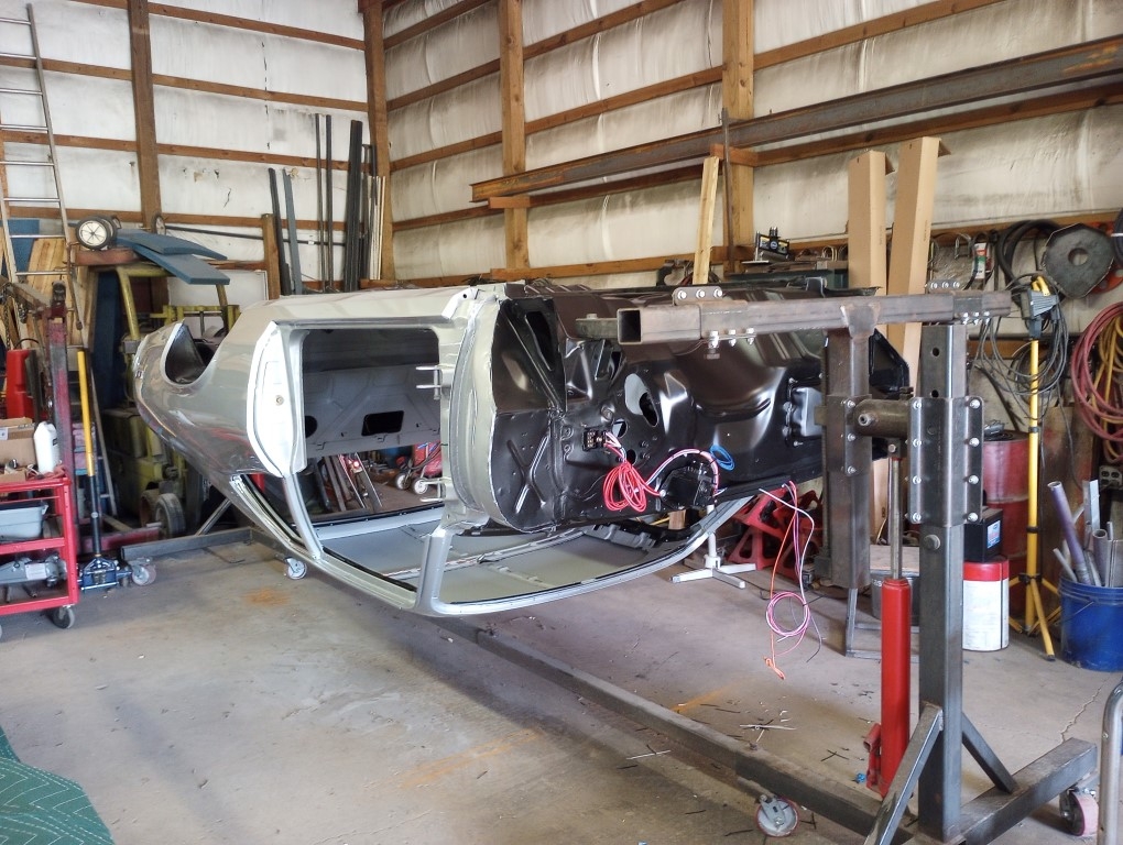

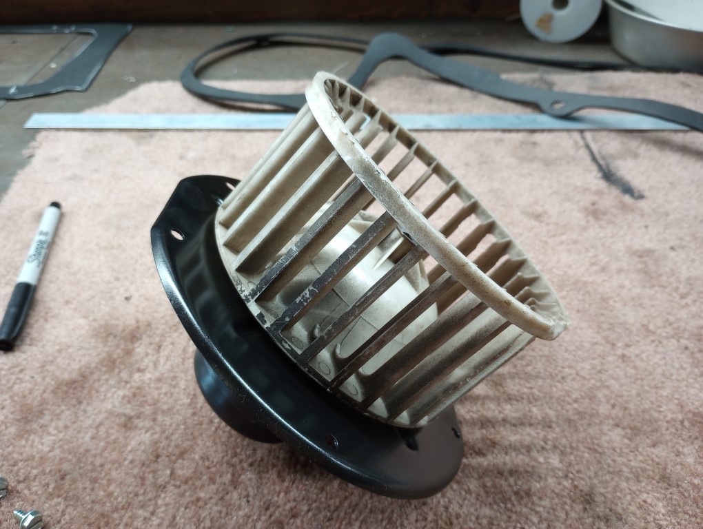

Gave the blower motor another coat of paint, let it dry while I cleaned out the inside of the car, including vacuuming out all the pieces of wire insulation and metal chip from drilling holes. After a neighbor stopped by to drop off his chipper that won't run and shooting the bull for half an hour, I installed the freshly painted blower motor, hooked it up the the battery to make sure it ran and didn't rub on the housing.
Rolled the body upside down, heard a few things roll around in the trunk, I know I lost a couple of connectors back there, and I see I need to readjust the balance as it's pretty top heavy.
Drug out the two boxes of DynaMat sound deadener I bought probably 10 years ago to put on the roof and floor to quiet and insulate the car. I set up a folding table and cut some pieces to put on the roof. I'll work on installing them tomorrow, probably. I may work on the chipper first.
By then it was after 5:00PM and I had to go to a friends house to set up a WiFi network at 6:00PM, and after sweating all afternoon, I needed to clean up and change clothes so I didn't smell like a wet dog.

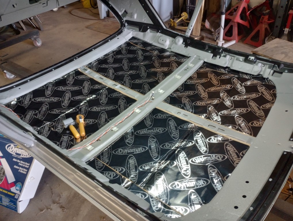

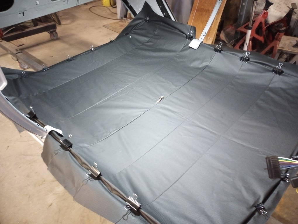

Got all the Dynamat put in the roof this afternoon. I also added a couple of pieces to the underside of the cowl area behind the dash since it was much easier with the car upside down. Then I laid the headliner out and got all the bows snapped into their clips and used paper clips, the type bankers use, to clamp it fast to the perimeter rail and help get it stretched out a little bit before it gets glued into place.

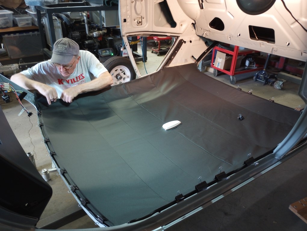

Today, my friend Van came over and we got the headliner installed. It wasn't as bad a job as I thought it would be, it went pretty well. A couple of seams came unsewed, but I think the adhesive we used will hold it together until I get the edging installed. There are a few wrinkles, but as we did on a couple of other headliner installs, some judiciously applied hot air from a heat gun will usually eliminate pretty much all the wrinkles.

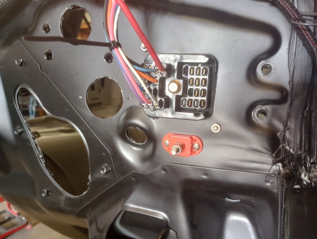

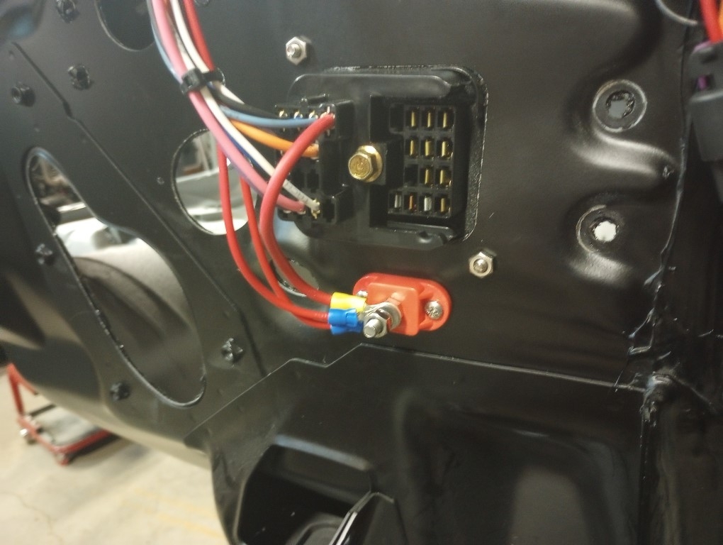

Back to working on the electrical system today. I finally decided where to mount the MSD Street Fire CD ignition system and the MSD Atomic EFI power module. After some shecking, I see that they will fit onto the front of the cowl that sits behind the left front wheel well. I have an MSD 6A CD system, but it's too large to fit in that area, so I bought the Street Fire system that is smaller, has all the features the 6A has, plus a rev limiter, which the 6A doesn't have. Drilled some holes and got the units mounted, and by mounting the Street Fire upside down, the access for adjusting the rev limiter will be accessible with the fender on. Ran the wiring and have it pretty well laid out where it needs to be, except for the switched power wires for the units and the tach signal feed wires. There is an ignition feed coming out of the firewall, and when the cruise control gets installed, there will be three wires running off that feed, so I'm going to add an ATO fuse block so each one is separately fused. I'm waiting on that block to get here from Amazon. The tach feed from the CD system has to be connected to the bulkhead connector to feed the tach in the instrument cluster, the EFI system and the cruise control module, so I'll need some type of junction to connect them.
The EFI and CD systems both have a 14 ga. wire that is to be connected to the positive post on the battery, as is the main feed to the car on the bulkhead connector. After pondering the need to run three and maybe four separate wires all the way to the battery, I decided to put a power point below the bulkhead connector and run one 4 or 6 ga. wire to it from the battery to feed everything. Simpler and fewer wires, makes sense to me.
Along with that thinking, I'm going to run the same size cable from the battery negative post to the subframe, engine and car body. I don't want any grounding problems, those can be a pain to sort out.

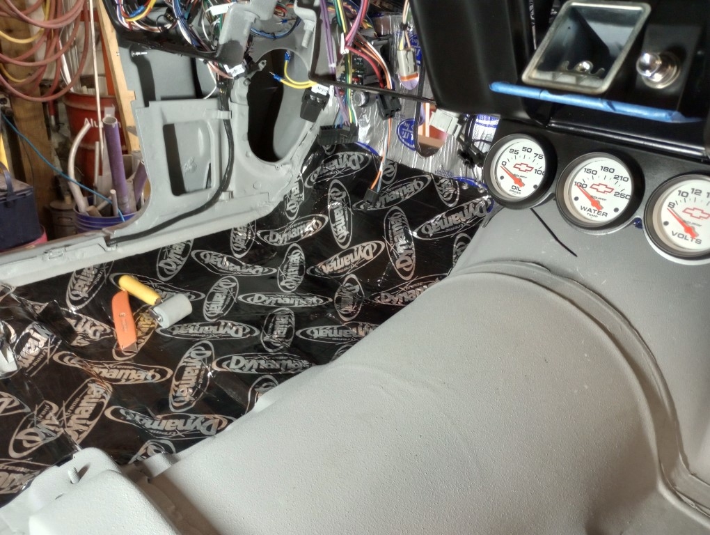

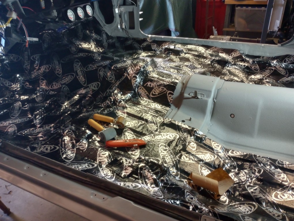

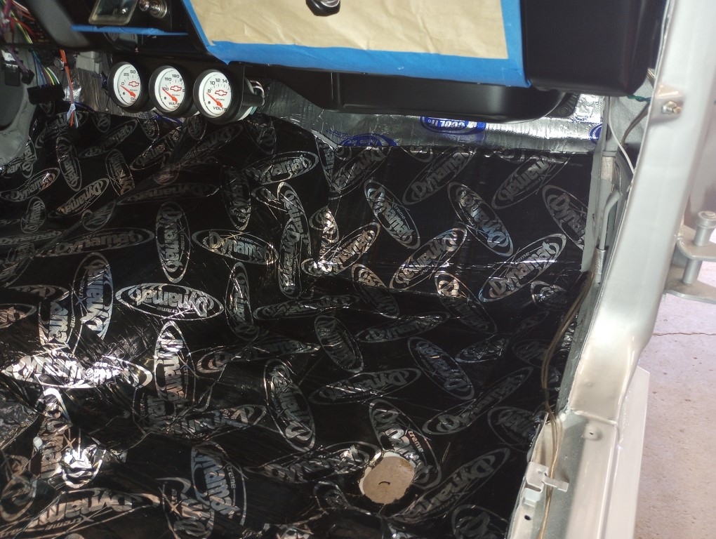

I started installing the sound deadener on the floor. All the irregular pieces, bucket seat mounts, bumps and depressions made it a real challenge, but I just used big pieces where I could and filled in with small pieces where needed. I got about 2/3 of the floor done, but I'm going to do the trunk divider and the wheel houses too. I may try to put some inside the quarters below the quarter windows if it isn't too big of a hassle.
The foil on the material can get sharp as a razor, and you have to watch what you're doing or you'll start leaking red stuff.
