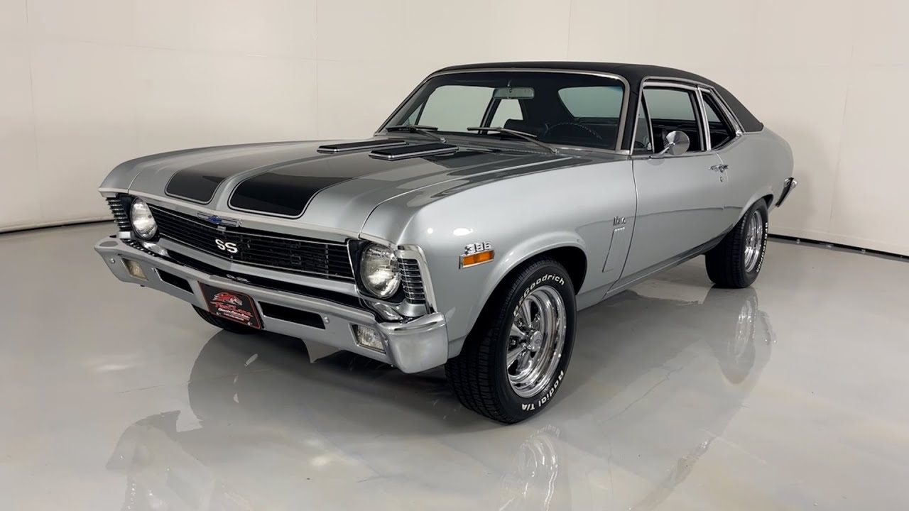

The black vinyl top and stripes will completely change to looks of the car.

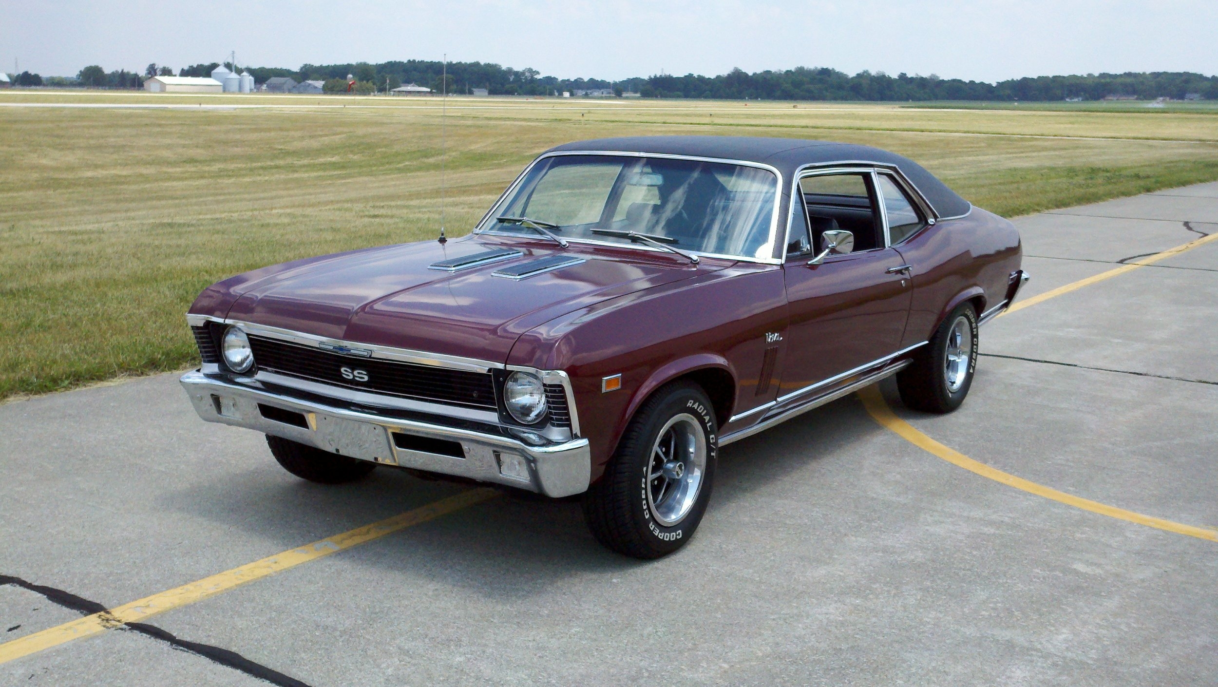

Here's what the car looked like when I bought it.
Here's a Nova with the black top and stripes, but without the side trim.

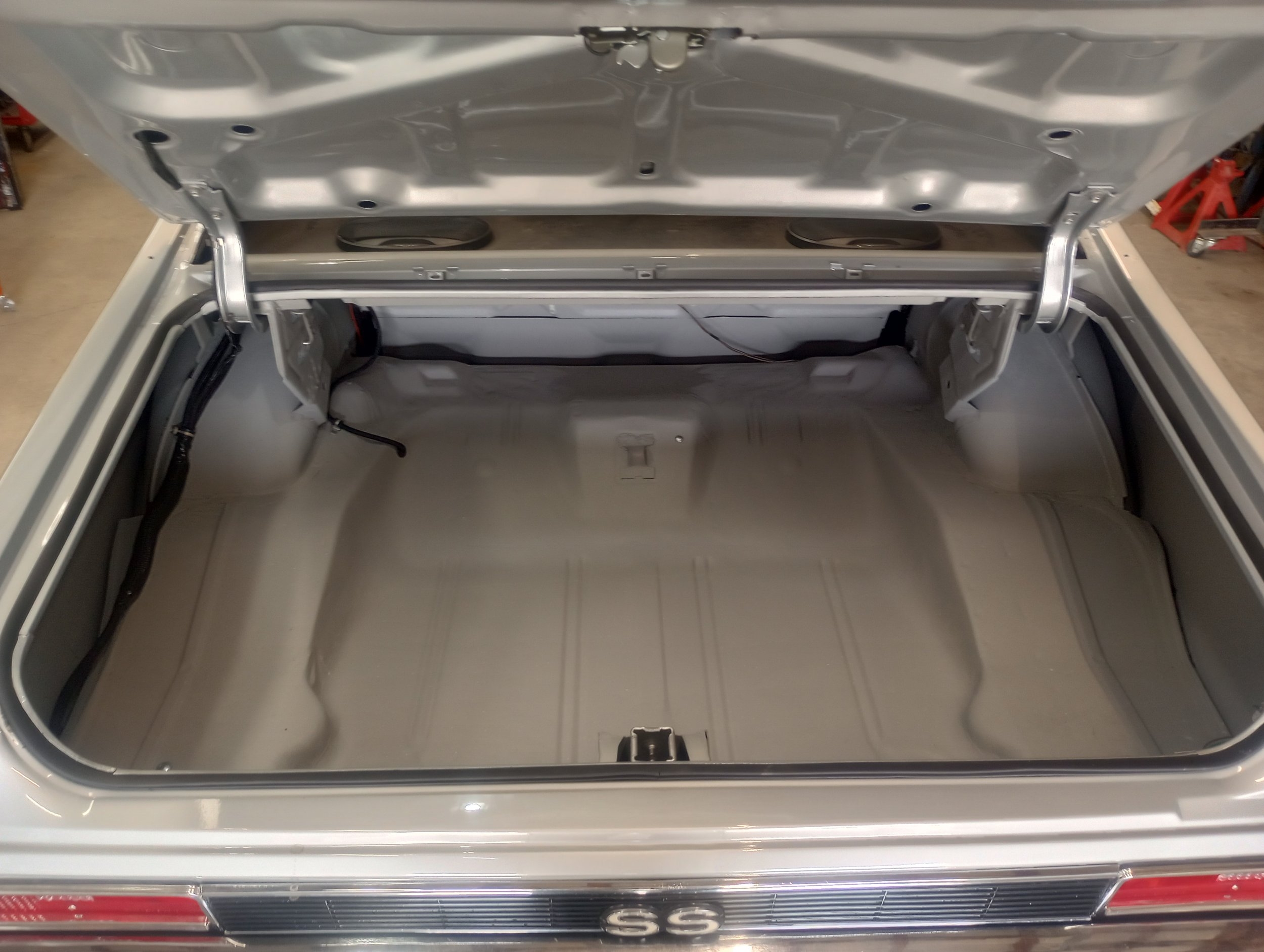

Still pecking away at wrapping up some of the last tasks on the Nova. Since I have it on the wheels now, I moved it around and discovered the brakes are still a little soft, and the brake warning light comes on when you hit the brakes. A couple of weeks ago Brian and I had bled all the brakes except the left rear, which is a difficult one because I had to install aright hand caliper on the left side so I could get the parking brake cable to be routed where it was able to connected to the pull cable. That put the bleeder on the bottom instead of at the top, so to bleed it I had to disconnect the parking brake cable, take the front caliper bolt out, rotate it up so the bleeder it on top, and put a caliper compressor in to keep the caliper from pushing out when applying brake pressure. I pumped the brake pedal a couple of times and stuck a piece of 2X2 between the pedal and the seat to hold it down, bled the trapped air out, and repeated it until the pedal was good and solid. No more brake warning light now.
Another item was getting the cowl panel installed, and that was another thing that took 5 times longer than it should have. The old cowl panel, which I still have, just screwed down to the cowl and lined up with the hood and fenders just fine. Now however, it sets almost a 1/2 inch lower than that. The cowl wasn't replaced and I have no idea what's going on, because the doors and fenders would have to be lowered that amount go get it aligned, and there's no way to do that. So, I 3D printed 4 spacers to fit under the attaching screws raising it up level with the hood and fenders. The hood sets down pretty snugly on the front of the cowl panel seal which tends to tilt it up in the rear, so after 11 tweak, check and retweaks, I finally got it to where it looks okay. That ended up taking 6 hours over 2 days.

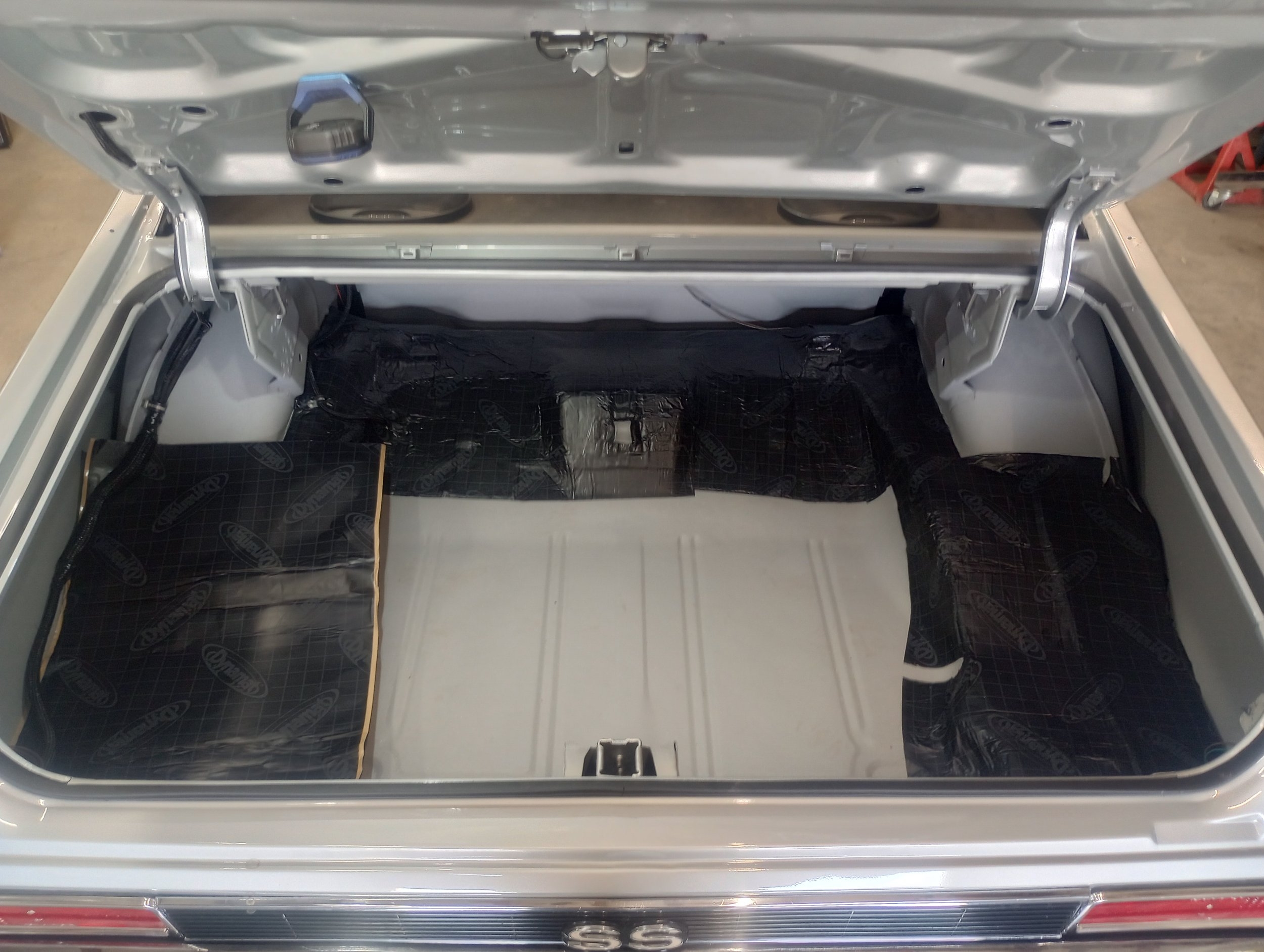

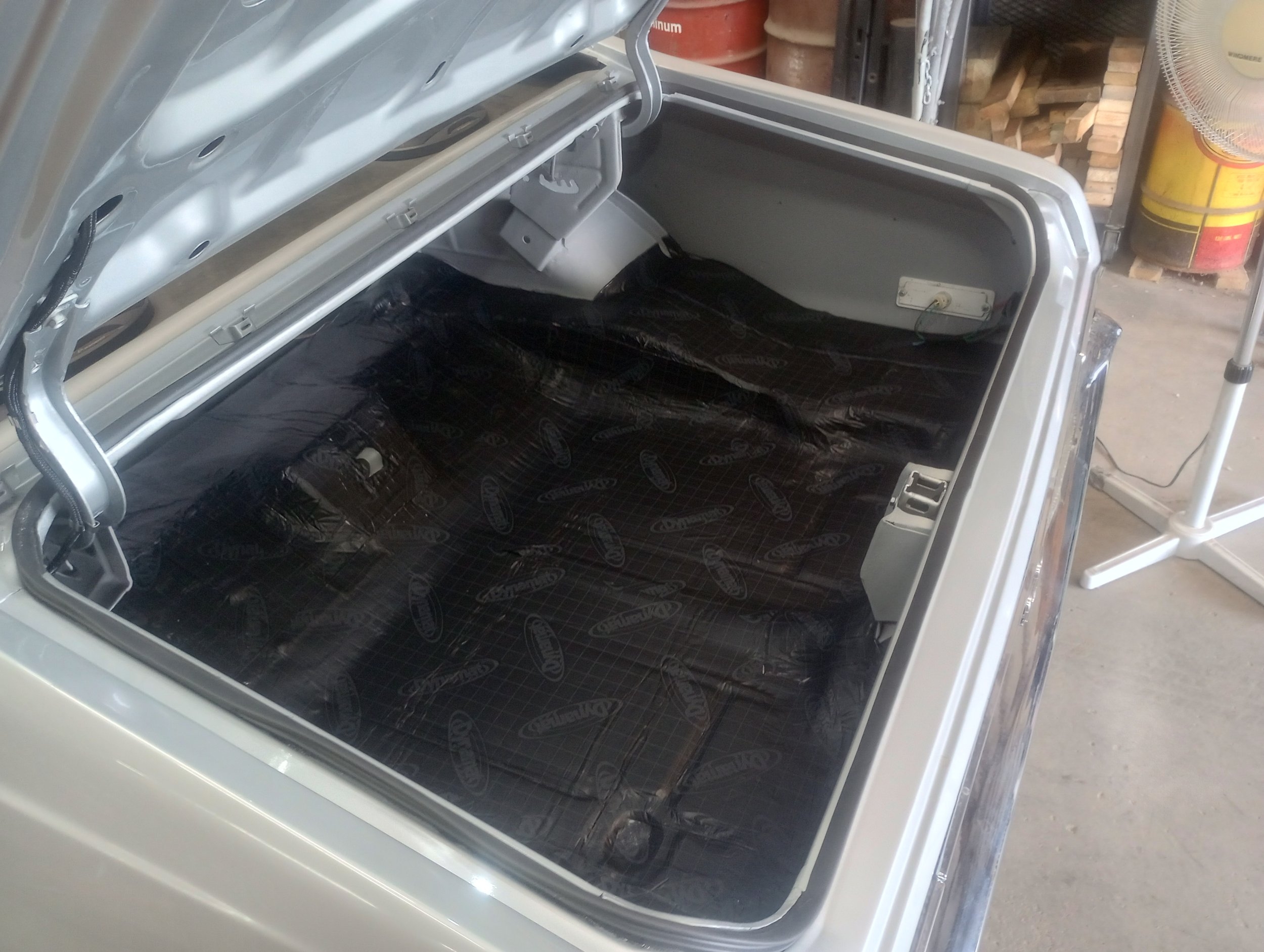

Another task was to install sound deadening in the trunk. Since I can move it now, I moved the tractors out and pulled the car out and tuned it around. That made it easier to work, with a folding table set up to use when cutting pieces of DynaMat to fit into the trunk. The first couple of pieces in the front were the worst, I had to get my big old ass in the trunk to to get them fit and rolled down. The rest was easier, and it only took 1 1/2 hours to get it finished. I had to take a couple of breaks, as it was over 90° in the shop. So now, I'm just waiting on the carpet to come from Stock Interiors in SC. They were the only place that had in in stock, let alone in silver to match the interior carpet.
One other item was the left tailpipe and muffler, they were loose and had rotated out of position. So, I jacked it up and put a couple of jackstands under the rear axle, then loosened everything up, got it into proper position and tightened all the clamps back down, really tight this time. I also retightened the rest of the clamps on the system. Nothing should move now!
