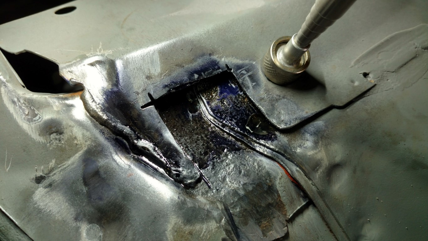

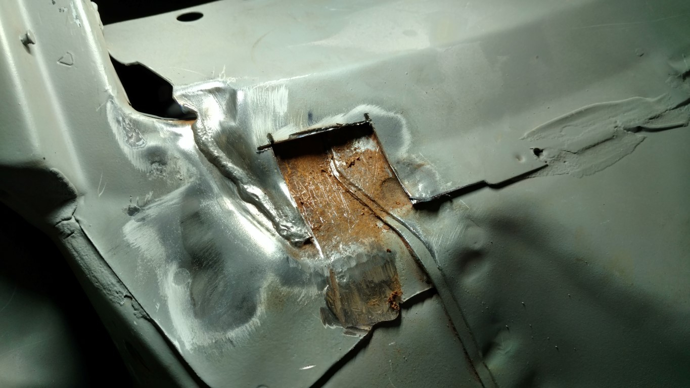

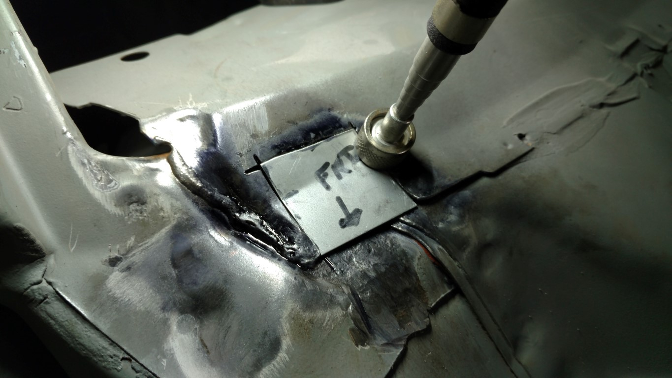

As I have been complaining, the right fender doesn't. fit properly up at the lower windshield clip. The left one fits fine. When all else fails, get out a ruler. Measuring down from the top of the windshield channel, I discovered the right side clip is about 3/8" lower than the left one. Aha! That's just the amount of room I need.
So, I remove the clip, only to discover a hole rusted in the metal under it. Doesn't surprise me, with all the other rust on the car. After all the metal we've replaced, there can't be much rust left. So, I cut out the area, wire brush, scrape and sand off all the rust I can get to, then make a patch to weld in. I give the area a couple of coats of rust treatment and let it dry.

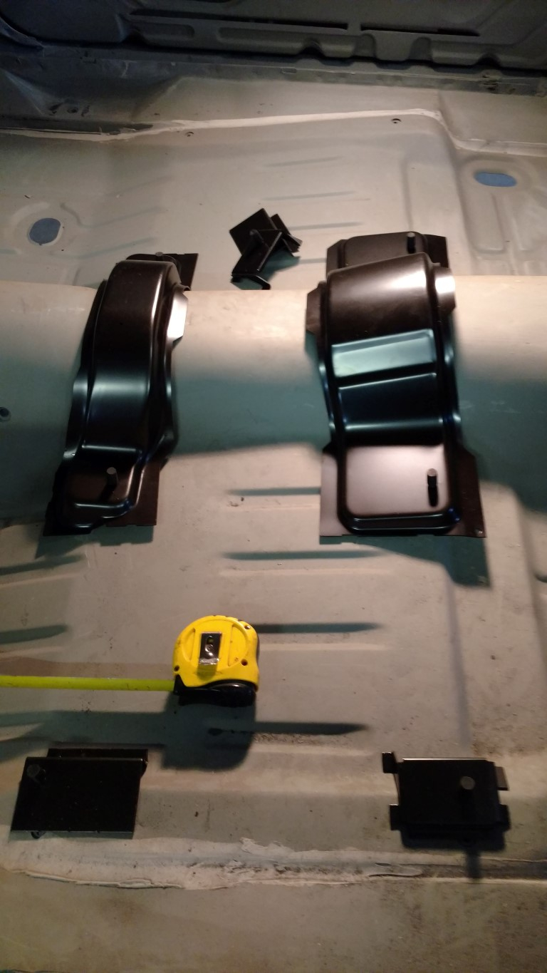

While it's drying, I dug out the bucket seats I bought to replace the bench seat. I also find the OEM style bucket seat mounts and lay them out to see how well they fit. Looks like the ones that go over the driveshaft tunnel will need a little massaging, the outside mounts I should pretty much be able to weld into place.
Yes I know, the inner mounts are switched, the wide one goes in the rear.

Nice work !
You will get the last bit of rust out as you keep at it (y) Good job..
