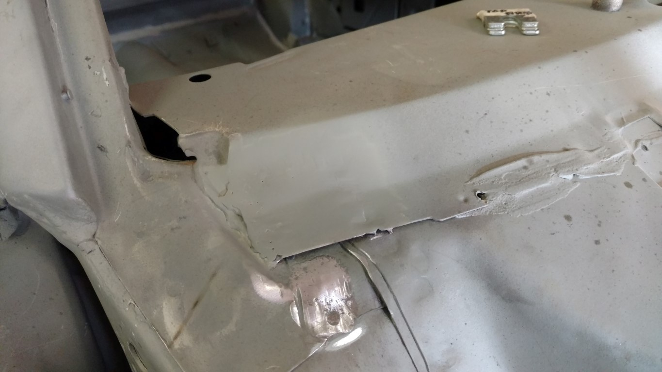

I got the patch welded in and welds ground down so it looks pretty good. Shot some primer on it and then welded the tab in place, the same distance from the A-pillar and the top of the windshield channel as the left one is..
I made a jig to locate the new bucket seat mounts so I can weld them in the proper places and the seats will just slip over the studs when installed. I just used a couple of 16" and one 13" piece of 2" X 1/4" bar stock with 11/32" holes to go over the 5/16" mount studs, then welded into an H pattern. Should make it easy to get the mounts positioned properly. Forgot to get a picture of the jig though. :whistle:
