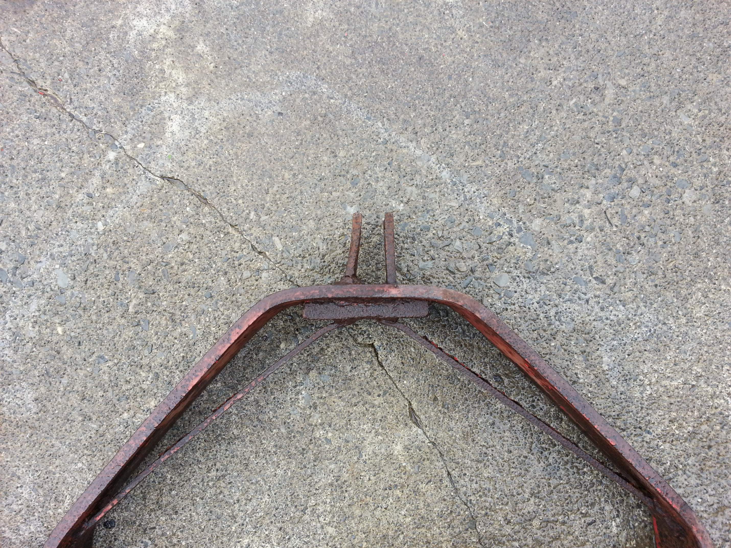

Here is a close up shot of the A frame. Look at the gorilla welds. In this came "more isnt better" LOL

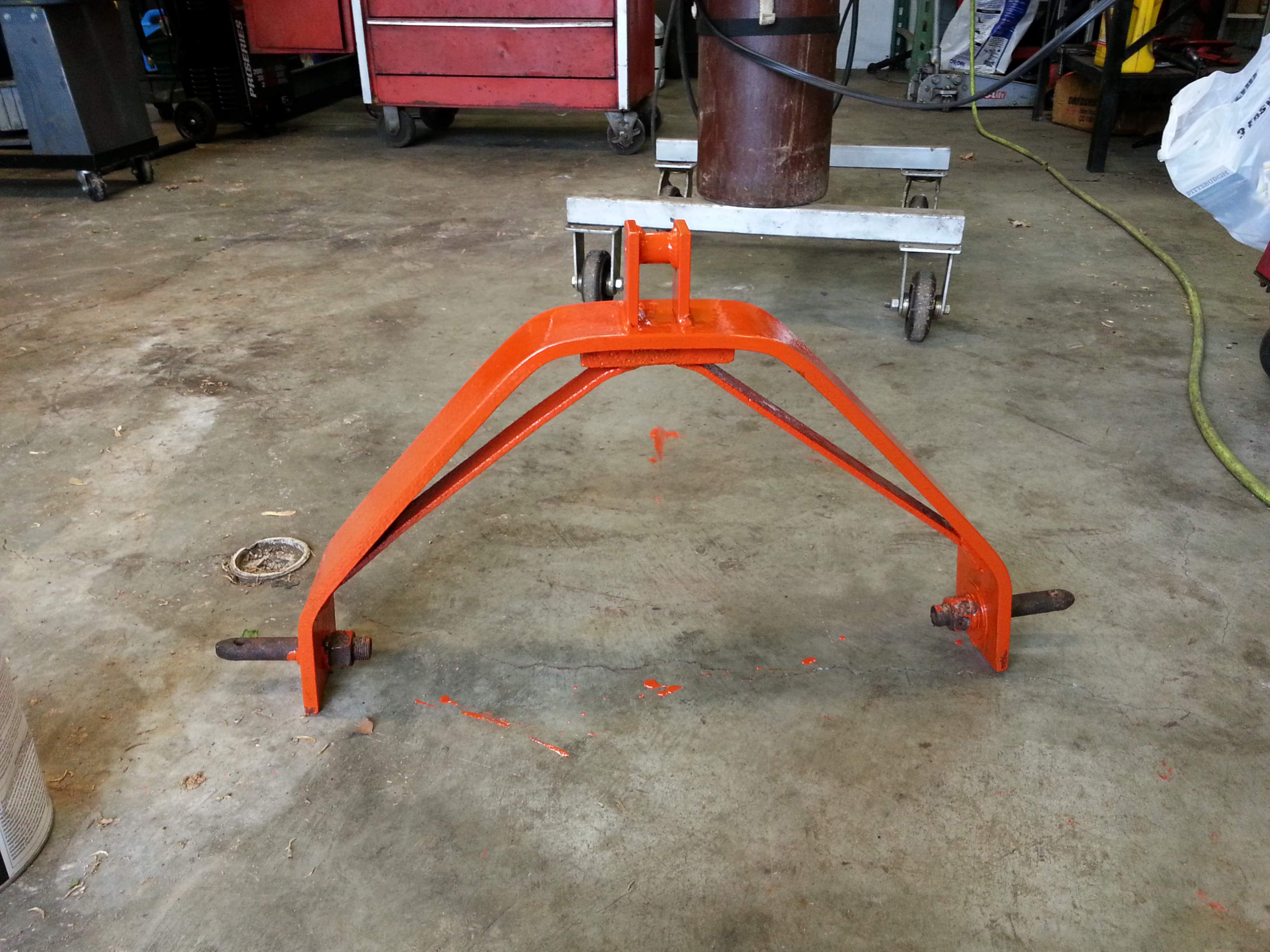

Here is the A frame after the repair. I used D.O.M. tubing 1/2" I.D x 1" O.D. for the middle of the mount. The side plates are 3/8" x 2" Flat Bar. Should be plenty stiff now.

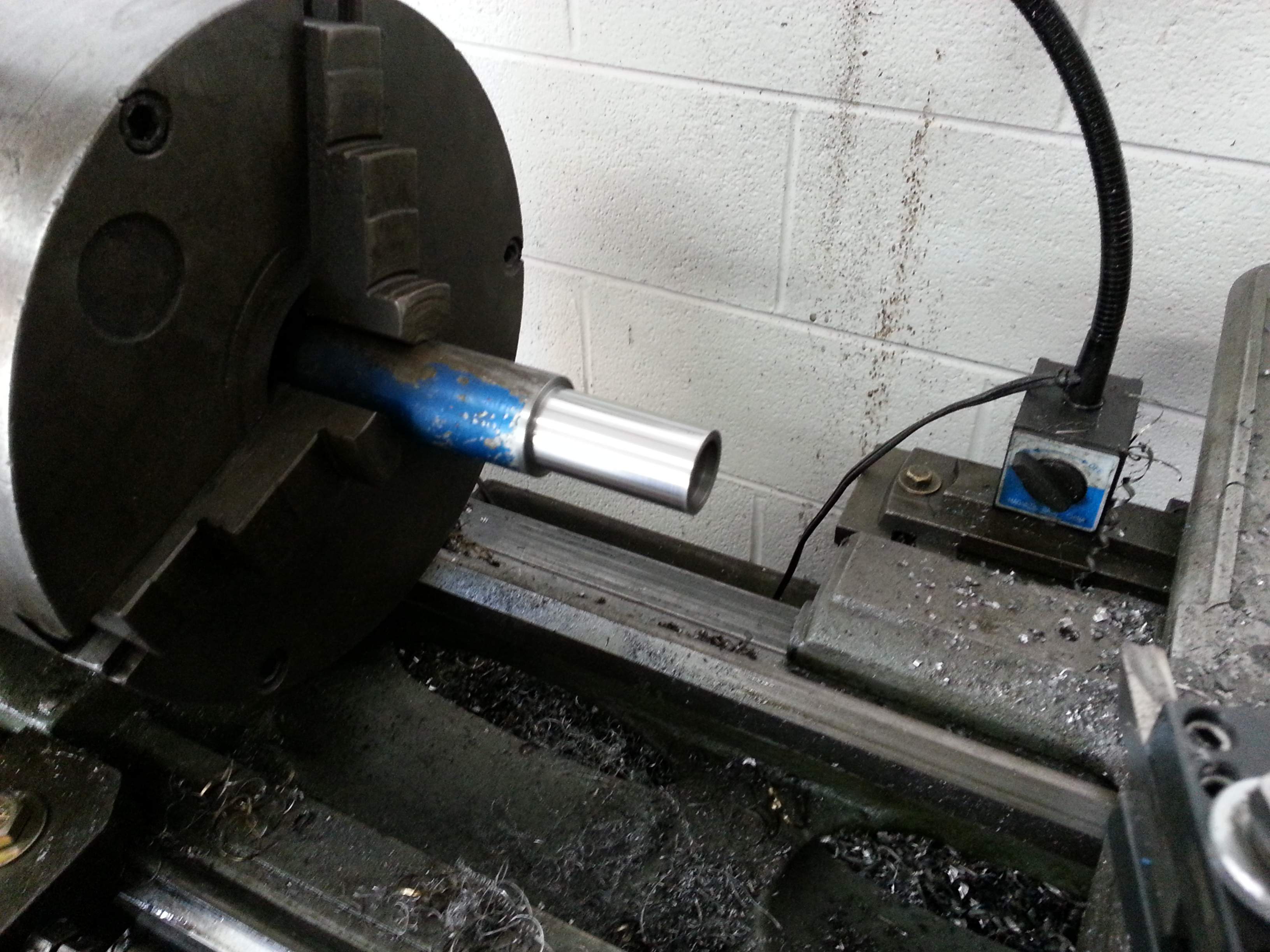

The tractor end of the boom pole it tweaked a bit. The hole was also wallowed out by about an 1/8". I will attach several pictures that will show the arm in my mill after I leveled and squared it by the boom and gearbox mount. I figured it would be much easier to bore the hole larger with the correct alignment than to heat and re-bend the mount itself. Hope that makes since. Pics worth a 1000 words.Here ya go.

This is part way through making the bushing to weld into the tractor end of the boom pole. It is also D.O.M. tubing and ended up being 1" O.D. x 3/4" I.D.

Here are the boom and A frame after some paint. On the boom, tractor end, notice the bushing pressed and tack welded into place. Ill be picking up new pins for the A frame too.
