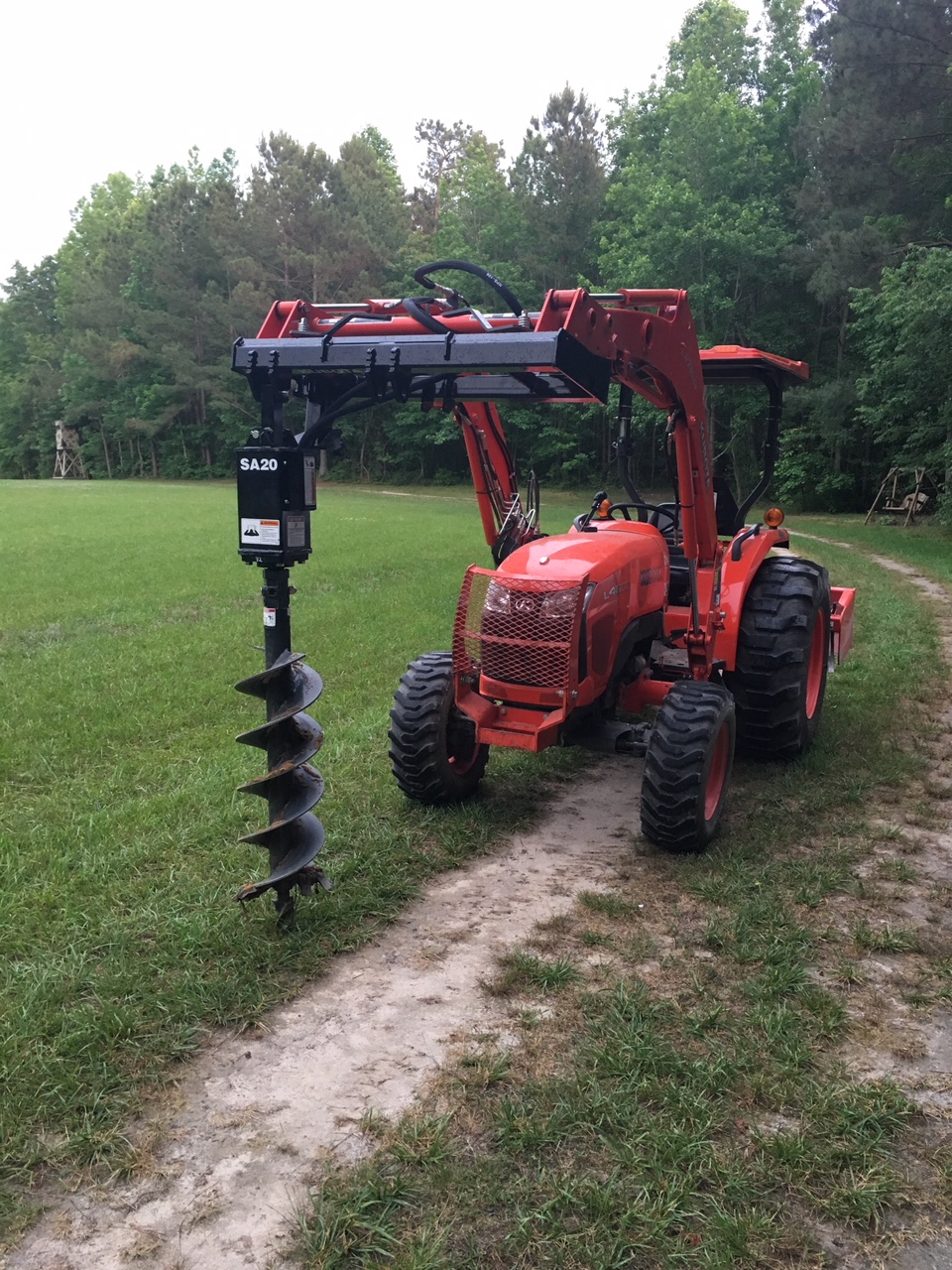

I have the Landpride SA 20 mounted on the loader. Our tractors are similar in size and my SA 20 has the 6 to 15 gpm motor. I run a 12" auger and have been pleased with the unit so far. We have a mix of clay and sandy loam soil. It doesnt spin fast enough to clean out the holes in the sandy loam, but works well in clay. Down pressure is great as is the option to reverse. The slower bit speed also helps with overall control. I use the offset mount for better visibility. Last I run the hydraulics through a WR Long 3rd function kit.

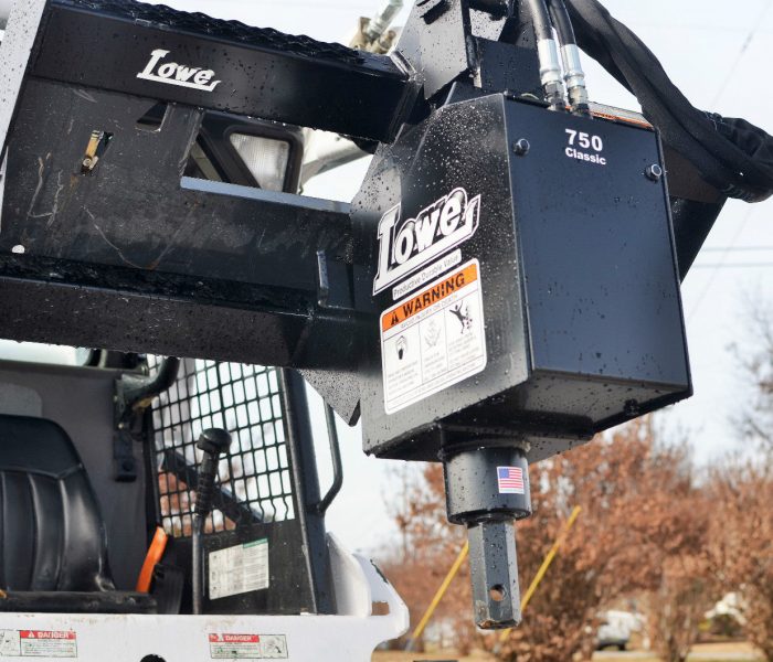

$1400 from a company local to me, requires 8-20 gpm:
Lowe 75 Hex Classic Auger Unit - Skid Steer Attachment Depot
If I had known then what I know now, I would have skipped the 3ph post hole augur for ~$700 and bought this for my super rocky soil. Far easier to mount and dismount, better vision while working and provides down pressure.
