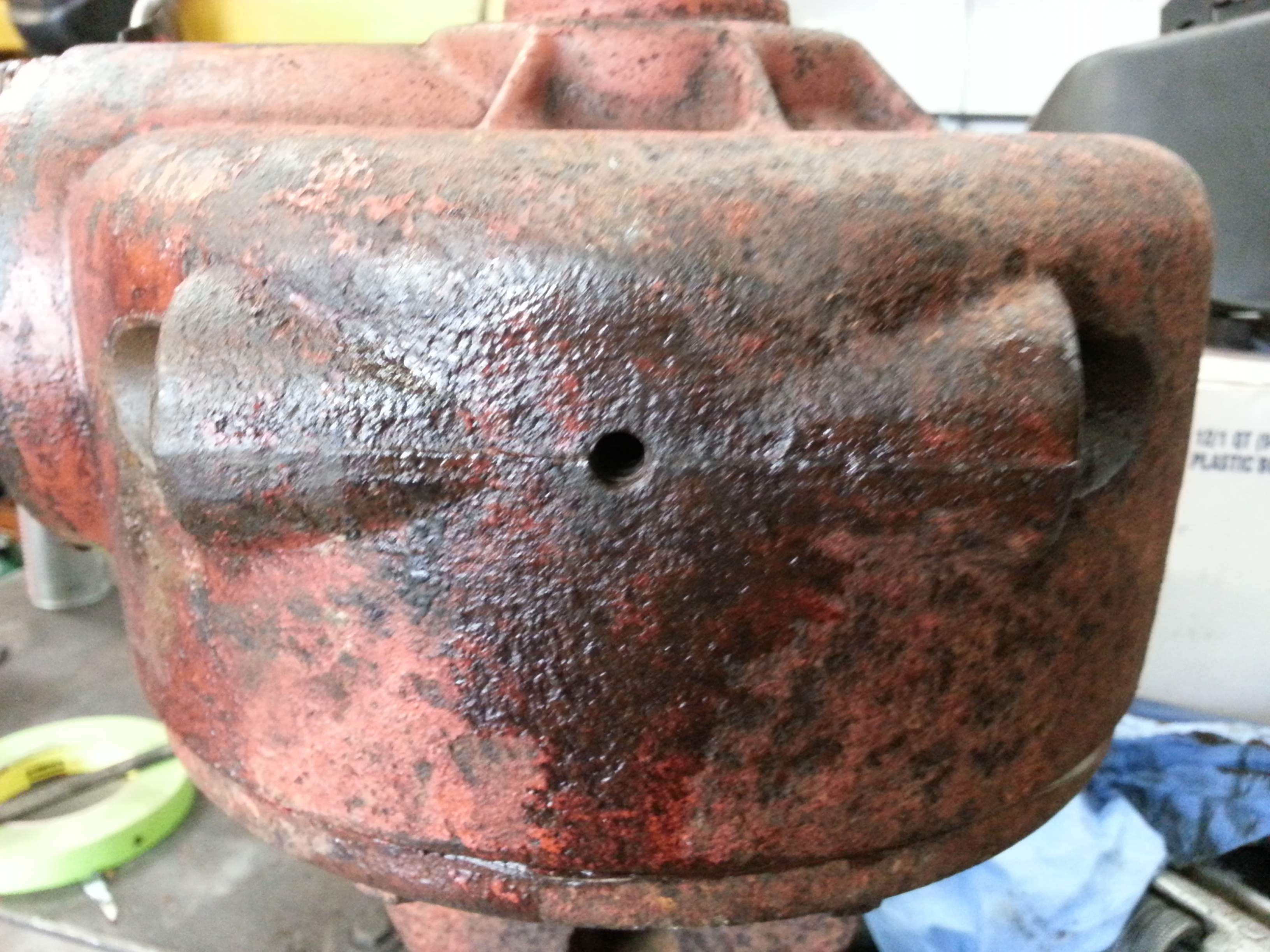

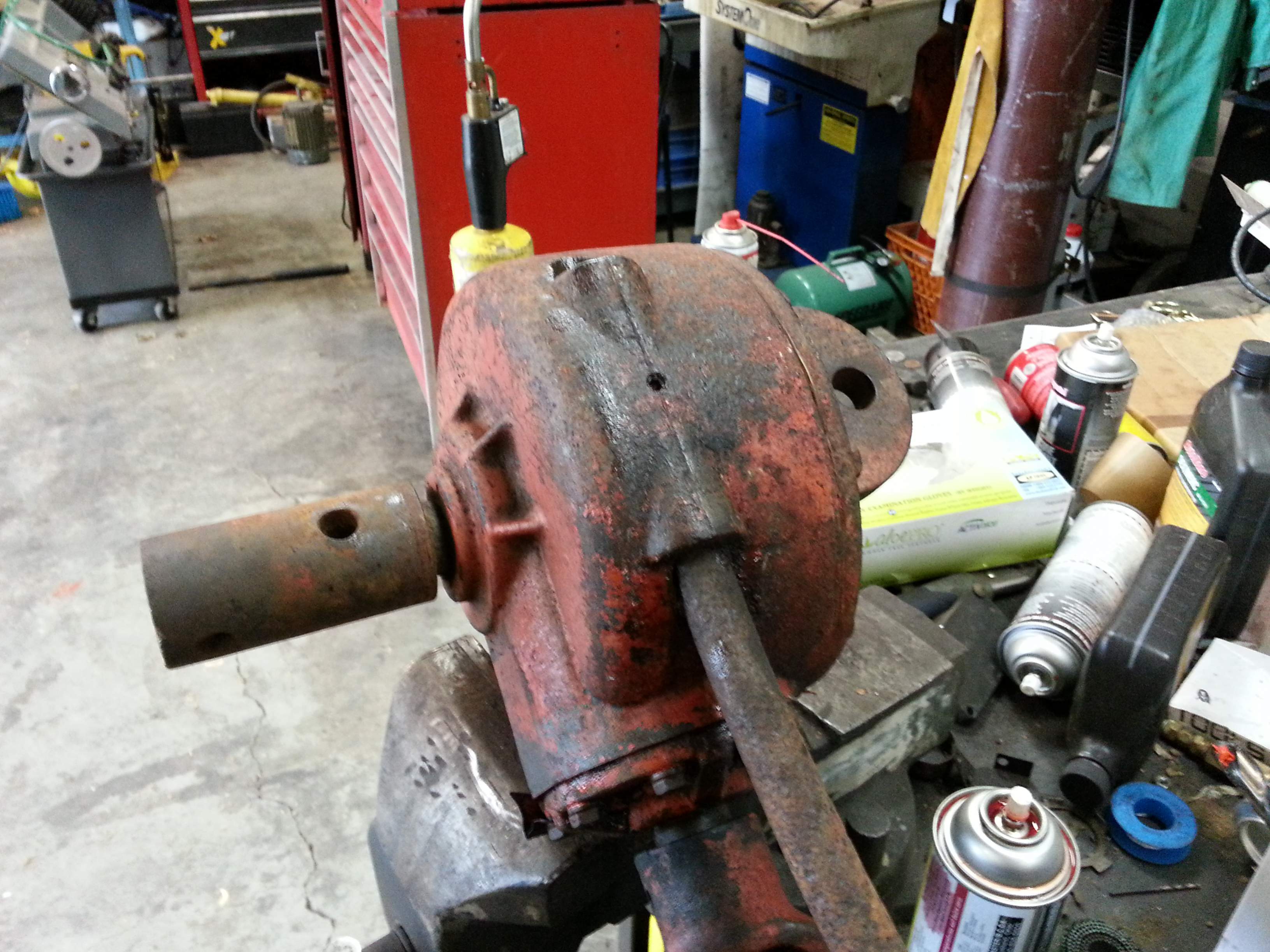

Here is the gear box with the leveling arm. The allen set screw has been stripped out. Guess its time to drill and re-tap the hole for a 5/6"-18 set screw. Even the arm was rusted in tight, a little heat did the trick.

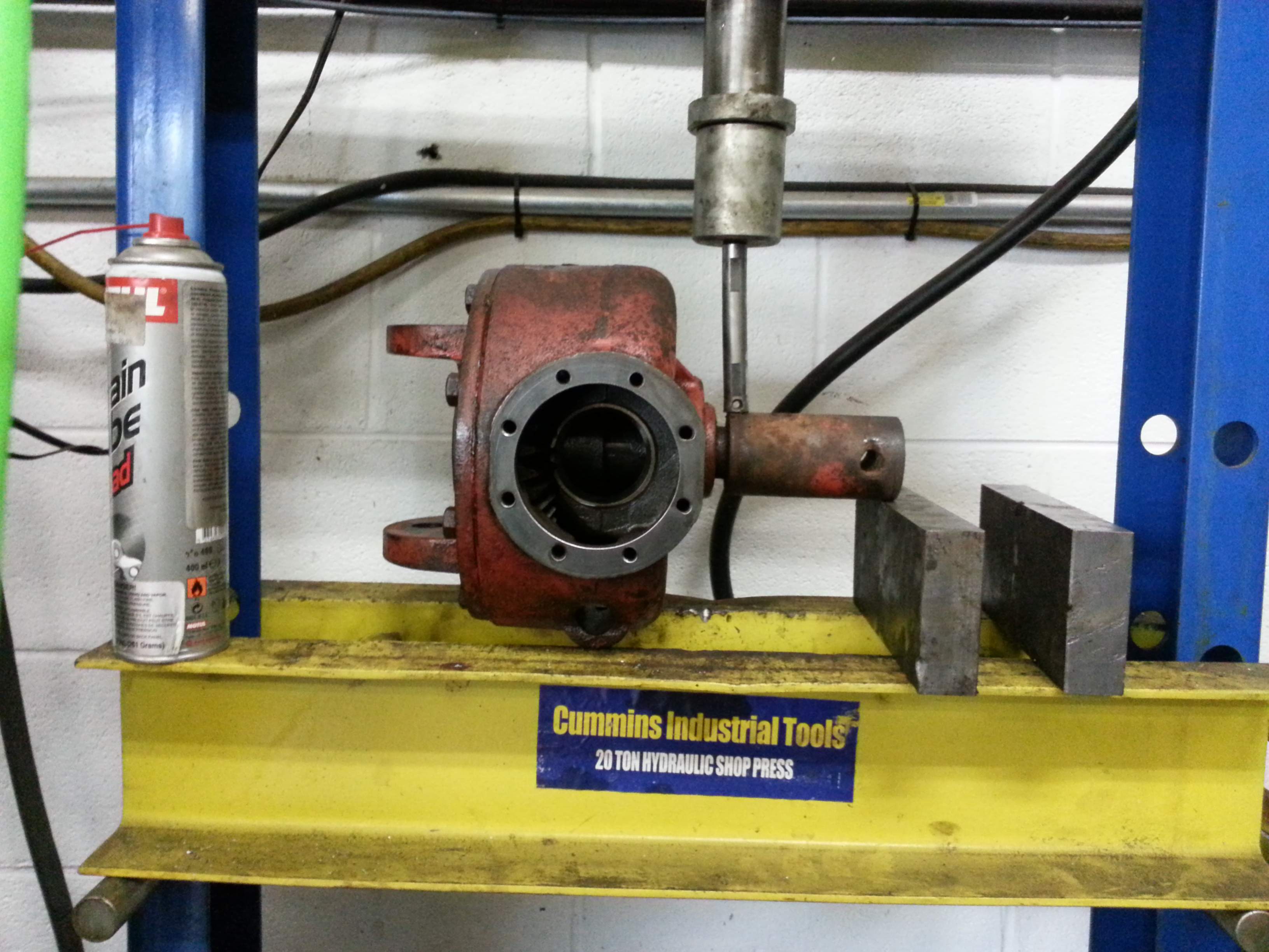

The output shaft had a pretty good bend in it. Ya know a little bend in the back would wobble like crazy at the end of the auger. With all the new tighter bushing areas I didnt want it to shake my little tractor when digging.
When I look at your push punch, I want to reach for a pair of safety goggles....Fast. I have seen pieces like that fly out under pressure and go through a metal shop wall. Be careful. Ken Sweet
   / Restoring a Post Hole Digger
#18
Forget the safety glasses I was behind a 1/2 piece of plywood when I was actually doing the bending. The Pin you see in the picture is a spider gear pin out of a suzuki samurai diff.
   / Restoring a Post Hole Digger #19
I thought that pin looked hardened. Thanks for being safe. Ken Sweet
