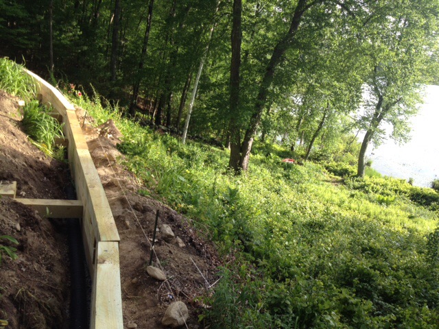

Reviving an old thread to provide an update. I decided that I don't really need a fancy structural wall, just something that lets me level out the flower bed. I ended up doing the work myself (seems like a major pain to get a contractor to even show up around here right now).
I went with a timber wall installed where the hill started to drop off. I ended up being able to get the BH close enough to do the digging and did a combo of lifting soil up and pushing it down, which created a bit of a ledge on the hillside so I'd have a place to stand and place the wall. I installed the wall last week, due to access much of the work had to be done by hand. Thankfully I only hit 2 large rocks, both small enough for the BH to move, but too big to budge by hand.
The basic design was 8' 6"x6" PT timbers with deadmen every 8' and backfilled against the wall with gravel and a drain pipe before topping and levellin with loam. It turned out to be 70' long and 30" tall. I also burried a row and attacked it to the hill by hammering in 2' rebar sections.
I'll try to post some pics shortly

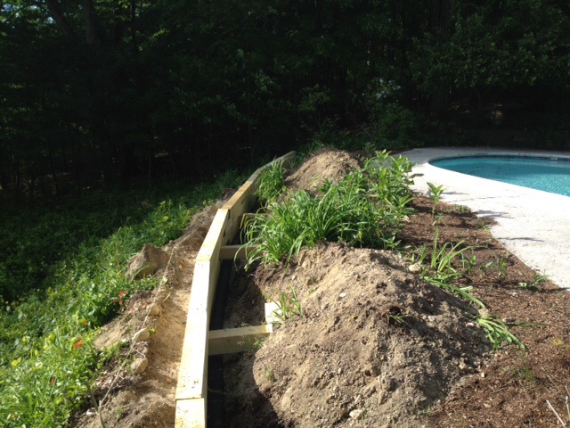

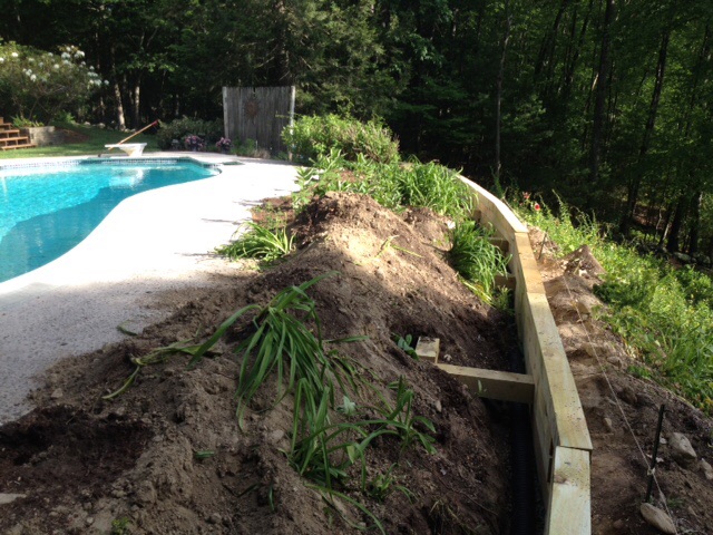

The photo levels it out a bit, but there's a very steep drop on one side and the pool on the other. In the middle the wall needed almost no backfill, on the ends it needed a lot.

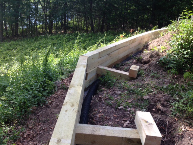

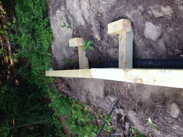

Close up of the deadmen. They were 2 - 3 feet with 15 - 20" cross bars.
The whole wall is curved, which made it very challenging to stagger the joints. I ended up trimming with a chainsaw to make it all smooth in the front, though no one will ever see that angle

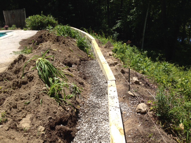

The top of the wall and the pool deck should be more or less level with each other, though I didn't go crazy with lining it up. I will grade the soil to be slightly below the level of the pool deck to keep water and debris from running from the flower bed into the pool area.
Final backfill with gravel. It took about 6 tons of gravel on top of a 4" perforated pipe. There should be minimal water retention behind the wall, but I wanted to also try to minimize how much frost moves it.
