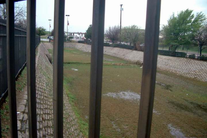

Wouldn't you know it? I was at the one in Grapevine that I was thinking about on Friday and didn't have my camera. It's not along a creek, but in a runoff collection basin in front of the Target store there. Next week I'll try to remember to get a photo.
I stopped by the shopping center in Grapevine last night and I even remembered to carry my camera. This picture shows the catch basin from the parking lot. I know this basin is at least 10 years old, maybe more. It's holding up pretty good and still looks attractive.

Apparently that type of retaining wall isn't as unusual as I first thought.
Jim I don't think we have that many cement bags in the entire state.
