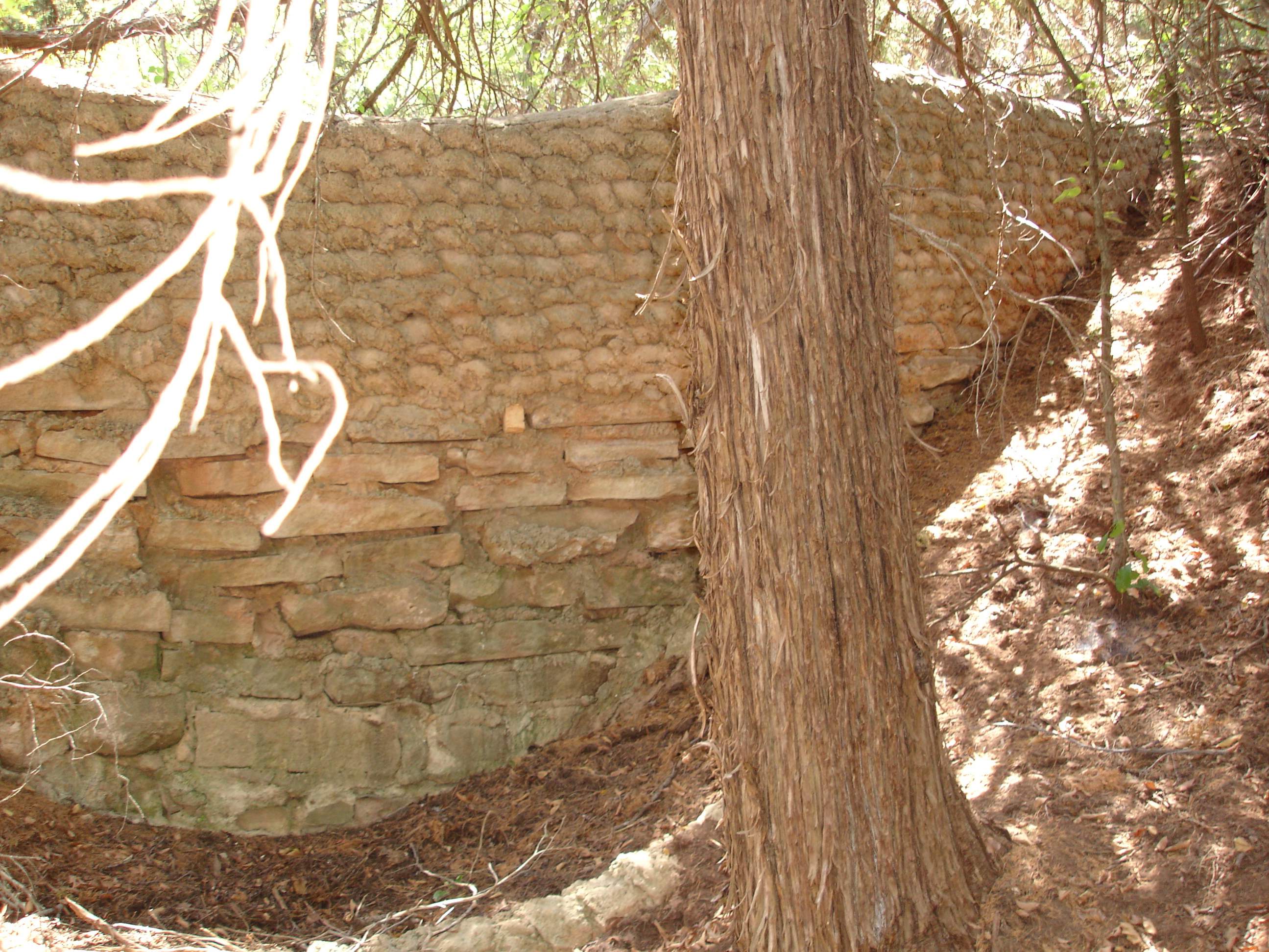

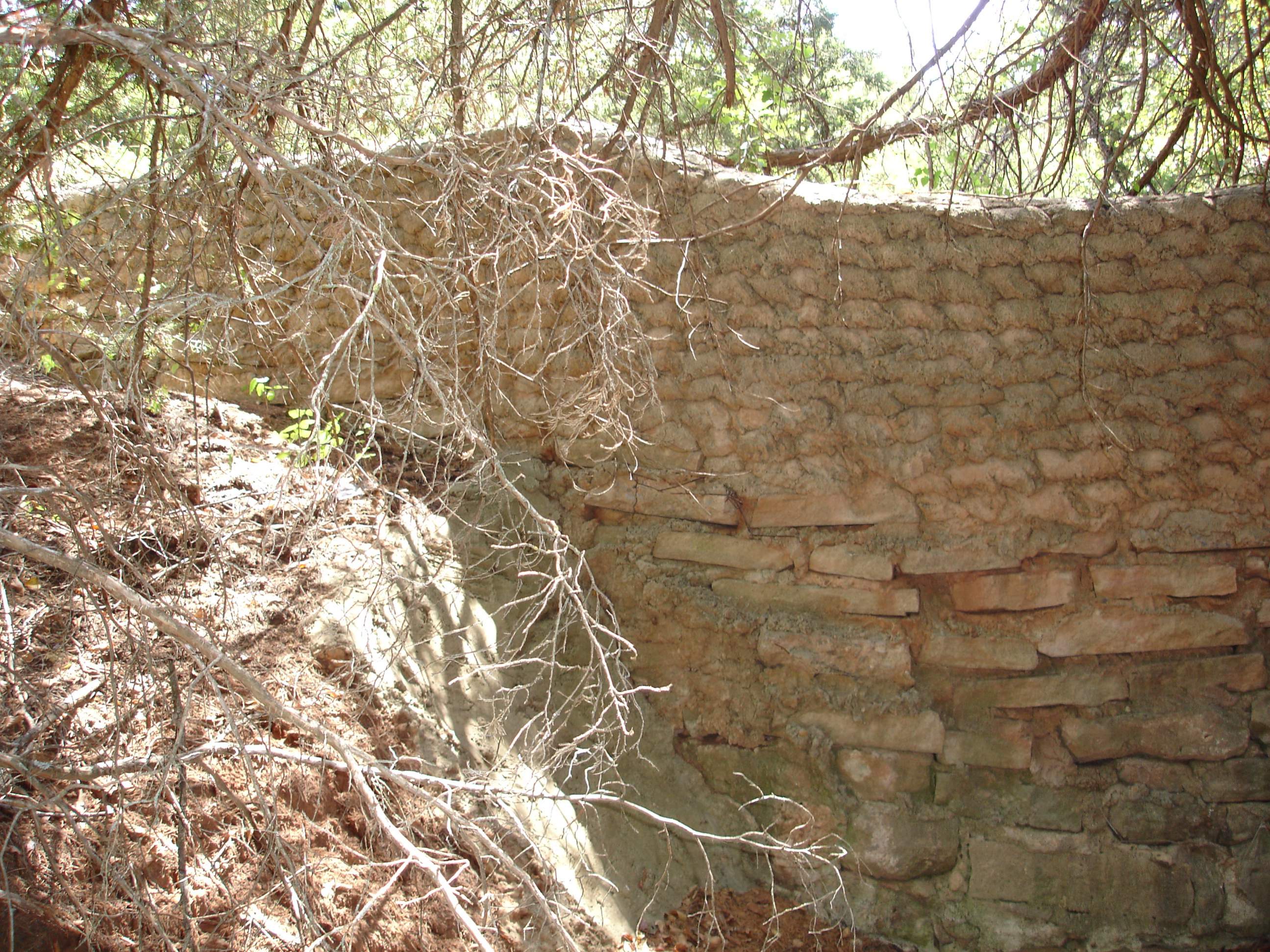

Here are some photos of the two traps on my spillway.
