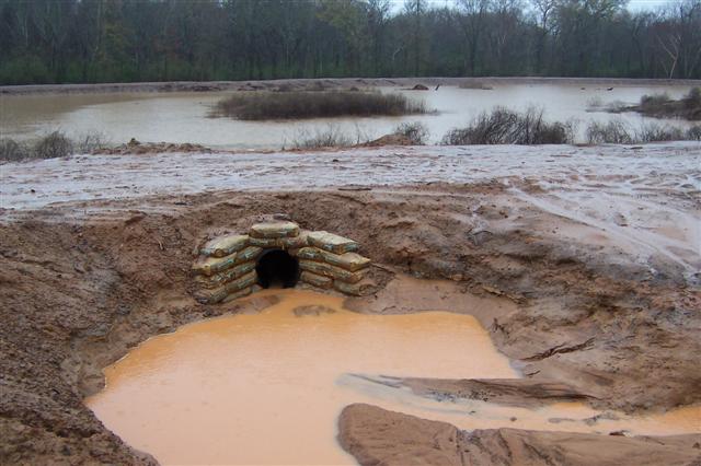

I've never built anything as big as what's been shown in this thread, but I've done this quite a few times for culverts. I have always used 40 lb sacks with lengths of 3/8's rebar driven through them. They are regular sacks with the plastic and paper wrapings. When the rebar goes through them, it tears the sacks and the two bags mix and become one. I like to put several pieces of rebar into each sack since I have no idea how many I need, I just go crazy and probably put in too many.
I've never hosed or watered them when I'm done. The next day it's still loose, but by a week later, it's pretty solid. I've had heavy rains come down and hit it right after putting it in without any sign of wear or damage too.
Eddie
