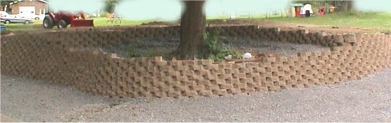

Fred,
Thanks for the compliment!
Sorry, can't do a pictorial- already have the wall up! /forums/images/graemlins/crazy.gif
But, I can put together what I did fairly clearly when I get back. I will be out of town a few days and have to finish some paperwork now.
I'll be back Thurs or Fri. Maybe I'll get some time on the road to work something up...
-JC

Tracdoc,
I used Garden Wall interlocking block (with the lip on the back of each block)
They are really only supposed to be used for about 36" or so, since they are designed to lean backwards and after that many courses (4" per block), the weight would be unbalanced.
We completely burried the bottom course to prevent kickout and put the gravel behind the wall to support it forward and to prevent the clay and dirt from pushing the wall.
I got the stone from a local supplier, at just under $2/ea. It wasn't cheap, but it's permanent.
I'll post a new picture as soon as the weather clears up. We added a top ring to encircle the tree and step the ground for a better to level.
Sorry I didn't notice your post earlier, else I would've responsed sooner.
Thanks to all for the compliments.
-JC
   / Retaining wall
#15
Here is a new picture with the top ring around the tree.
You can see that we have started to level the ground above the ring.
We will shortly fill in the tree area with gravel, then some sort of decorative stone. We're planning to put some potted bushes or other plants/flowers into this area.
Figure avoiding dirt will prevent weeds, and the poison ivy that continuously grows on that tree /forums/images/graemlins/grin.gif
-JC

More sunbathers in the background? /forums/images/graemlins/blush.gif
   / Retaining wall
#17
Herdfan,
Yeah, guess nobody got the joke last time. Must've figured I was serious /forums/images/graemlins/tongue.gif
Those are some "unimproved" areas I haven't gotten to yet and didn't want to show until fixed up.
-JC
