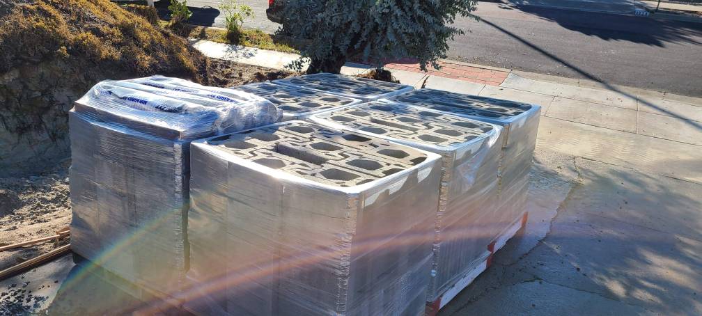

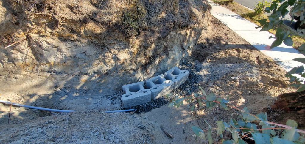

First batch of blocks arrived for the retaining wall. Started getting the lowest point first course down. Using a 10 inch 3/4 clear base. 3 down, 492 to go. received_425082985295514.jpeg20201229_122413.jpeg

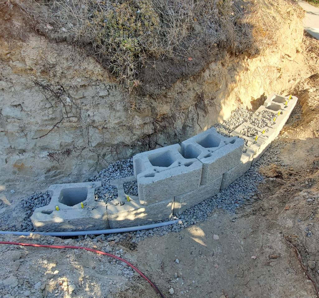

I see the slight curve. Are you setting the wall vertical or using the step back option? When I rebuilt my wall I changed it from vertical to stepped. Cutting the blocks for the curve was a pain.

Going vertical so the blocks will be flush. They are secured with pins instead of lips.
These blocks are narrower in the back than the front so you can curve them without cutting. Makes it really easy.

Realized I needed seven blocks on the first course so had to dig out a little bit. But today I bought a cheap 20lb bauer demo hammer from HF... seems to work just as good as the makita I usually rent. So far this is about 3 hours of work to get these blocks in.
Tomorrow I'll pick up some drain pipe since it needs to go in behind the second course. 20201230_153757.jpeg

That works for a while, but depending on the curve and height eventually you have to start cutting blocks. The radius of the curve gets tighter and at some point the pins don't line up anymore.
