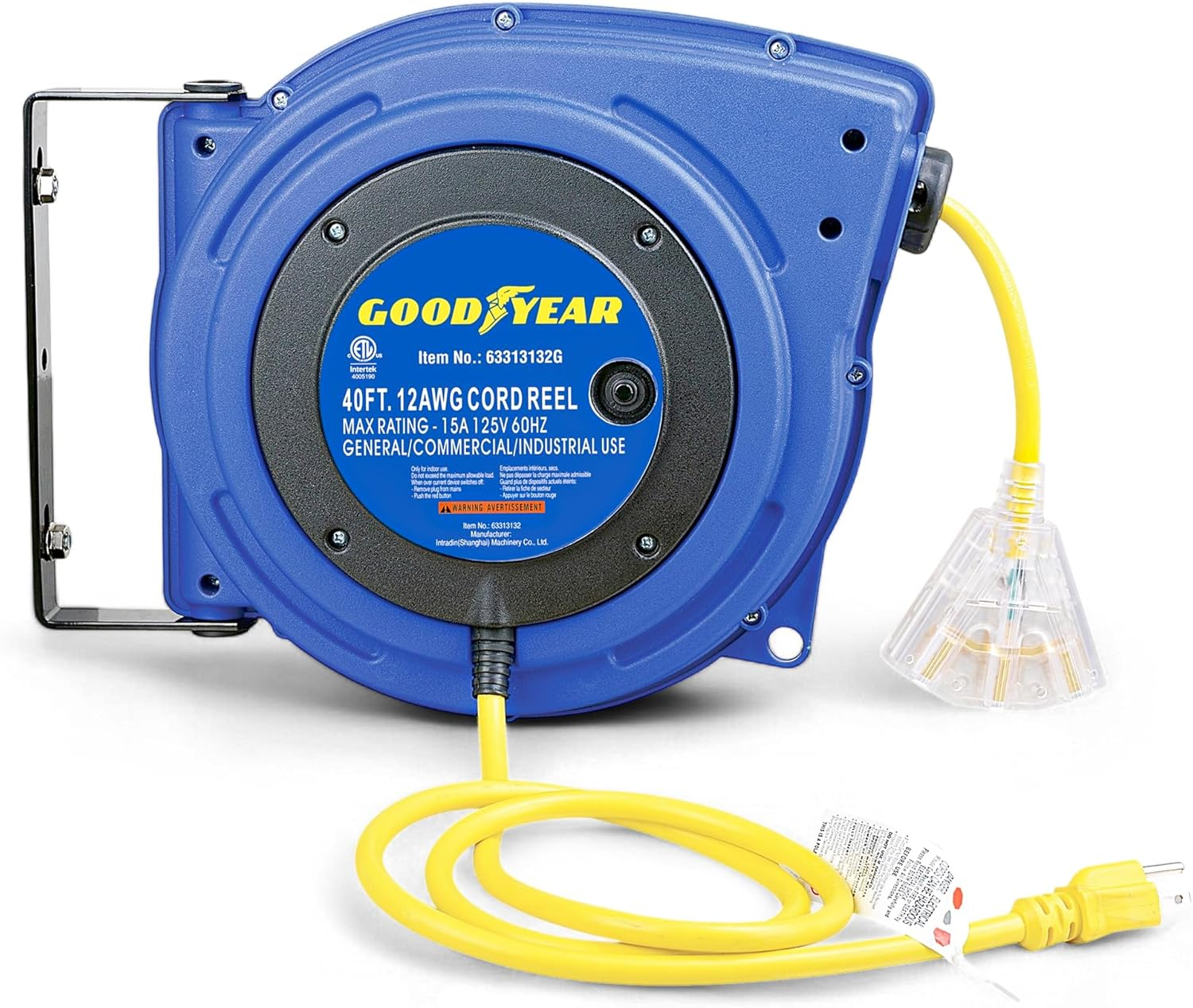

Changing direction in garage to add a (probably ceiling mount) cord retractor. Turns out there are a number of brands. Looking for ideas:
Plastic or metal construction? (I prefer metal, but open to better ideas)
I'm looking for 50 feet, 12g, want three plugs on the end of it. I don't care if they're lit or not
I don't want something that's flimsy and going to need replaced in three years. I'm going to guess the weak spot in these would be the return spring?? (I've got a couple retractable dog leashes and the spring wears out on them over time, rendering them useless)
I don't mind paying for quality. Prefer nothing made in china but also realize that might make it hard to find.

One thing i have noticed is 12 g extension cords tend to be downrated to 15 amps once they reach 50 feet and over. If you notice the HUGE 20 amp 100ft extension cords used on construction sites, they have different, thicker insulation materials and have real 20 amp receptacle ends. Not ment to plug into residential 15 amp outlets….at least the real ones ive used over the years.
I think the industrial cord reels ive seen rated at 20 amps have all been 30-45 foot runs for this reason.
With out getting into the construction of the cord , the longer the run , over 50ft., a larger conductor is needed to account for the resistance created in the line itself. So, an extension cord or reel over 50ft. may need a 10ga. conductor rather than a 12ga. to carry the 20 amp load. It protects you as well as your tool or equipment from damage that can happen by operating at less amperage than the tool requires.

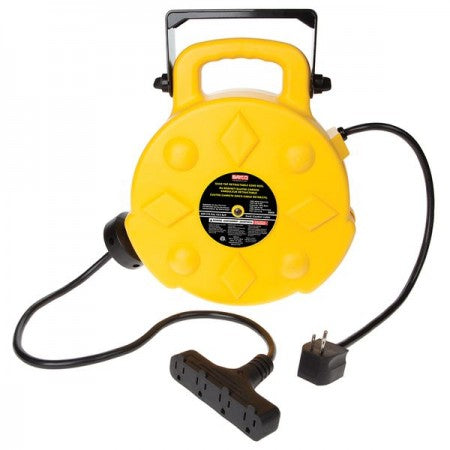

If you find one only with a single outlet. I have a triple short adapter that i plug into to have the flexibility for more outlets. I had a 3 head that went bad so I put a new end with plug lock that I can switch it out to the 3 head and it holds it without issues. mine is a northern tool that I've had for 10 years. Like I said the only issue was with the cord end.
   / Retractable (electrical) Extension Cord Suggestions? #25
The ratcheting mechanism on the cheaper reels fails. Also the size of the housing can make it difficult to get the cord to smoothly retract. I think I have one from Northern Tool. I wouldn't buy it again. I have to have a spring clamp nearby to prevent the cord from retracting.
One thing I did was to replace the outlet with a locking receptacle. No more accidentally having a tool come unplugged. I also purchased a triple tap locking set. When I need more than one outlet, I lock that extension into the single locking receptacle. They work outstanding.
