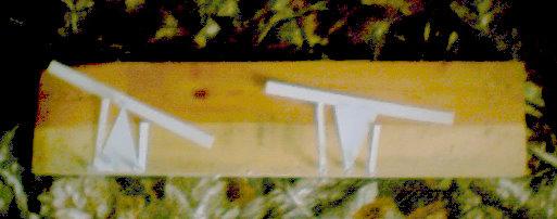

After much study, thought and many calculations I retired to my research and development lab and have determined that it will work, but because of the change in geometry, you'll probably need cylinders with a longer stroke than the normal plow angle cylinders. In the normal engineering office to reach this conclusion, would have required 3 engineers, several days and several thousand $$ of time.
But,
Actually, after going out and measuring the plow, I went to the kitchen table and did a scale cardboard cutout and in about 10 minutes this is what comes out.
If you look closely, the cylinders are exactly the same length scale 2 ft and 3 ft, but with the reversed A frame the 2 ft one does not reach the blade and the angle is no where near the regular A frame. It absolutely does offset the blade by over 6" and it isn't fully angled as shown.

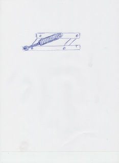

The other sketch is the broom offsetting mechanism I mentioned previously, just food for thought.
Give it a try, you can always turn the A frame back around!!!

   / Reverse "A" frame on plow #12
In playing with that scale model a little further this morning, It looks like standard angle cylinders might work, but they will always be extended a little further than normal and you might have to move the mounting points out slightly.
When a regular 8 ft plow is fully angled, the edge of the plow will be slightly less than 4 ft from center. With the A frame reversed it will be about 5 1/4 ft from center, so you would definately gain winging ability.
FWIW
Because I have an 8 ft front mount snowblower, I don't need to build any of this but it's fun to study these ideas out and It got me thinking that years ago I had a 6 ft drag behind blower, that came from the factory with a detachable 3 ft extension wing to widen with. My backblade can also be offset about 3 ft to either side which I tried too. Niether method worked great because it tended to pull the front wheels into the bank. However, if you had a plow on the front, it should offset the drag on the back.
