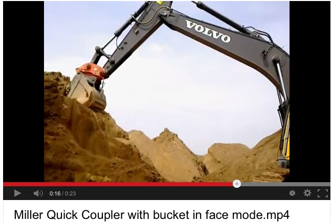

If you reverse the cylinder, it will still curl when the cylinder is retracted. Doesn't matter which way the cylinder faces.
From the video above:

exactly what i was thinking about the tilt rotator, but one could get dizzy and end up like this guy

Just rotate the cylinder 180 degrees so the rod is towards the backhoe rather than away from it.
What difference would that make? The cylinder action is still the same.

... = Why I asked. I couldnt see any easy way to uncurl the bucket with cyl extension. Thot I must be missing the point somewhere. :confused3:

It looks like you are correct. Piloon suggested that and I had not given it enough thought. To get the stronger cylinder direction while digging with the bucket backwards would take a lot more than flipping the cylinder around. You'd have to get the cylinder on the bucket side of the dipper or something which is not practical.
