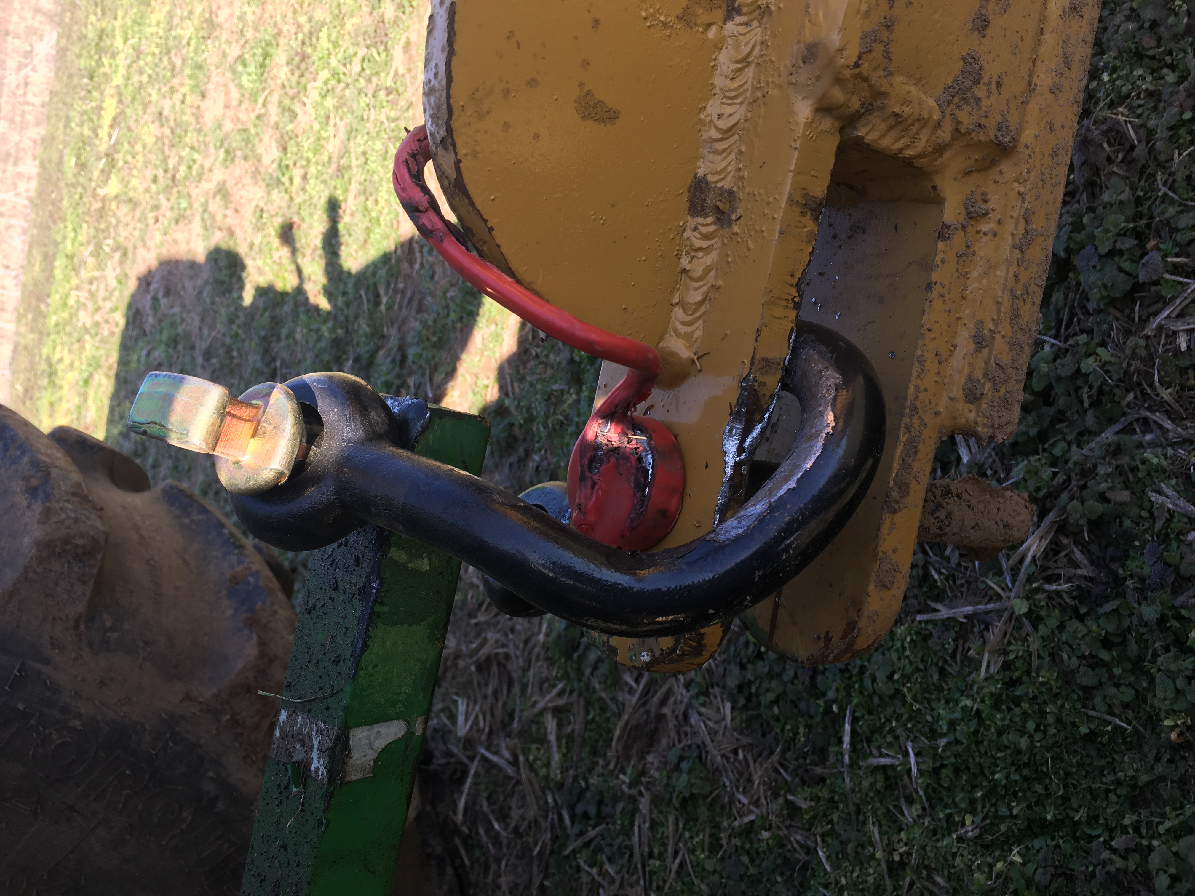

Well... the 1" twisted Clevis didn't work out. About 3 hours of use, and it beat the **** out of the connector, pin, and actually bent the clevis. It is now very hard to get the pin into the clevis as the holes are no longer directly in alignment.
I have to do something because I know that I'll break the towbar or implement if I don't. But short of hauling them to a welder or having one come out, I have no options. I have to get both a towbar adapter, like a hammer strap, and have the implements altered as well.
Or just have the implements altered similar to yours, Todd.
Sorry that didn't work out. Something definitely looks wrong with that clevis. Almost like it doesn't have enough twist in it (anymore).

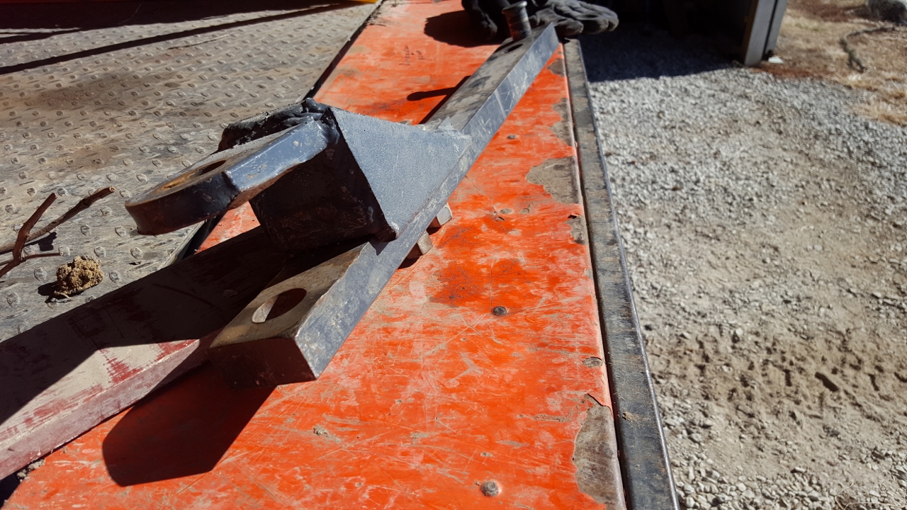

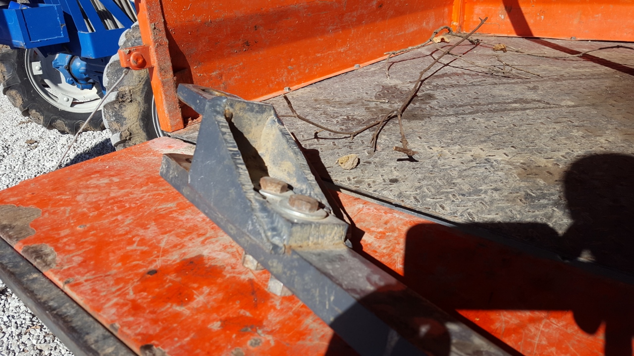

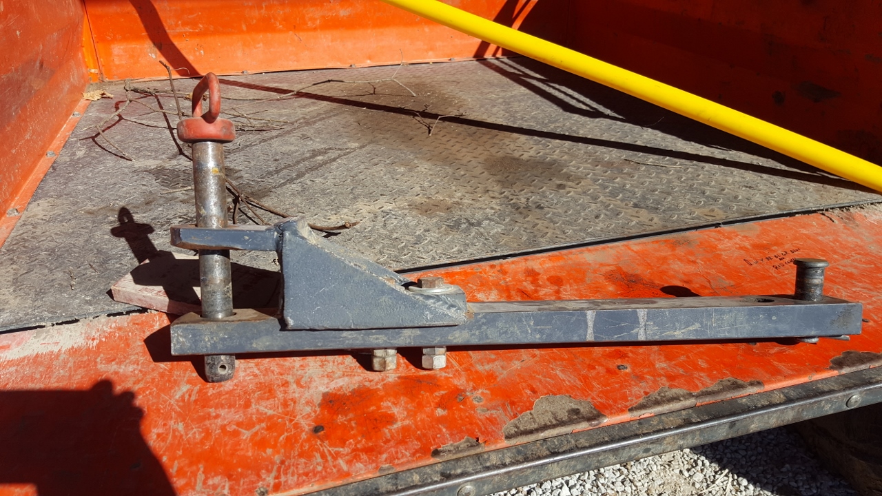

Forgive my crappy pics. But hey, I remembered to get them. :)
I built my Hammer Strap. Uses an 1 1/4" pin.
The pics of the lunette are on my scraper. As I mentioned earlier, previous owner closed up the hole to prevent slop. Originally it was a 3" diameter loop.
