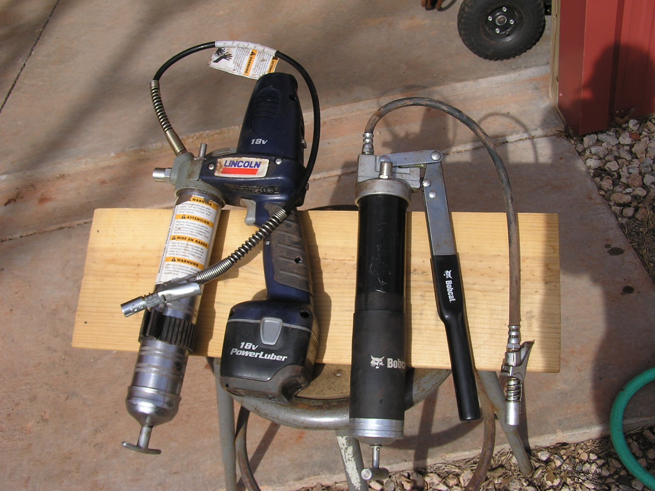

My Lock n Lubes work on everything I have except the recessed zerks on my LS loader. For them I just grab my spare standard gun and do them.
I have LnLs on my Kobalt air operated gun and 2nd on Lincoln hand operated gun. Very happy with them.
If you are happy using 2 guns, I am happy for you. :)
   / Review - LockNLube Grease Gun Coupler #84
Actually have 3 guns, you can now be absolutely ecstatic for me.
