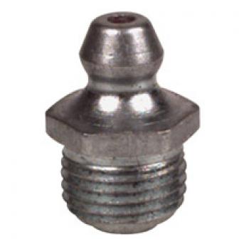

Delivered today, fit the grease gun threads perfectly. This thing actually works great! Now I only need two hands instead of three. The one negative is the lever on the LockNLube will not fit thru the 3/4" zerk access holes on my FEL. Will need to reinstall the old connection for those or buy additional gun.

Try this, go to your local auto parts store, get a zerk with the 1/8 inch pipe thread and screw it into the old connector.
Then lock the LockNLube on to it and grease the recessed zerks! :thumbsup:
Okay I see what you're saying. Don't know if that will work? Need to measure distance from access hole to recessed zerk. Thanks for the suggestion. :thumbsup:
