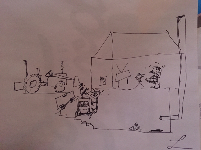

A come along would be the best. If it was sucked up tight when starting between the loader and stove with the body DOWN. Then you could pull the tractor over the door, let the stove down, and then go inside and let the come along down while pulling the stove down. Course this would work better with a buddy.View attachment 453548
Great drawing! Especially upstairs. An exact representation of what happens at my house.

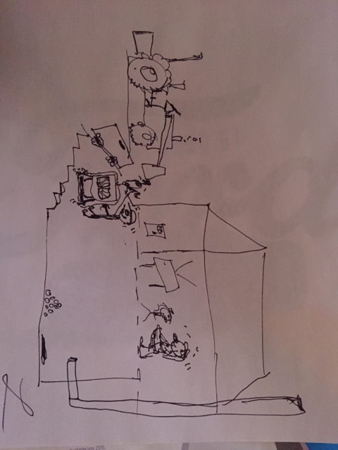

That's too funny. I had to rotate it.

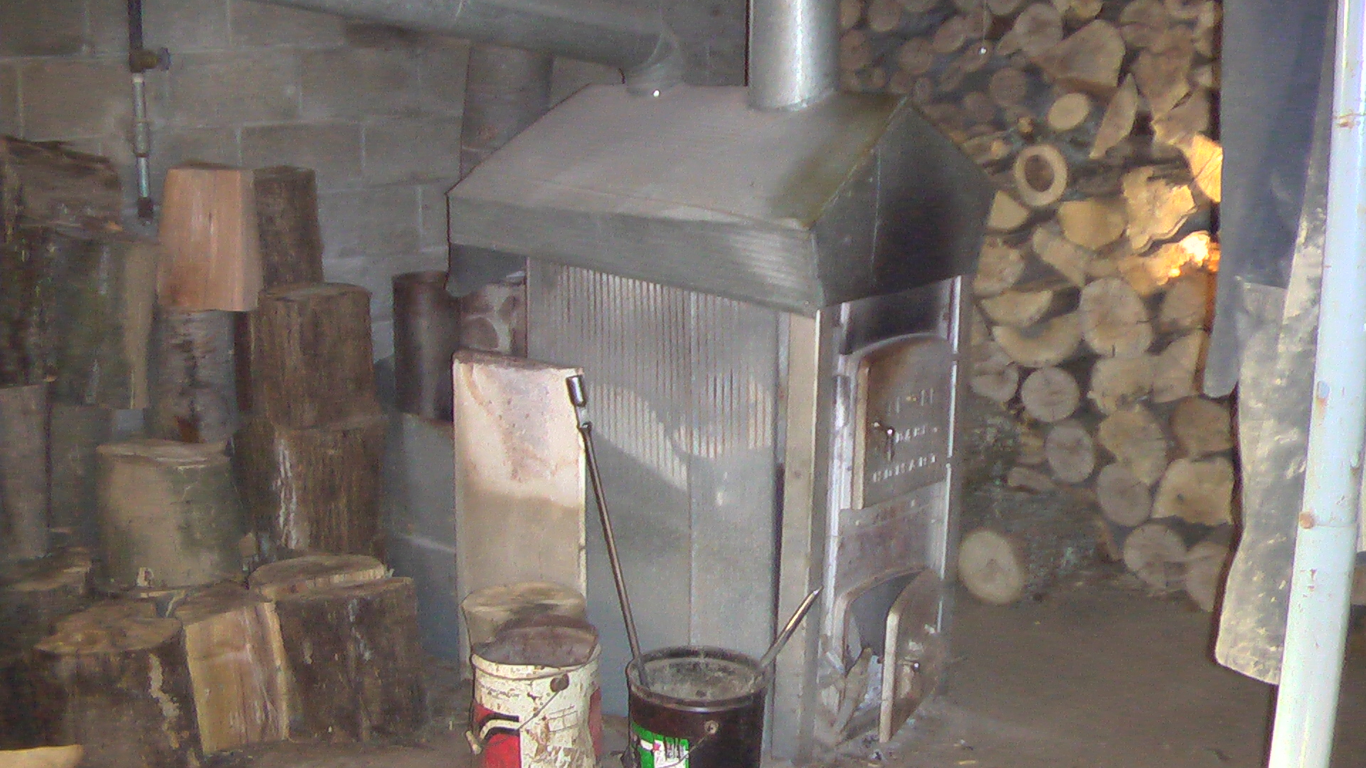

If bolted to a crate, might want to keep that on when sliding down a ramp on your steps. Wish I had pics, but my dad moved two very heavy items into his basement by sliding them down on boards, item chained to the tractor.
   / RIGGING: Moving Wood Stove into Basement #50
Here's a pic of dad's wood furnace. He build a metal heat shield around it to feed into his ductwork. Bottom is the ash cleanout, top door is the feed. you can put a pretty good size chuck of wood in it. It also will burn coal. Don't know what it weights but it is very large and very heavy.
