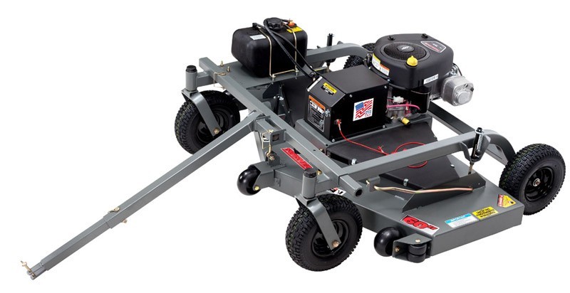

The smoothest ride would be on a UTV or ATV pulling a trail mower.

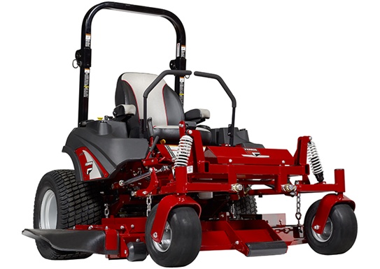

I think that some of the newer zero-turns have a suspension. That might make mowing the bumpy stuff more tolerable.
Ferris ZTRs have a reputation for their suspensions. I haven't used one, so I have no personal experience.

Patented Suspension Zero Turn Mower Models | Ferris Commercial Mowers
Suspension system consists of rear coil-over-shocks with dual cast-iron maintenance-free suspension arms (shown) and front independent adjustable coil-over-shocks.
Call your dealer, ask for a demo on your place, then you will know for sure. :thumbsup:
