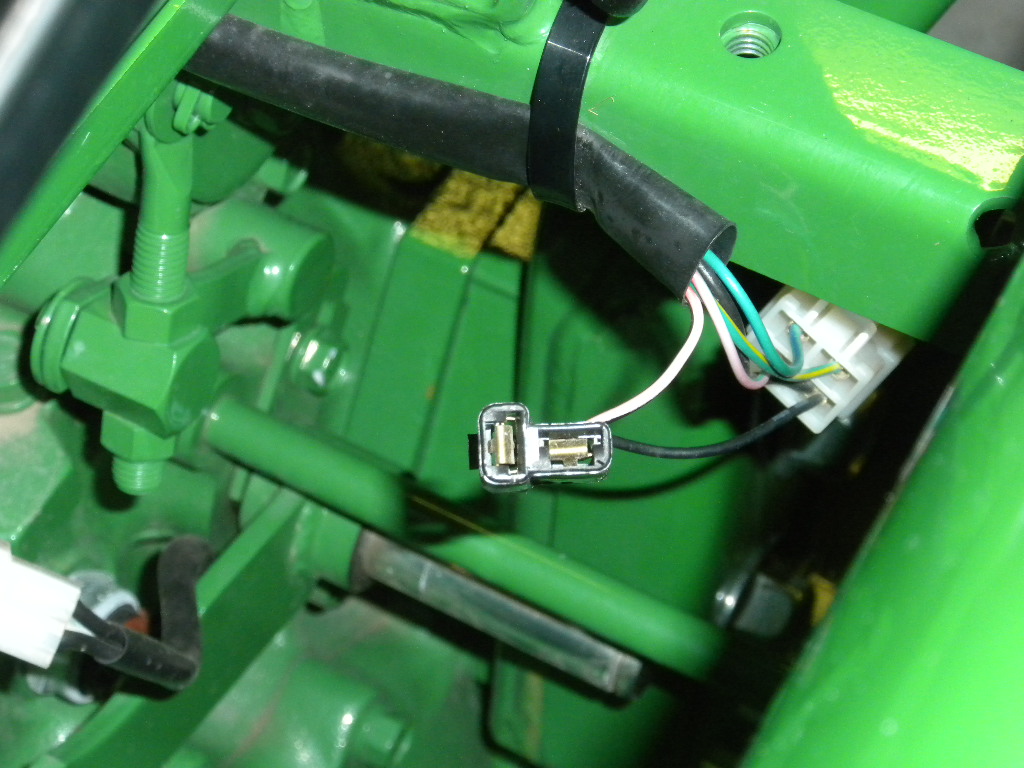

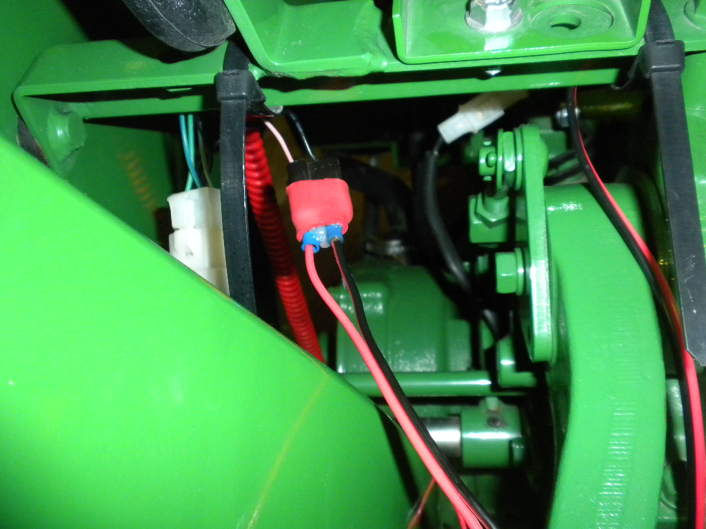

Ok a short review. First thing i noticed when i opened the box is how heavy these little lights are. They have a very high quality feel to them. I installed them to just come on when i turn on my headlights, was the main reason i wanted LED lights was low power consumption so i can run them all the time with main headlamps.
Thank you roy for the power plug recommendation. I find it hard to stomach such a nice light with waterproof connectors would come with a 4 dollar switch, thankfully i didnt need the switch, could never understand how manufactors can include a crappy switch with high end lights. So its not great but as good as any i have seen with lights.
I can tell right away that these are much brighter than the factory headlamps my guess is about 30-40% brighter and much whiter light.
There a very nice aluminum housing and look like they will last a lifetime.
Are they worth 200 bucks, well see. If they last 15 years and dont burn out my alternator than yes.
I used a dielectric grease and heat shrink tubing for the hook up and did not have to cut the factory harness.
I think i am going to buy another pair facing forward on my fiberglass canopy. When i buy one.
For now these lights look promising and i will try and get a night shot soon !
The manual is laughable. but i guess its all you need.

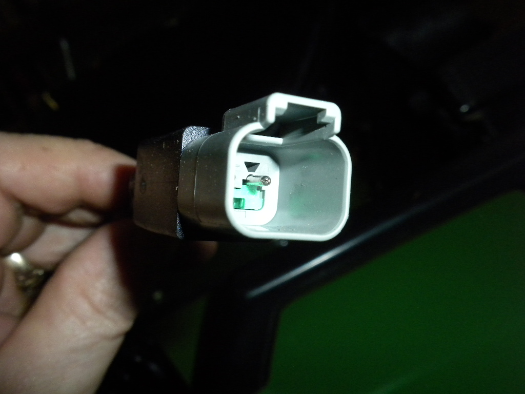

Few more pics, The watertight plugs are very nice and the connection on the lights are top notch.
