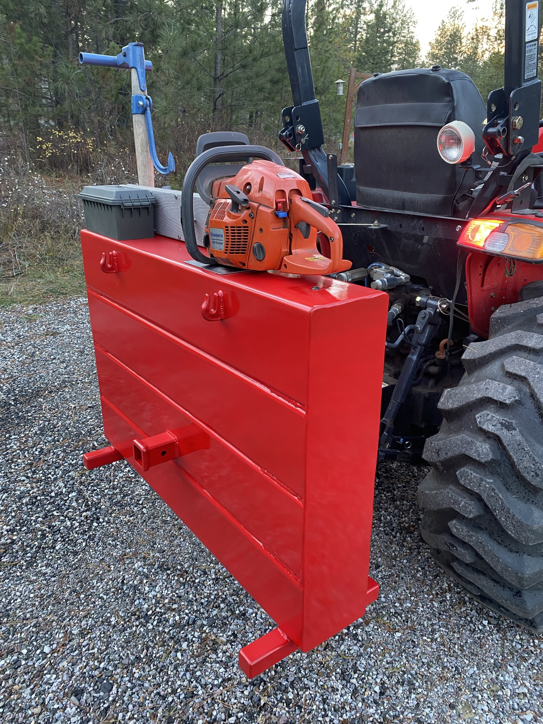

I agree, but I also agree with the OP regarding a ballast box. I have never understood why attach a ballast box instead of a useful implement. I use an implement and filled tires for ballast.
Each to their own, but a ballast box for me has less space allowing maneuvering and also has room for hauling chains, clevises, some tools, etc.
Being on a quick hitch, can be dropped quickly to exchange out for a set of forks, back blade, carry-all, chipper, rotary mower, turbo saw, and the list goes on and on.
Non of these attachments I would want hanging on my 3 ph just for a bit of weight.
But some users don't move about in the woods or in and out of buildings to get their work done.

I added liquid (W/S/W Fluid -40C rated) this past year as I had encountered a few rather tippy situations even though I had a Flail mower on the 3 pt. The only issue I have with the added weight is yes, if I am operating on softer soil (pretty hard to avoid this year due to rain) it does tend to mark up but that just means I shouldn't be there yet anyway, wait for it to dry or freeze. This year I also built myself a heavy hitch inspired weight bar and hitch configuration. This is so advantageous in the spring and winter (flail is stored) for the tighter turning conditions I typically encounter around the wood yard area. Once I am into the mowing season, on goes the flail and stays there until pretty much snow season. I also run cast weights on the wheels - my total weight is approx 3600 lbs - it is less of a bothersome sum because of the increased stability for the ton of grapple work I do (not just moving brush - a ton of pulling out brush and root as well)
From my personal experience, there can be no such thing as too much weight, but you can all too easily have insufficient ballast and find yourself in a bad spot. Cheers

I have a Heavy Hitch with about 250lbs of suitcase weights, so ~300lbs total, and since it functions as a hitch I guess it's a degree more functional than a ballast box. To remove it I can easily lift each suitcase weight off and then the hitch itself, so that's handy. The HH wasn't cheap, but it does seem to be made very well, and as you mentioned it's compact - good counterweight and I almost forget it's back there.
I recently got a heavy duty Heavy Hitch stand for my hitch. Unless you are able to unload the weights as Pleease suggests, when removed the loaded hitch is unsteady even with weights on inner and outer racks. I have grandkids around. And my homemade 2x4 stand was inadequate.
It seems like yesterday I was taking off and putting on 70 lb weights. Now my 41 lb weights are a trial. Well, I can take them off and put them on fine but the next day I'm likely to be in pain. I've about worn out my back.
One advantage I can see with a weight box is greater stability when it's off the tractor. Some, I've noticed taper at the bottom, however. Probably still less likely to fall over than a Heavy Hitch, but I'd be cautious.
