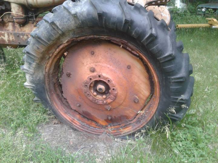

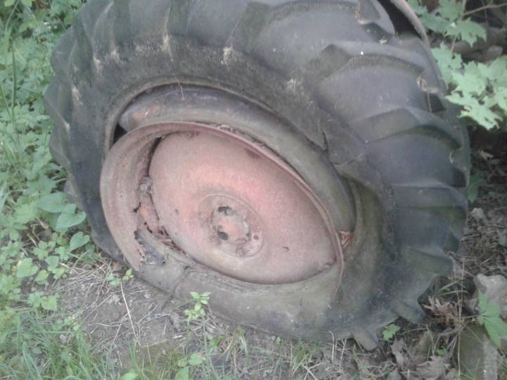

But you cannot safely lift the full weight capacity of your FEL without counterweight.
That is why the loader mounts are bolted on to the center of the tractor, the center bears the weight. It is not a teeter totter. Don't lift more than the loader is rated for, you will never have an issue.
If I need weight, cast iron wheel weights will be added, tires will never be loaded.
