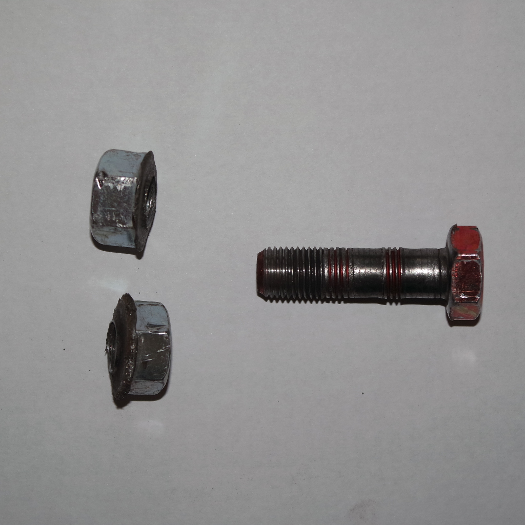

The cap screw is M14x1.5x50mm, grade 8.8. That's 'as delivered' from the factory.
The first time this happened the rim-to-flange connections were ripped apart. This time I was alert to the problem and found it when the cap screws had worked a bit loose. The holes in the rim-to-flange connections appear to be unaffected.
I'm going ahead with new hardware and careful torquing, checking every use.

Those fasteners are "hammered! No muy bueno!
The "problem" is obvious. The fasteners were not always tight.
Observe the damaged threaded region of the bolt. Positive indication that the clamping force had slackened, and the two surfaces worked against the the bolt . That should never happen in a wheel flange.
