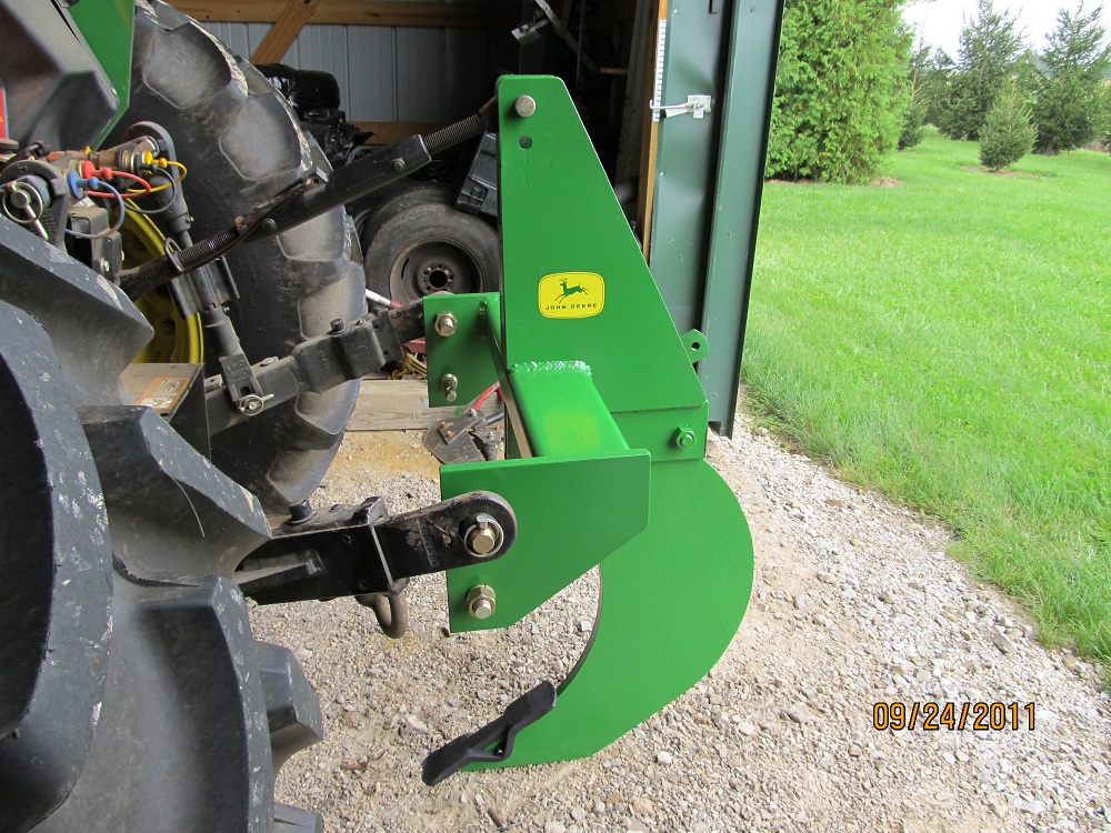

Is there a company that makes a single point ripper that will work on a 100 hp tractor? It has a class two three point hitch.

This question was asked a few years back on Tractorbynet. Here was one of the solutions: deere disk ripper.JPG
http://www.tractorbynet.com/forums/attachments/219879-scored-one-shank-ripper-subsoiler-2.html

We sell most of the above Tufline subsoilers with cat 2 setup. I used one for years on a 120HP 8000 Ford. Ken Sweet
I have this one and tug on it with almost 100 hp in 4WD and 1500 lbs of added weight. It will go maybe 18 inches but I stop at 12".
Mine has two sets of hitch pins so I can use it on my cat I 50 hp Kubota as well. These things are beasts and weigh well over 200 lbs.
This is the one you want and I'll bet it could be drop shipped to save $$.
EDIT--Whoa--that's a picture of mine in the above post. Pardon the dastardly act of painting it green but it's the only paint I could readily get in acrylic enamel and I don't like yellow.
