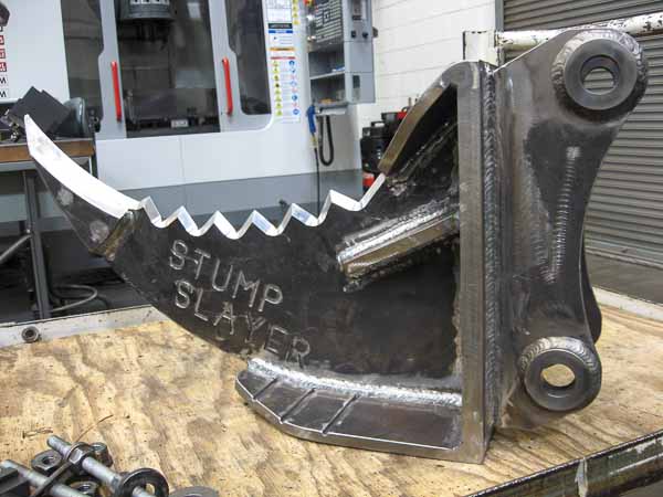

And the rest of the equipment too!

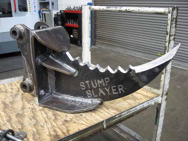

Holy crap Blue, nice fab work! Almost be a shame to get it dirty or scratch it
I have been getting a lot of feedback from fellow employees... everyone is excited about the fab. Got the final welding done and will post pics probably tomorrow. I need to see if I can get it into the sandblaster so I can clean it up and get a few coats of paint on it before inauguration day :D

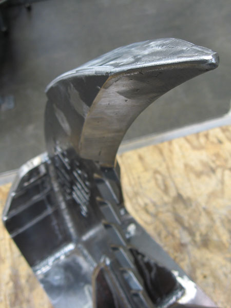

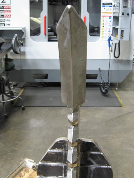

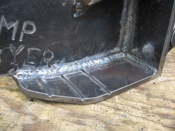

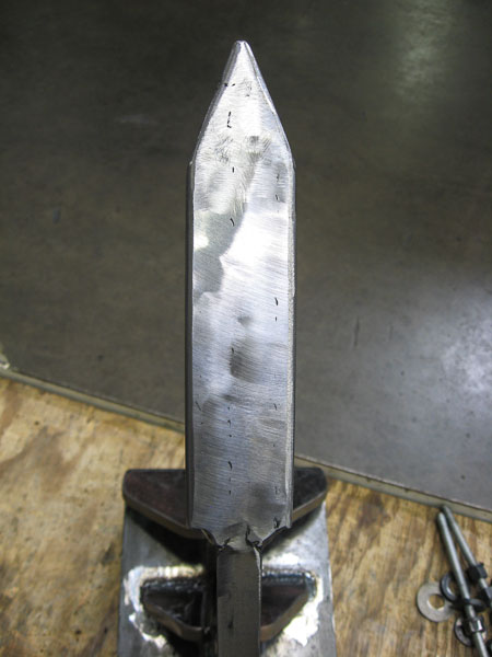

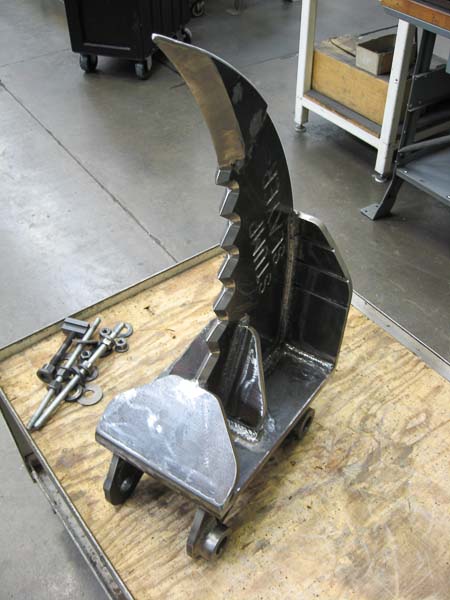

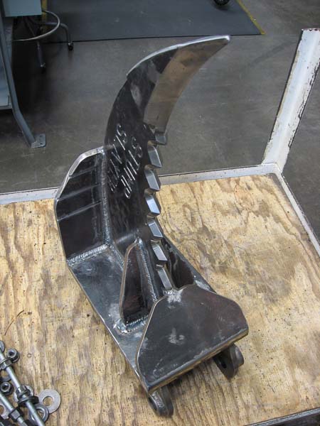

Almost complete... just have the pin bores to cut to size. Hoping to complete early this week if the machine is available for me to use after work hours. My welder friend (Ron S.) did an awesome job providing welds that will outlast not just mine but my grandkids needs! :thumbsup:
The tip came out as I had hoped with the welds filling in the chamfers I had provided (I was a bit concerned about this ). I was hoping to put some "hardface" welds on the tip & cut edge prior to the first use... but it looks like that may have to wait until later, unless I can find a local source for a small quantity of rod (I don't need 10lbs, the good stuff is pricey!)

I was wondering if you have a finished weight of your stump slayer? It looks good, but heavy to move around...
