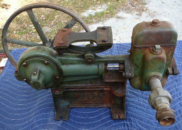

/ river pump suggestions ? #12
Since you don't need a lot of volumm, I think a very low HP piston pump would work very well. I have posted a picture of a pump similiar to what we used to pump water about 1/4 mile. We didn't have as high head pressure as you report but the old pump was bullet proof. Ours was run with a 1/4 or 1/3 HP electric motor. It could be run on a timer or a float swith in your stock tank. I looked on the internet and couldn't find anything as simple/primitive other than 2 like the one in the picture. Both are/were listed on E-Bay.
