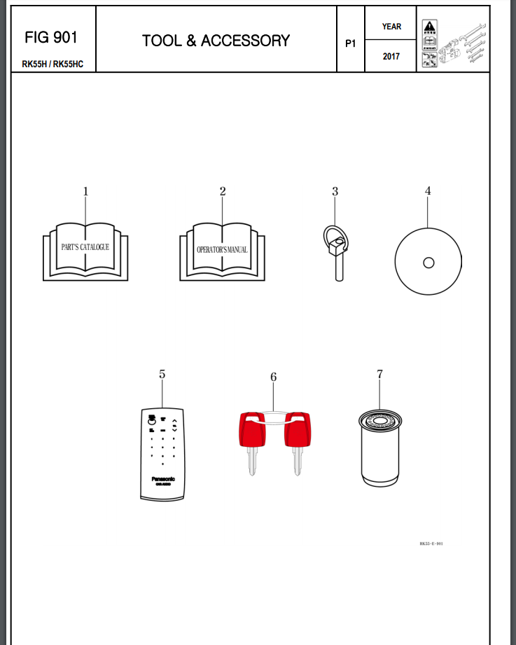

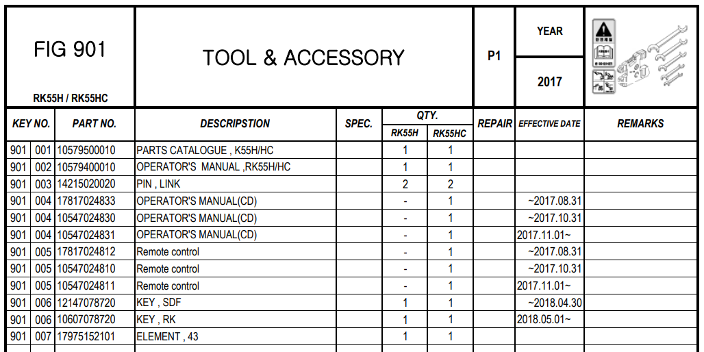

You should have received a free hydraulic filter with your purchase (PN 17975152101 which is RK SKU 212160528) . You didn't?
   / RK 55HC 50 hour service #6
g8erh8er, I haven't heard anyone mention getting anything free. I know I didn't.
   / RK 55HC 50 hour service #7
Don - Figure 901 in the parts manual is what you should have received when you purchased your tractor, at least it's what I got back in December of 2018 with my RK55HC.
See pic below for reference. It was a pleasant surprise for me considering that is the more expensive of the two hydro filters.
   / RK 55HC 50 hour service #8
Wow, that's pretty cool g8erh8er. I looked at my parts manual and the RK37's don't come with that or the manual on CD.
   / RK 55HC 50 hour service #9
Oh sorry for the confusion Don, I forgot you have the RK37. To be honest I couldn't tell you whether or not I got a CD. Everything's still sitting in the box untouched except for the keys and owner's manual.
   / RK 55HC 50 hour service #10
Just purchased an RK55H. It came with an owners manual which is not very accurate, 2 keys and the hydraulic filter but no parts manual, cd or remote.
what is the remote for? I have not gone back yet for the oil or fuel filter but RK is not listed on oil manufactures sites.
When the manual tells me to use 90W gear oil in the transmission it makes me question the accuracy of everything.
