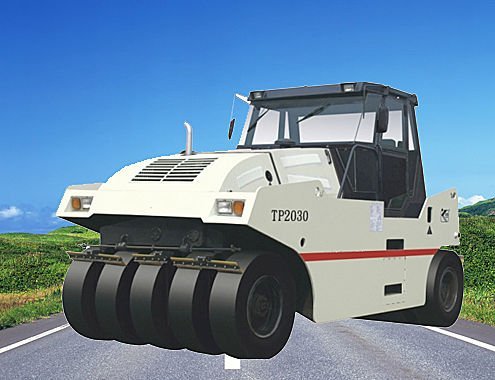

There is always discussion about driving over gravel to provide better compaction than a steel drum roller, but I haven't seen anyone build a compact-tractor-sized tire roller. Any reason for this? Every farm auction I've been to has a mountain of old tires, and you could foam or concrete fill the tires, so they don't even need to hold air. Anyone try it?
-rus-
:confused:
