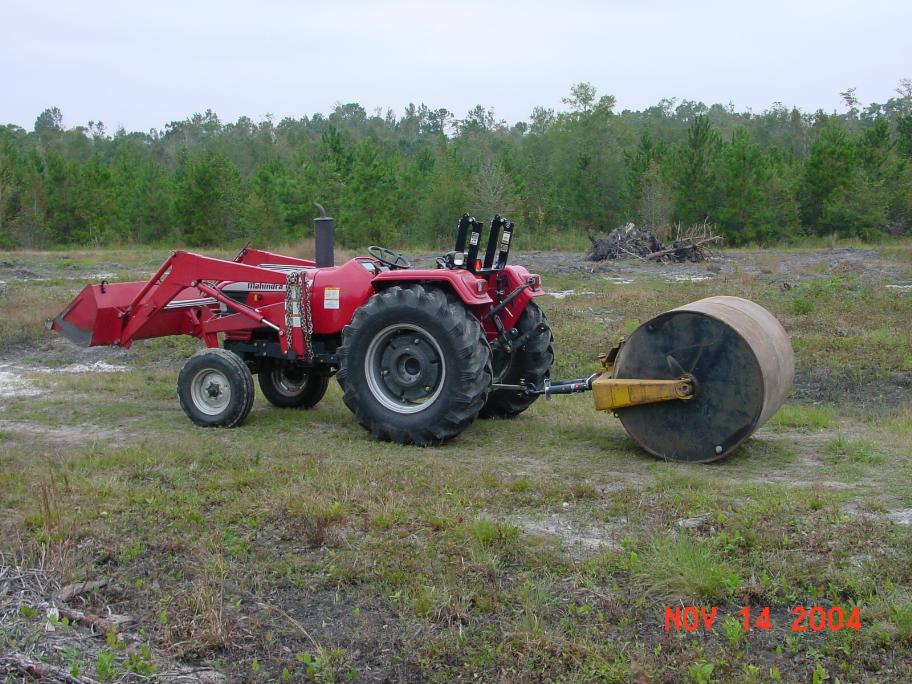

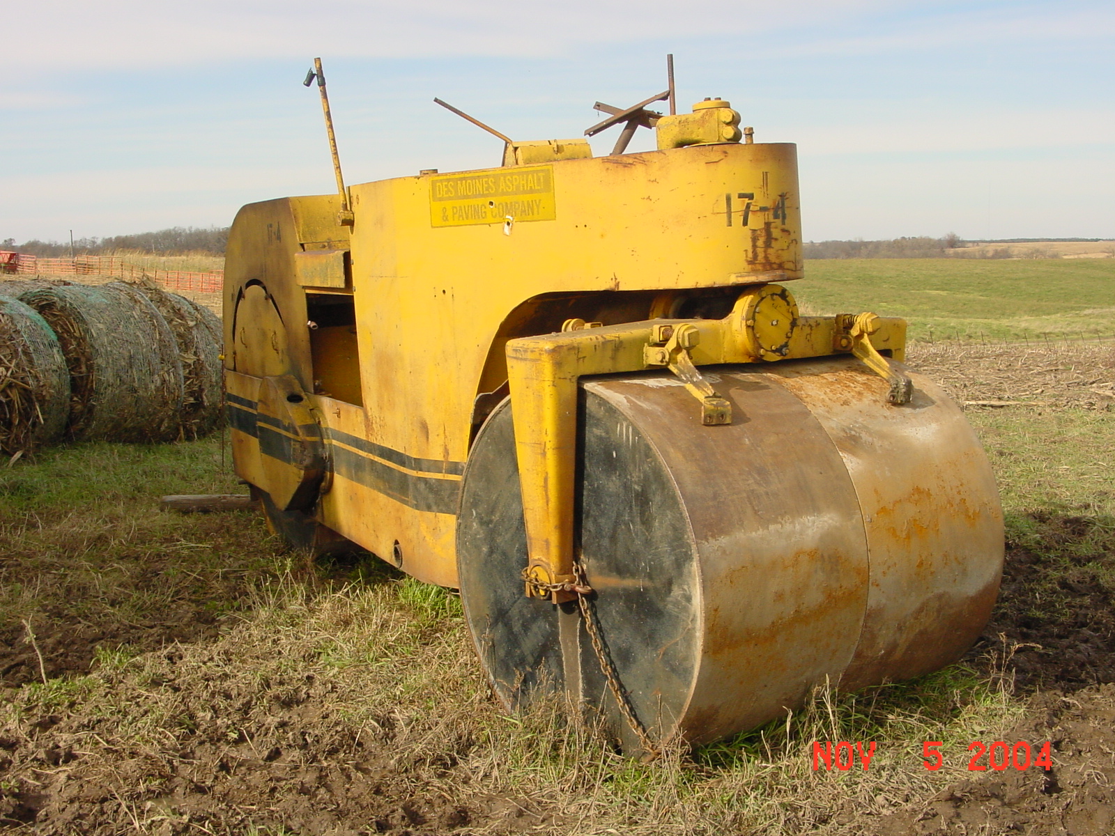

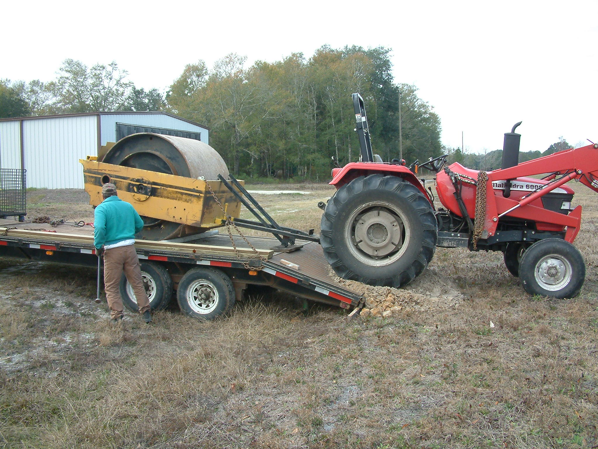

About 5 yrs ago I was looking for a roller and started watching Ebay. After 6 months, I bid on one that was only located 100 miles from my parents farm and got it for $100. Of course, it cost me $400 to transport it to my parents farm. I dismantled and removed the front roller and welded on a lunette pin hitch. The following year I cut off the back end of the roller and using an old cornpicker frame my father had, made a hitch for the larger rear roller. I then turned around and sold the remaining hulk (center portion and engine) for scrap for $100.

I was given a home made roler. 20 in pipe welded ends with car front spindles welded on and pipe frame for the pull type hitch. I don't know how he did it but it is filed with cement. I had fun getting it the 3 miles home. It,s 8 ft wide I just hooked it to the back of my truck and went slow. It is too wide to do a good job on the road with the crown but it works it would be better if it were only 4 or 5 ft wide. hope this helps.

Thanks Wolfpack, the smaller version is the kind of implement I am looking for.
