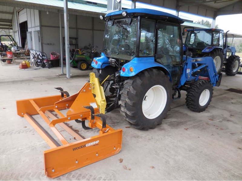

We bought the Woods GSM84P with scarifiers. Tractor is an LS XR4046HC so, 46 HP. The LS pulls it well and will be even better once I get my new Top N' Tilt Cylinders from Brian at Fit-Rite.
I highly recommend getting one with scarifiers, they really bust up hard packed gravel well. I last used the grader with only two middle scarifiers down to see if I could tear up the grass in middle of our long driveway. So far, so good but will have to wait until spring to see how successful I was.
