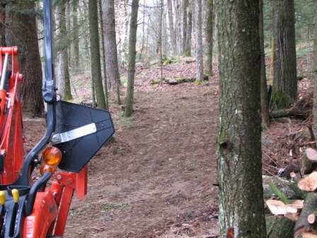

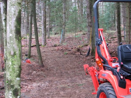

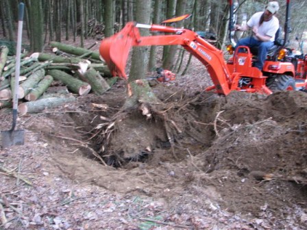

Well , I finally finished about 1,500 feet of road throught the woods around pasture. Many many stumps had to be removed as I navigated my way through. Took quite a while and I learned a lot of patience is required, But BX25 did fine even on hilly terrain.
Pics show steepest part of the grade at the beginning of road up the hill. Once the road reaches the top it turns and begins winding along pasture perimeter.
Road will serve a dual purpose, Will be used to collect sap for maple syrup, as well as porting barn waste to a designated compost pile without having to constantly run through the pasture tearing it up.
Best compliments I received were from visitors who were surprised the little BX25 was able to accomplish what it did, and also commented the finished road actually enhanced the look of the property as if it had been there all along.
Attached are a few pics , the first is the average size stump the BX25 had to tackle, and the finished road once I completed the project.

Nice work, that's a beautiful trail through the woods. I've done similar work with my BX25, and I have some more to do coming up here shortly. I have to admit a small dozer would make quicker work of it, but doing it yourself is very satisfying, and it also lets you have the time to think about how to get things just the way you want.

Not tellinya what to do but IMHO, stump removal is a LOT easier if you leave
a good 6' or better of trunk sticking up. It acts as an incredibly powerful
lever when you push or pull on it from up high my friend... Stumps will come out a LOT faster w/ that method. Then after is pulled chop that lever off! :thumbsup:
