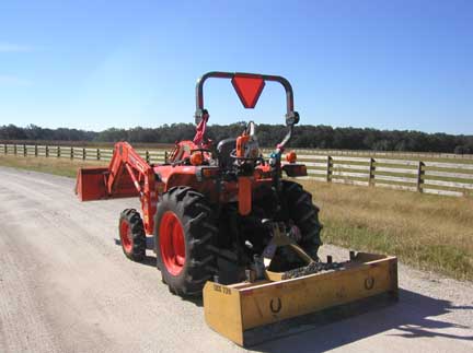

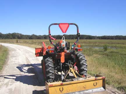

I maintain a 3.5 mile road primarily with my Kubota L-3130 GST with a BushHog 96" box blade and 3pt TNT setup on the rear end. Our road is limerock base with recycled concrete gravel on top about #57 size. Lots of rain and lots of dry heat throughout the year. The landscape rake doesn't work on our road since about 3/4 of the road is hard base capped off, only about 1/4 of it is soft due to drainage and that is the part I work the most on.
One of the main points is to NOT grade too fast. I normally grade at around 3.2-3.7 miles per hour and find that even going 4.0mph is too fast. That is about 1,500rpm in 10th gear.

That's a 96" boxblade? How does your 3130 handle it in dirt? I need to get one for my 3130 and my tires are right at 70" wide. I plan to go with a 72" box but wouldn't mind a little bigger.
   / ROAD MAINTENANCE/EQUIPMENT with PICS #28
THe 72" is fine, since it matches the FEL width, but it really doesn't weigh enough to get a good dig in. The 96" is heavier and can move much more material at a time without getting overloaded. At first, I thought the 96" would be too heavy and too large, but after using the 72" for a year or so, the last couple of years with the 96" has been much better, plus I can take off the shoulder buildup easier since the edge of the BB hangs out further outside the rear tire width. I've really had no problem at all upgrading to the 96", still have the 72" though.

Skypup, the road looks to be in excellent condition. Pretty area especially with the fence and trees in the background.
