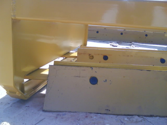

I own two graders that I purchased a couple years back at a reasonable price called Dura-Grader and there is a big difference in these graders compared to other twin blade flow through graders. The two I own both are adjustable. the cutting edge assemblies can be adjusted into six different configurations. In other words I would have had to buy six of the other brand graders ( Road boss, Grade-Master) to take the place of one of these .It is my understanding that the company I bought my graders from are the inventors of these type of graders and is the only company with patented models of graders

looks interesting, thanks for sharing this.
I looked at the website, and it seems like a bunch of the options merely recreate top n tilt - is this right?
How big a tractor do you use to run it? And how much do they run?

I wasn't sure what you meant ( top n tilt). were you talking about the hydraulic top hitch? I have two Dura-Graders. One is a 6' utility adjustable and the other is a 7' industrial adjustable with a Hydraulic top hitch. I bought two of them to where I could keep one around my ranch and the other I use for my business . I pull the 7' behind about a 80 hp Massey. The hydraulic top hitch allows me to apply down pressure to the unit ( using the rear end weight of my tractor). I have actually used the hydraulic top hitch to pick the rear end of my tractor off the ground, also it works real great for adjusting the way the unit performs while I'm grading without having to stop and adjust the top-link. The thing I like the most about the unit is the adjustments on the angles. I can adjust the angles to an angle position for grading my roads or straight for spreading dirt and gravel. I can even turn the rear cutting egde around backwards for back grading and getting close to slabs and tight places. I adjust the unit before The only thing that has wore on my unit in the past two years have been the skids and the cutting edges. I am not sure the exact amount I paid for them two years ago, but each unit was cheaper than road boss . I am not sure the exact amount I paid for them two years ago, but each unit was cheaper than roadboss
