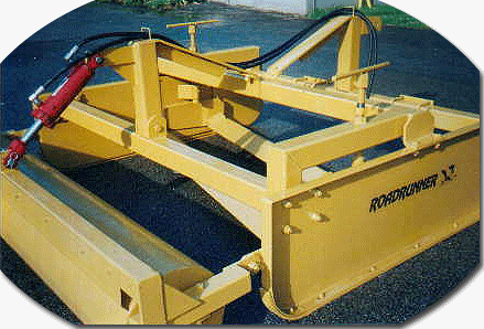

roller?
do you have a picture of this roller?????

we talked back and forth on the phone...I was pretty sure that was what I wanted. They (he) came down and I tried it out on my tractor and my drive. The deal was, he would take it away if I wasn't satisfied, but I was and it's been here ever since. If you are interested, come by and I will demonstrate ...or, you can do a little grading for me (Tom Sawyer?).
Getting it off his trailer was an event. In anticipation of attaching it to my tractor I had removed my rear mower. Big mistake. Without that counterweight on my rear, I really couldn't lift it off his trailer (but I could raise my tractor off its rear wheels) ...but we managed to slide it down his beavertail.

wow, great stuff in here, thanks everyone. Still love to see some opinions of the lightweight stuff if anyone has it.
Thanks for posting about the roadrunner Joe. Amazing how many variations of these things are out there for an implement people don't talk about often. (I'd never heard of one before MtnViewRanch put up his great posts)

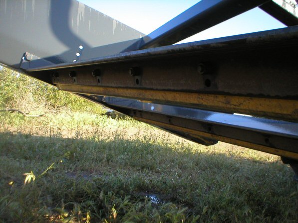

Kubota L5030 said:
Thanks MtnViewRanch,
I noticed you have the hydraulic top link. Does your grader blade or tractor also have hydraulic side tilt? And if it does, are they really necessary, or nice to have? I think my neighborhood could save a fortune if I setup my tractor and purchase a grader implement. We average $2,000 per year in payments to contractors to grade and roll. I currently do not have any rear hydraulic remotes, but I could add them for approximately $2,500:eek: .
Top and tilt from day one.:D I usually only use the top link with the road blade. You could use tilt to help out with making a crown, but I have not had to do that yet. I use both the top and the tilt cylinders all the time when I am using either my rear blade or my roll over box blade. I can not imagine what a pain it must be to have to make adjustments manually. My guess is that most people don't make manual adjustments frequently.

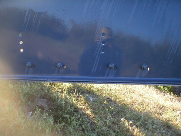

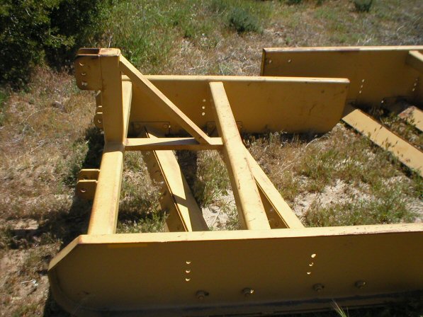

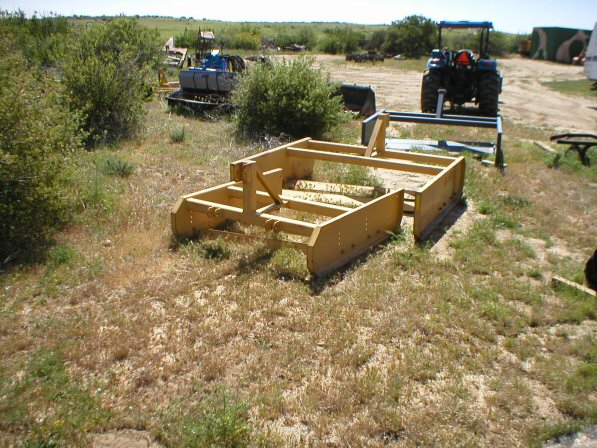

I was going through some more pictures that I had taken last weekend and I noticed a few things on my grader blade that I guess that I had never paid attention to before. There are holes on the sides so that the blades can be adjusted to cut a crown in the road I guess.:confused: And there are a whole other set of holes to lower the cutting edges after they have worn down.:D The Road Boss guy had said that his graders were the only ones to have the extra set of blade holes, guess that he was wrong.
If anybody wants a 5 foot medium duty or a 7 foot heavy duty, I have one of each.
