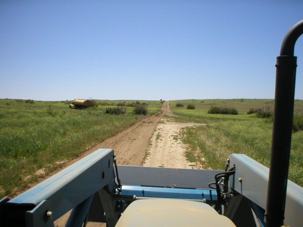

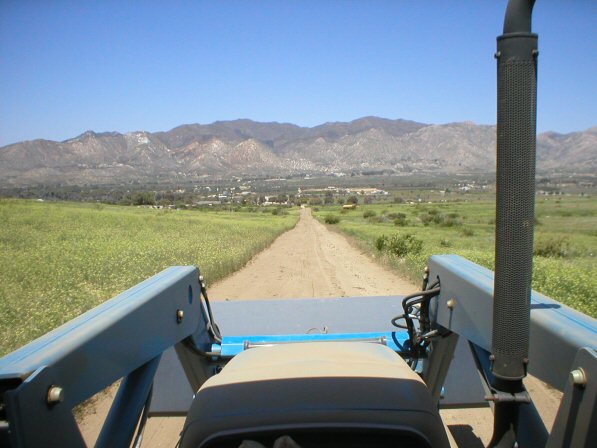

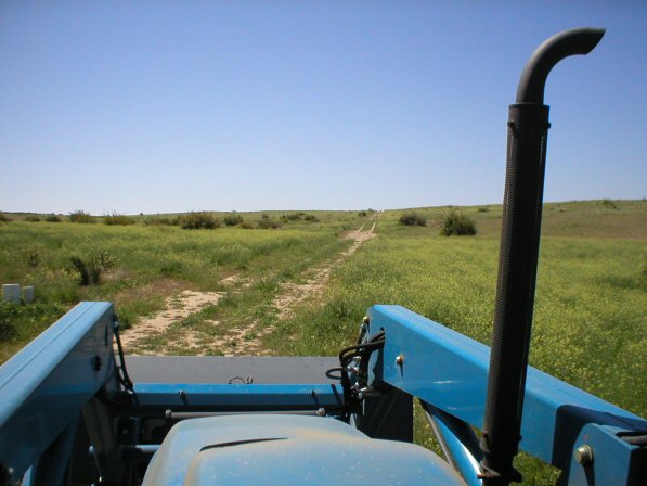

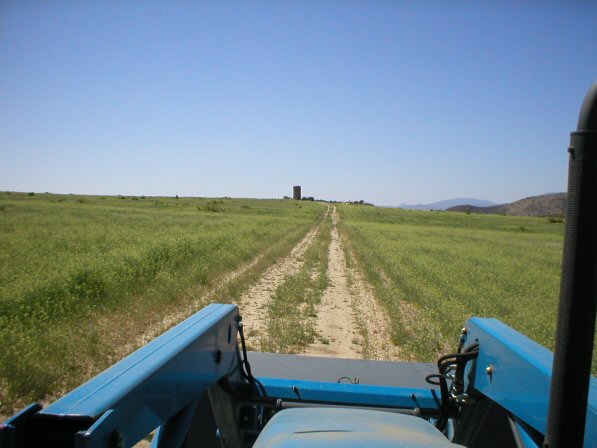

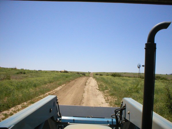

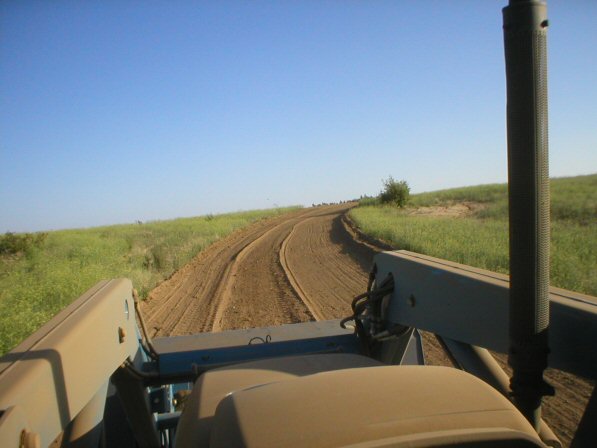

Here are some other pics of some of my roads that I worked on last weekend.
