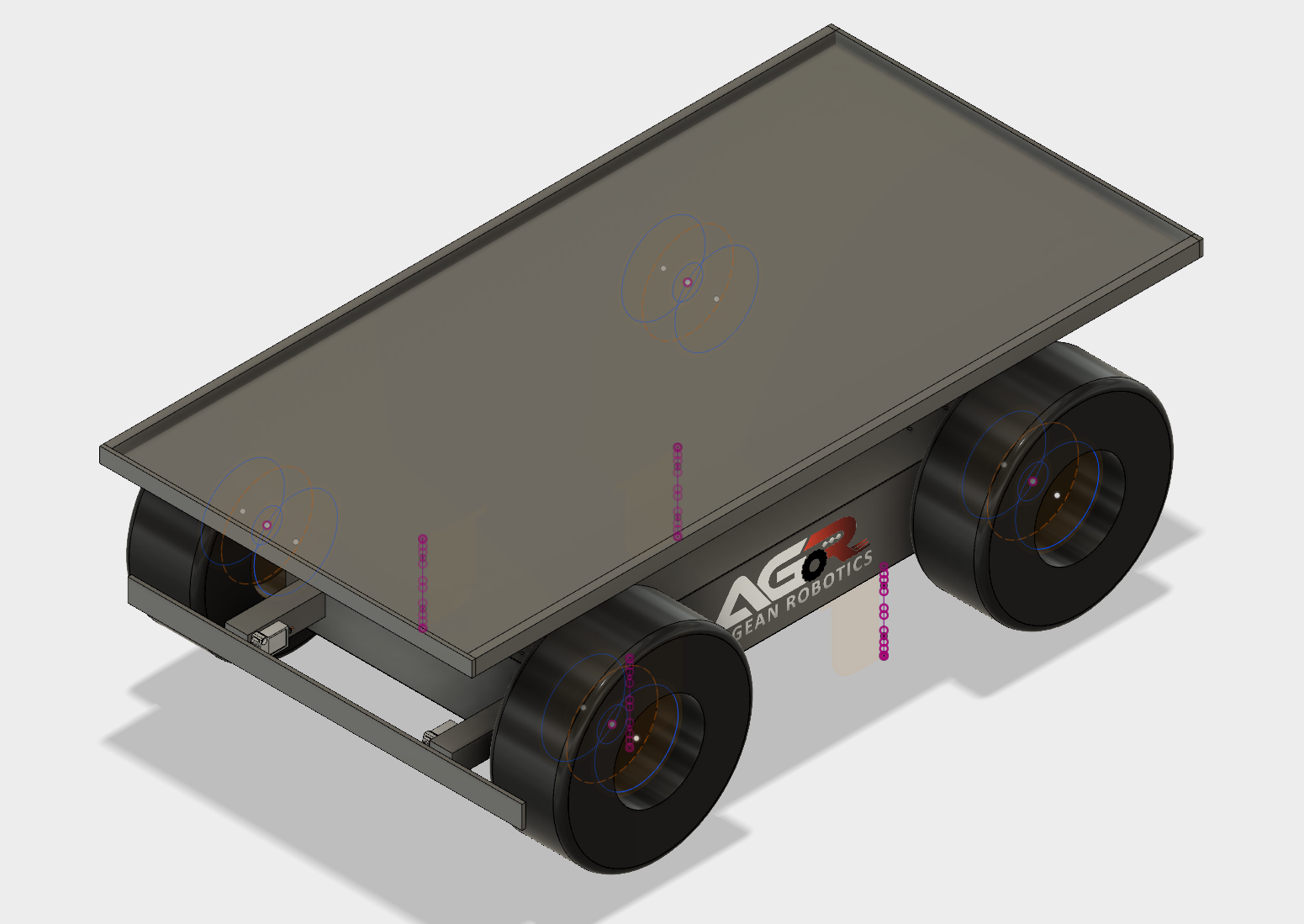

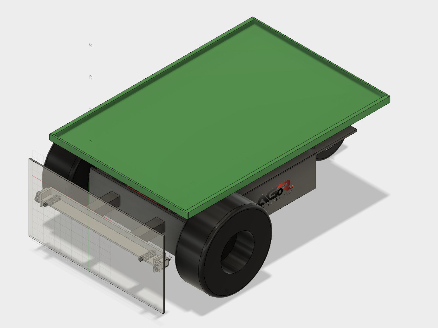

2WD with rear caster versus 4WD? What are thoughts here on the merits of each?
2WD takes us to around $5K MSRP. 4WD takes us to around $6K. That's with following, and likely with path retrace. image001.pngimage002.png
Scale is 24 inches wide, 13 inch drive wheels in both cases, 2WD we would likely run a 24 x 36 inch bed, 4WD we would aim for a 24x48 inch bed.
   / Robotic Following Cart to Replace Light Duty Tractor Tasks? #124
if this is going to be used outdoors, 4wd would eliminate many of your traction concerns, because 2wd is really only one tire drive. I doubt your little rig
will have limited slip but i would be interested in seeing the steering gear, which assuming birectional operation would be similar on both ends.
Plus 4wd allows you to offer a larger bed surface.
Indoors on hard floors no reason for 4wd usually so it would add cost unnecessarily to the product.
I'd worry about that caster getting hung with something, like a hose.

It is 100% electric drive with drive motors for each wheel, so there is not an issue with just one wheel getting power or any sort of differential.
   / Robotic Following Cart to Replace Light Duty Tractor Tasks? #127
3 or 4 tire drive is darn good. Just ask audi and subaru...electric motors with appropriate controller software actually makes this simpler. Now controller software much less radar guided software with lots of protective devices built in is not simple at all to most of us, but that seems to be what you know well.

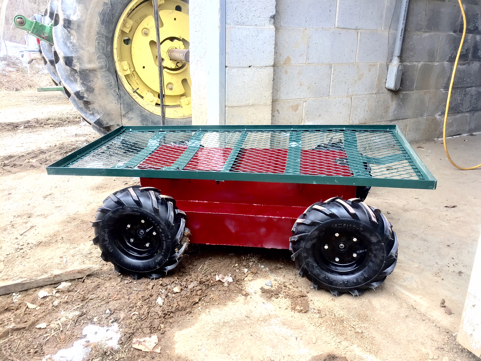

#128
4WD chassis. Still working on the coding...
   / Robotic Following Cart to Replace Light Duty Tractor Tasks? #129
If you want to quickly get something out in front of potential users I suggest you "mechanical Turk" it. That means have a human pretending to be a computer operate it. (Named in honor of an 18th century fraudulent chess playing machine -- The Turk - Wikipedia ). I don't mean that you would deceive anyone, but you would write up a list of its capabilties, and then have a human operator who is told he can only do the things on the list. Then have him work with a potential user for a few days and ask him if he feels it's useful. You'll learn a lot more in a few days than you would building and debugging prototypes and field-testing them.
It looks like you could easily fit it with a controller for an RC car. Depending on what type of computer you are using you could probably put in control over bluetooth or WIFI. As you figure out what sensors it needs you can add the sensors and tell the human operator he can only react to the sensors, not his own eyes and ears.
