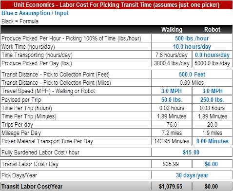

I've been thinking about this quite a bit pretty much all day off and on.... In all seriousness, if the $11K machine can outwork the $4500 machine 4:1 in the first trip, and make 10:1 trip ratio( I think it will be much higher than that), that's outworking it 40:1. If labor $$$ savings is the goal, put it to a spreadsheet. It doesn't pan out. You'd need many, many of those $4500 machines to keep up with one $11,000 machine (really $11,450 with the large light material bucket, plus shipping).
One person picking fruit as an example...
Let's say they can pick fruit and fill a cart sized container in 6 minutes. That's 10 containers per hour. They dump it in the box on the auto cart. It leaves to make the 1/4 mile round trip to the barn and back. The picker continues to pick while its gone. It comes back, he dumps his box on it, it takes off again, etc...
How fast does the auto cart travel? Lets say 3mph, as that's an average person's walking speed. There's 12 quarter miles in three miles, so it can make say 10 trips if you account for dump and load times. That works out well for our example, as the container on it is sized to keep up with one fruit picker person (if the distance averages out to 1/4 mile trips. Short distance works out better, longer distances, not so good).
As mentioned, it can only work for 5 miles. It'll be dead in 20 trips. That's about two hours of work. You'd need 4 auto carts to keep up with one person picking fruit for 8 hours, or 4 battery packs, or a quick charger that can charge it before the shift is over, etc... If you need 4, that's $18,000 for auto carts to keep up with one picker that gets paid only $300 per week working 40 hours for $7.50 an hour.
The picker could load crates in the field and deliver them to the barn himself much faster and cheaper with a tractor. Even if you had enough work to keep the picker busy for 4-5 weeks, that's only $1500 at most. Even if you had continuous crops and enough work to keep a guy busy all summer/fall, its not going to save enough labor to pay for itself because its small and slow.
And another thing to consider. Let's say the guy walks out from the barn to the first tree and the auto cart learns the route. It leaves and comes back to where? The guy has moved to another tree. He'll have to go and get it each time it comes back. That's the same distance spent walking as it would be to a crate set in the field every few trees. So no labor saving there at all.
Look, I'm being hyper critical of course. Just giving you some things to think about. I hope you can make a go of it. It sounds really interesting and poses a whole slew of problems to resolve. Keep working on it and keep updating us and good luck. :thumbsup:
MossRoad, below are the unit economics I was thinking. Apples might be a bad use case, but in certain crops, if we assume the average worker can pick 500 pounds of produce an hour, and then has to travel 500 feet to a collection point over a 10 hour day, that equates to 76 500 foot trips over a 10 hour day, or about 143 minutes walking per day. Assuming 30 days picking per year, that's around $1,080 dollars in labor.
Are there any crops where those types of economics exist (thinking Lettuce, grapes, other items where there is a lot of picking and then shuttling stuff, but also not a ton of weight concentration like apples where you may thus go to big material handling equipment as mentioned by posters previously)? Thinking things like this perhaps: JERoss_Assignments16.jpg
