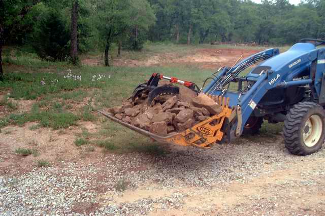

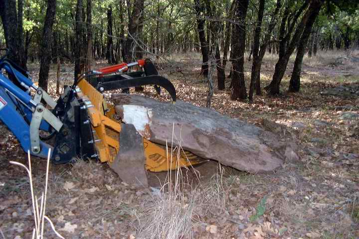

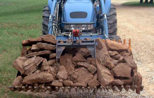

Dan, I'm firmly on the 'team' with Steve when he says using a rock bucket is really hard on hydraulics and the loader. The rock bucket you are considering is going to work only for softball/grapefruit sized rocks that can be picked up in loose soil. Even then, the solid cutting edge at the front of the tines is going to be a hindrance to picking up stones. It will collect and push a solid ridge of dirt that will tumble the rocks forward in front of the bucket until you have a mound of material big enough so that the blade undercuts the mound. Any kind of irregular surface will compound the difficulty. Unless you have a flat plowed field with dry sandy loam soil and baseball sized rocks on the surface, I'd look for another rock bucket. You just cannot use a rock bucket like a regular loader bucket. You HAVE to think of the rock bucket in terms of one or two rocks at a time that get collected in a basket.
Rock buckets like the Bradco have pointed tines for digging under imbedded rocks. They also have a "basket" behind the tines so that you can keep rocks from rolling out of the bucket while you tilt the tines downward enough to undercut more rocks. Unless I have a pile of rocks, I almost never get my rock bucket anymore than 1/4 full before transporting and dumping its contents. The size of the bucket just allows you to repeatedly curl the bucket and have the rocks roll around and shed dirt. Think of it like putting a shovel full of gravel and sand into a sieve and then shaking the sieve to let the sand drop through. It's completely different from handling dirt with a loader bucket. Because of that, I have rock bucket that's 60" wide and I'd be plenty happy if it were actually 48" wide or less. The extra depth of the buckets is also a big advantage. You can easily see the tips of your tines for the best placement under rocks to pry them up. The only advantage to a larger/wider rock bucket is to be able to handle boulders.
Its your decision, but based on my experience, I would not recommend the bucket you are thinking about. I believe you'll be frustrated with it as a rock bucket. With an added grapple, it would make a great brush/cleanup bucket, but I don't see it being a good rock bucket except for the most limited conditions.
EDIT: Don't be fooled by photos like my attachments. It looks like the rock bucket is a great tool in those photos, but the truth is that I loaded 1/3 of the bucket with the tractor and the rest of them I hand loaded. If someone shows you pictures like this and says they loaded the rock bucket using only the tractor, ask them what turnip truck they think you fell off of.:D

Thank you very much, this is the kind of information that I have been searching for! What tractor is pictured here and what is its horsepower and weight? I was going with the 72" bucket simply because I wanted to use the QA on my Kubota MX5100. Kubota uses a skid steer type QA on this series and I can use a smaller bucket if it will allow enough space to utilize the QA. I assume Bradco or anyone else for that matter can accommodate this setup. I am off to check out their website now.

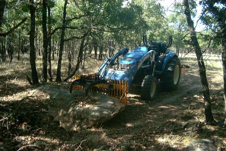

Dan, my tractor is a 45 hp New Holland with HST transmission. I don't think Bradco makes a 60" rock bucket like mine. My bucket with QA adapter and grapple weighs about 700 lb. I can lift about a half-ton of rocks or less. The grapple thumb is especially useful for large rocks where I can clamp down on them with the thumb and curl up to transport. Many large flat rocks are so big that they don't fit well in my bucket.

It sounds like we have similar issues and tractors. I checked with Everything attachments and Iowa Farm Equipment Sales (They also sell the Bradco among other brands.) The 66' Bradco should fit my Kubota QA system perfectly. I use my loader bucket (HD round back) to flip the big flat rocks end-over-end until I can access them with my dump trailer. I then raise the bed until its maximum and then flip the rock onto it, lowering the trailer and pushing the rock onto it with the loader simultaneously. It works pretty well that way and I have loaded rocks as heavy as 3,000 + pounds. I use these rocks to line steep banks in the creeks and cuts I have made for driveways and then plant ground cover such as phlox between the rocks. Works well to hold backs and looks pretty good once it's all completed. Have you used your rock bucket for much brush work?
