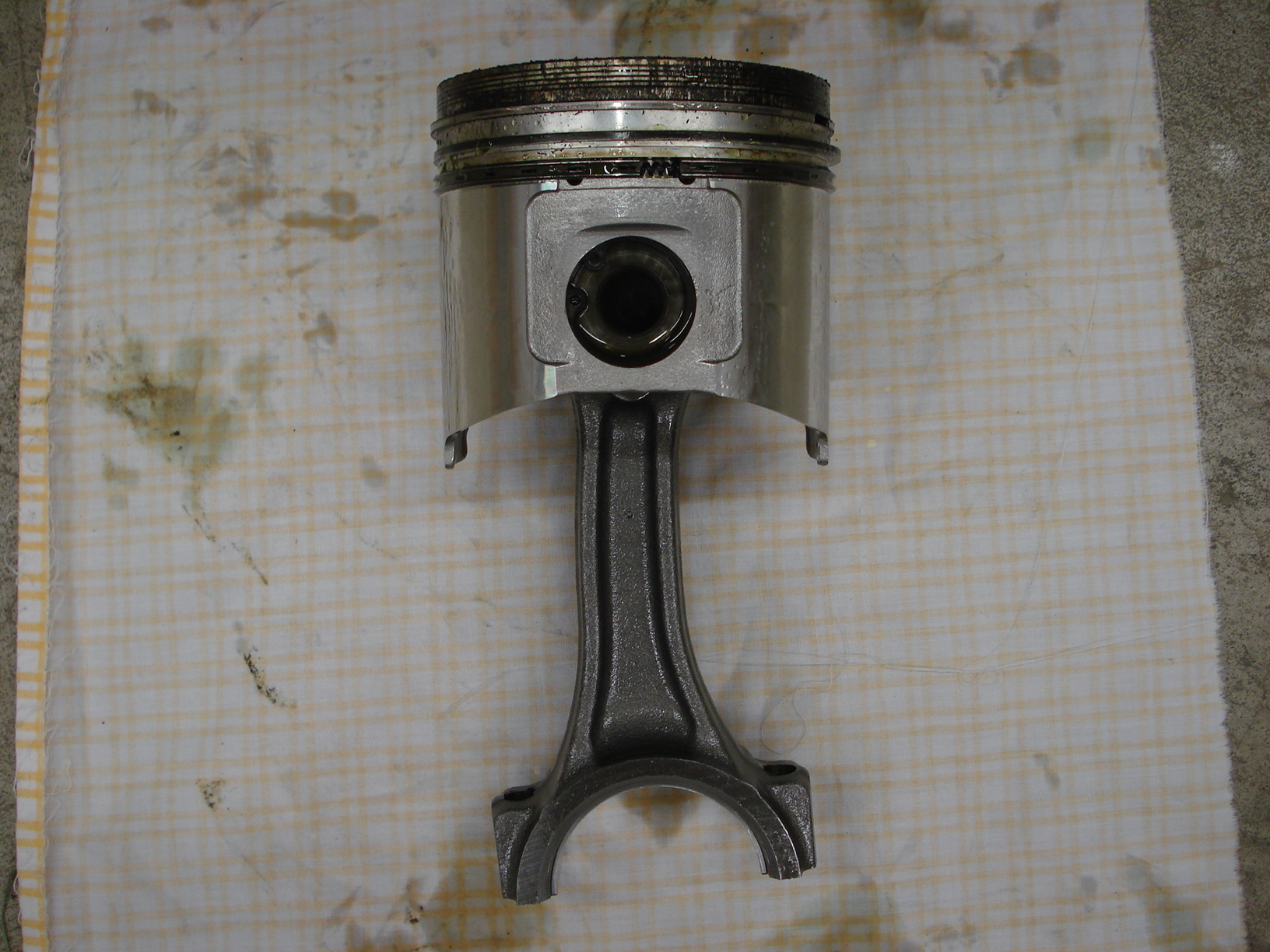

Hi all. Finally a break in the work schedule so now back to the tractor. First a couple of updates on past challenges: bought the compression tester for diesel motors but lacked the adapter for the 3TN motor so that is a bust but did find a 3TN service manual on the Internet.
The #2 connecting rod is bent. Several of you experts were confident of a rod being bent and you were correct. My humble apologies for skirting around and being hopeful of a simple fix. After pulling the cylinder head and hand rotating the motor it was obvious #2 piston was lower than the other 2. The dial indicator validated it was in fact .070" lower. Pulled the piston and found the rod has a distinct bend in it. I will order the parts Tuesday (a rod is $225 and the head gasket $105) and put back together next weekend. Fortunately I could get to the rod cap through the small access plate on the pan so I did not have to break the tractor in half.

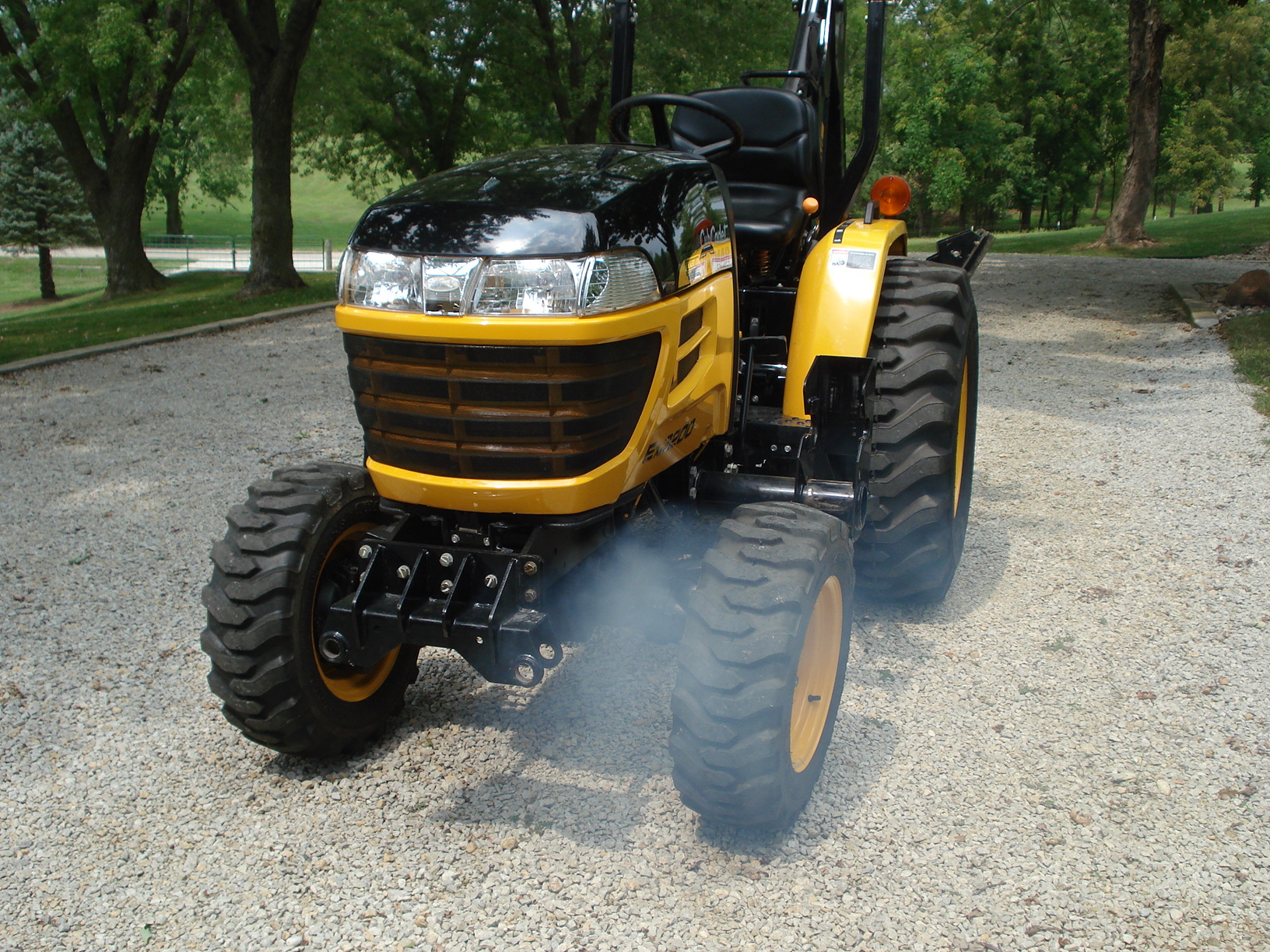

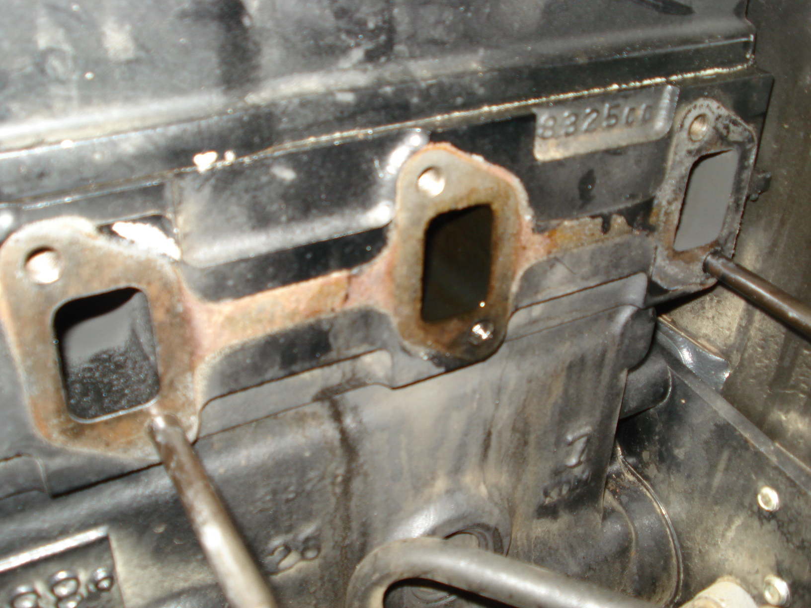

Hi all. A quick update on the EX3200. Installed the new connecting rod and reassembled the engine on Friday night. Saturday morning I was SAFELY moving dirt again. Here are 3 pictures to show the smoking tractor, the #2 exhaust port and the bent connecting rod. Thanks to all for your help!

Thanks for the update. Yeah that's bent alright. Good job on sticking with it and getting it fixed. I've also learned a lot on this thread.
