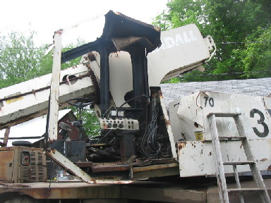

never a lot of problems as far as cracks or brake in the frame etc. just the electrics wern't real good if I get the chance tomorrow I will check with my friend that is one of the service reps for gradall and see what he says about parts and such do know that cylinders and hoses also most of the conrtol valves are not a problem as they were off the shelf items they used onsome other machines as I said just the electrial was a bear to be polite

yea my boss said that they had some issues with the controls, but he made it sound like 90 percent of them were in the contact rings where it rotated around, he said at the begining of the season they would open them up and clean them and that usualy took care of it but i would be interested to know anything about them that i can

We encounterd a few stuck electrc/hyd solenoids that were froze up.. emory paper fixe dthat..
I'd have to agree with the other poster.. bulk of our problems were electrical... nothing big.. just nuisance stuff.

little stuff like taht aint so bad for a backyard machine, i just dont wanna get into major expensive parts. but like i said it was free so i can take some frustration and nusance in exchange for that

well i got the badly crushed parts of the cab partly cutaway and the controls and electrical panel unbolted so i can work around them.
