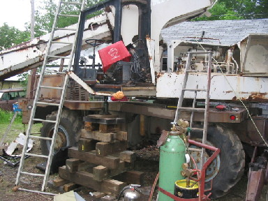

next came straightening the frame that the cab sits on, i stacked up some cribbing and pushed up on the frame with a hydraulic jack and heated it, i got it pushed back to straight but then it came back more than i expected as it cooled so tommorow i will heat and push it a bit further

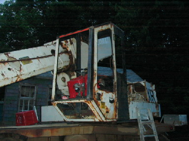

well the cab is comin along pretty well, got it all framed up and most of the sheetmetal on as well as straightened the original door which had a big bend in it. basicly i just have to finish the back wall of the cab and the metalwork will be done, then its on to fixing the gauges and wiring panel

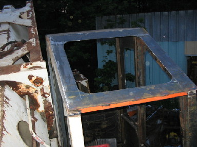

heres one of the top front of the cab
