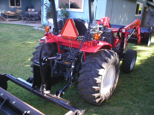

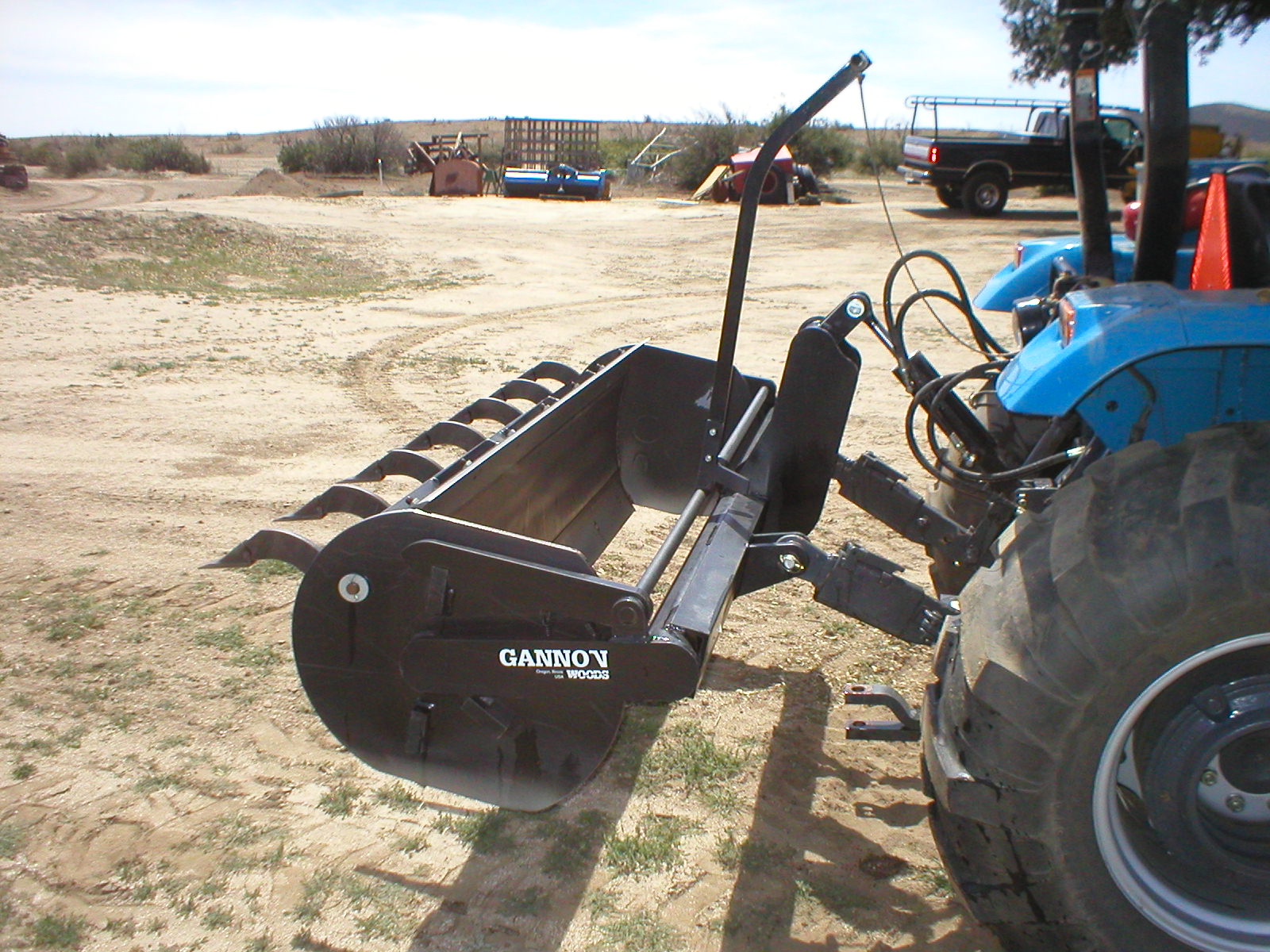

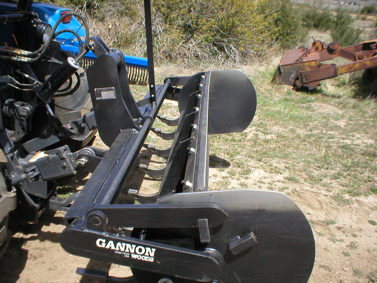

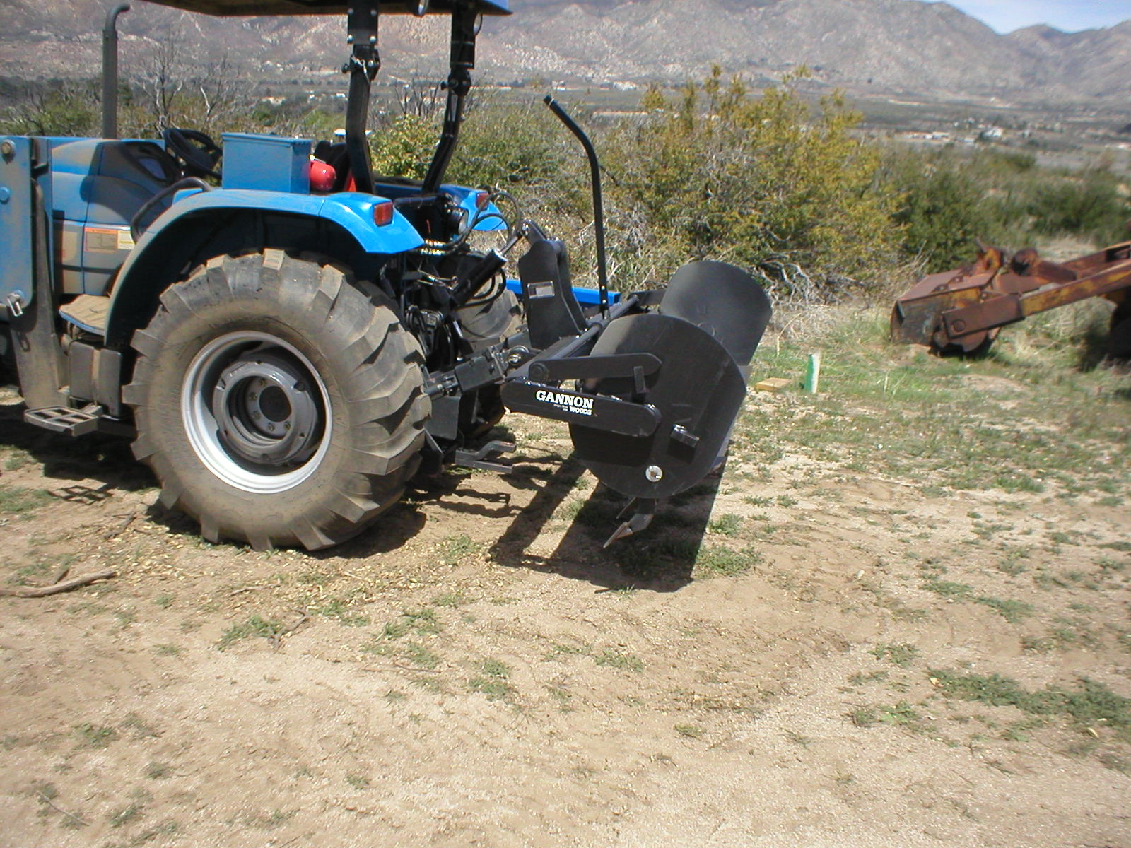

Well, if you mean a gadget that Gannon built for 60 years, than yes it just ended up not working out. :rolleyes: I happen to have 3 of them, a 36", a 65" and an 81".
Gannon-Woods discontinued them when they shut down the facility in California in 2007 I think it was, maybe 2008. Anyway, here are the units that I currently recommend. They are a bit heavier than the Dirt Dog & Bush Hog units.
Oh, they are called a roll over box blade, or ROBB for short.

Very descriptive pictures Brian

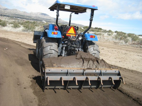

A couple of things that make them in my opinion better than a std box blade. You can change the use of the ROBB without ever getting off of the tractor and the rippers of the 65"& 81" units can go into the ground 10". To the best of my knowledge, no other box blade, not even the hydraulic actuated boxes will put the rippers that far in the ground. The top link really does not ever need to be adjusted once you have it set. With all the std, hyd included have to have the top link constantly adjusted, so you best have a hydraulic top link or you will be getting on-off the tractor a lot.
STD boxes have to have the rippers dropped down one at a time. A lot of people set them for shallow digging and tilt the box back and forth to engage and disengage the rippers. While this sort of works, it alters the correct angle that the rippers go into the ground and do not really work properly.
Before very many people, (even pros) had aux hydraulics at the rear of their tractors, about every professional had a ROBB for their tractor. At the time, it was simply the best thing available. Once rear aux hydraulics became a bit more common, most of the pros went with the newest hyd actuated rippers and top & tilt sets.
I can't help you with pricing other than probably in the $2000 arena. These guys like to sell through dealers, but I know that Eagleline will sell direct if no dealer is close by. :cool:
If you can find a good one that needs nothing, then yes $900 would be a good price IMO. If the cutting edges are warn out, or rippers need to be replaced, that stuff in quality parts add up very quick and all of a sudden that deal was no deal at all. :eek:

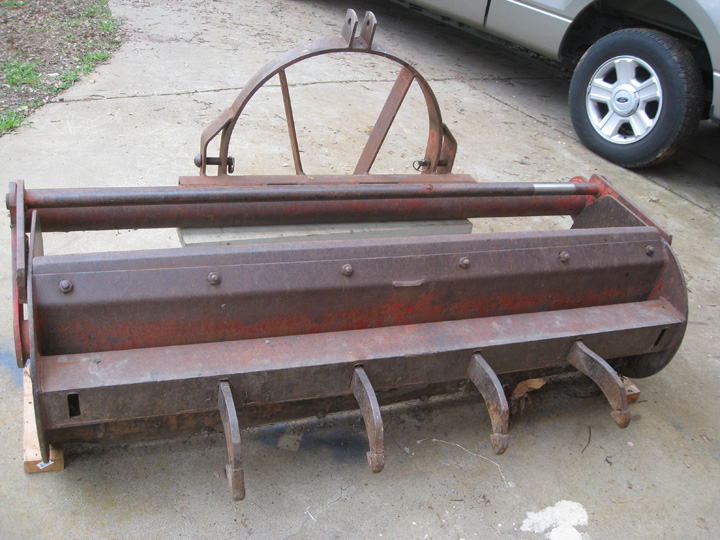

I purchased this ROBB recently for a good price. added the two missing rippers...........still a good buy.
Because it's about 50+ years in age and well used it still performs well.
I don't believe I would buy new as they are pricey. If you can find a used one go for it.
/ Rolling (?) box blade??
#9

$500-$1000 depending on condition, size and age. The newer units have a much better mast on them.
