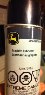

Where does one purchase SPRAY ON GRAPHITE LUBE ??
I buy it at the John Deere Dealership. The company I work for has used it for a long time and it is a pretty good product. I think you can get it at Tractor Supply too but not sure how good it is. You would just have to try them and see. John Deere is pretty close so it's not a problem getting it there for me.
I got mine at the hardware store, in the lube aisle. Be careful though--it makes a slick surface on whatever you spray it on. Overspray or drips are a PITA to clean up. Also, it isn't right for every kind of lubricating situation. IMO, it is best when you are dealing with larger or heavier bearing surfaces, and where more substantial forces are involved. I think you should think of spray-on graphite lube as more like spray-painting a layer of graphite onto a surface, than spraying a liquid lube. If you spray it into finer or lighter mechanisms, it can really gunk it up.

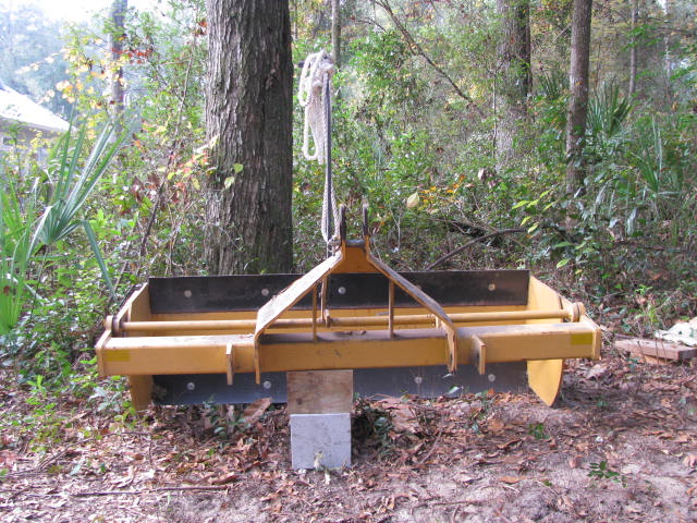

Flattery gets you no where. ;) We have 3 Gannon roll over box blades. All that I do is have a couple of 2x4s or 2x6s about 18"-24" long under the cutting edge and a 4x6 standing on end cut to the proper height to support under the tower. Pretty simple.
I use the same method with my 6' rollover blade, but with the addition of keeping a 5' 2x4 pry bar there to shift the whole blade just a fraction to make the lift arm holes line up.
You are correct on explaining this. It is great stuff to use in the right place. I work in dirt construction and we use it on our motor graders. They have a dry circle and I use it on the circle surfaces and the teeth. Grease makes the dirt accumulate a lot and this stuff just polishes it up. I have a Bush Hog mower and I use it on the arms where it connects to the three point hitch. They are floating and just move up and down about 3 inches (guessing) and it works good there. Grease would just build up with grass clippings and dust.

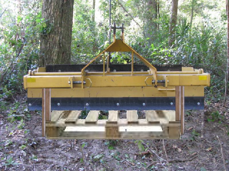

Jeff, I'm a couple years older than you and know the feeling about heavy stuff - here's one possible solution you might consider - replace your blocks, etc, with a standard 4x4 shipping pallet (shimmed underneath as necessary with rocks, blocks, whatever) - back your tractor (with the ROBB on) up to the pallet, lower the BB til the blade contacts the pallet, (here's when you do the shimming) then adjust the vertical boards (shown in my quick/crappy edit) til they contact the square tubing on both sides of the hitch.
Cut the wider, inside boards (pref. 2x6) to length, then use some longer thinner ones outside to mount to the original pallet. This way the 2x's sit ON the pallet and don't rely on nail/screw strength to support the weight. If the pallet sinks afterward, maybe cut some wooden wedges and drive them under the low side as needed. Sooner or later things should stop settling :confused:
Another option, if you weld and are interested, would be getting longer draw pins and adding swing-up "kick stands" to one or both sides. Post back if you're interested, and I'll expound (I'm a bit OCD, so "expounding" comes pretty natural :eek: )

OP AGAIN - THANKS TO ALL WHO CONTRIBUTED TO MY POST​
I have installed and removed my 630 pound Rollover Box Blade numerous times in the last month, utilizing posted suggestions. Amazing....I can now whip it on and off in just a couple of minutes with NO bad words and NO sweat.
Obviously, technique is key and I had not been able to evolve satisfactory technique on my own. Perhaps a case where frustration breeds further frustration.
On my own I discovered it helpful to stake the lift arms, spread at the appropriate width, by tapping a couple of pieces of re-bar into the ground, just short of the implement.
As my other implements go on and come off RELATIVELY easily, I am leaving my recently acquired "Pat's Easy-Change System" in its shipping carton for the present.

radrock, Post #17 Use spray graphite. Yes, graphite is really helpful on the draw pins; superior to grease in this application. Here I have to insert two 3/4" (6/8") draw pins into their corresponding 7/8" holes on the 630 pound box blade. Tight fit, beaucoup inertia. As I have it, I used a small spray can of household lock lubricant. With second application the pins slid in/out much easier.
NAPA Auto Parts Stores sell graphite in spray cans, both wet application and dry application. Multiple types of graphite lubricant are available from amazon.com.
