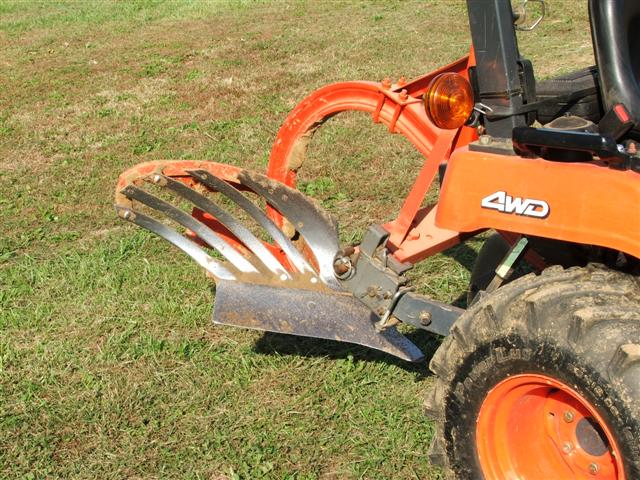

Country boy just has to plow, nothing else to take the place of the smell of fresh turned ground.
