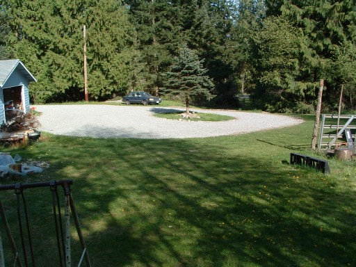

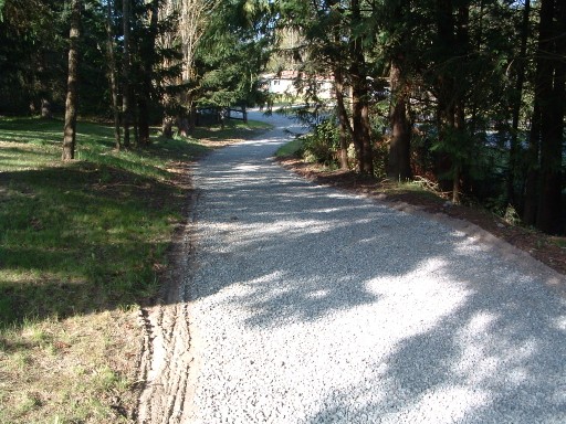

Nice work Ron
After seeing your build I decided to make my own based on your design. I wanted to say thanks for the idea and doing some of the RnD.
I had all the steel I needed left over form other jobs and scrap I ve collected. I think that mine is heaver than the one you built, based on the thickness of the channel and box tub. witch helps keep from skipping over rocks.
The grader works well, after two passes it looks like I had top dressed the drive way with new gravel. All the weeds and grass has been ripped out roots and all. The bumps and wash bored are gone.
I'm planning to make some changes. The blade needs to be moved back because it sometimes get clogged with grass and weeds. I'm going to add a set of (4) tins that I can adjustable the height on the front cross bar. With the tins down I'll be able to us the grader to brake up and loosen deeper into the road base and our riding arena. I think they will give me more versatility, like a box scraper.
Thanks again for the idea
Stephen
hope the photos come out
